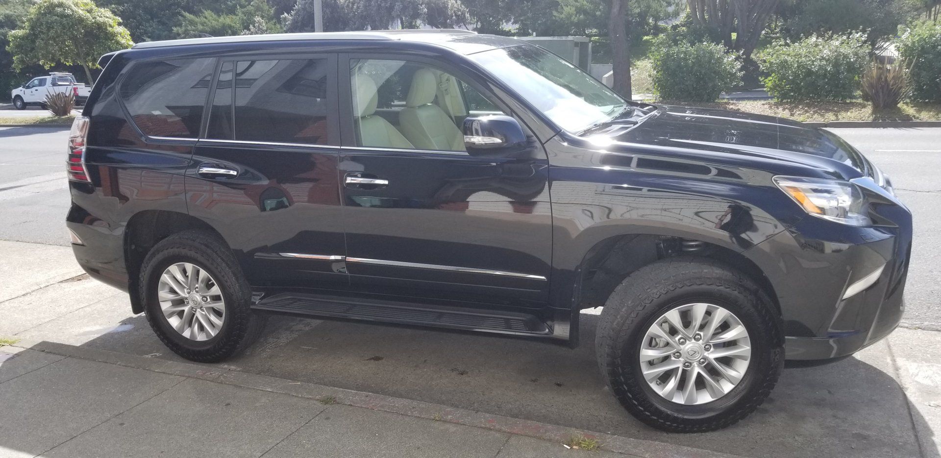

Happy new owner of a 2017 GX 460. Got it through Carvana, which was weird but worked out. ("Long time lurker" etc. etc.!)
First I'll start with some new rig porn:
This came with what appears to be a 2-2.5" lift, which is my guess just from eyeballing pictures (hard for me to tell, and I don't know where to measure exactly to find out). It also came with what appears to be "Mazama Open Range" A/T 265 70r18 tires on stock wheels. Some googling indicates they are the same as these Les Schwab tires. Carvana was totally useless in letting me know any of this before it showed up; all I could tell before it showed up was it was clearly lifted versus the rest of their inventory, and did not have stock tires on it. I spent way too many hours trying to squint at their blurry pictures to figure all of this out but ultimately I had to wait until it arrived to see it exactly, which was excruciating. When it arrived, before I even drove it I wanted to check the UCA's for rubbing and sure enough there is some:
I can feel it rub (there is a light vibration) when I am at full lock parallel parking, other than that though there is no rub anywhere else.

Here's a better angle:
