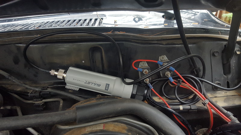

Ever look for Wifi and have to sit in the parking lot or quite close to the building offering it....if you can find it? During our Labrador tour this summer we had this issue and spent more time trying to find decent signals to get email.

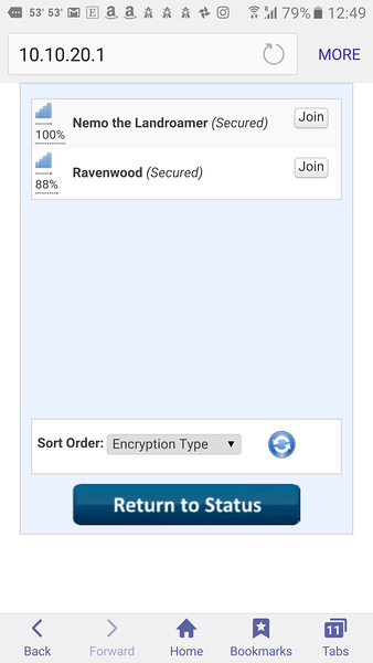

So...I adapted a marine wifi repeater to Nemo. I simply hit a switch, wait 20-30 sec for it to initialize and then go into the admin screen on the phone and pickup any wi-fi that's line of site up to ten miles away....though the line of sight thing is rather important. :)

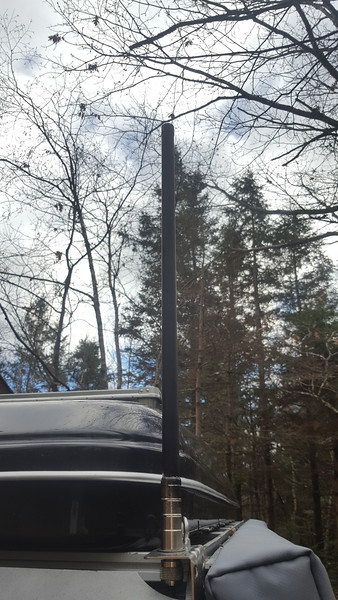

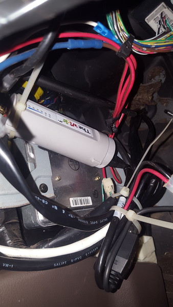

Admin screen, ridged antenna...kind of annoying for major offroad, Router, and booster.
Still need to tidy up and mount stronger but works great. Apparently I can add on a 3g/4G LTE booster as well...but don't see a need for the additional cost/complexity.

Yup...that big omni antenna on the roof sniffs out weak signals, boosts them and feeds them to the router under my dash which then exmits to my devices. Thus needing to be around a wifi signal.....that being said...within 10 miles line of sight. Now if I had a Yagi on there maybe I could double that...lol
