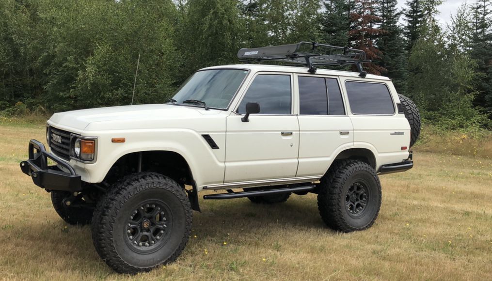

For some reason, it doesn't look as high in pictures as it does in real life. Anyway, this is how mine sits now with the spare on back. I tested it and even with another 200+ pounds in back it will only go down another half inch maybe. Mine measures 9 inches front and 9 inches back from top of tire to wheel well.

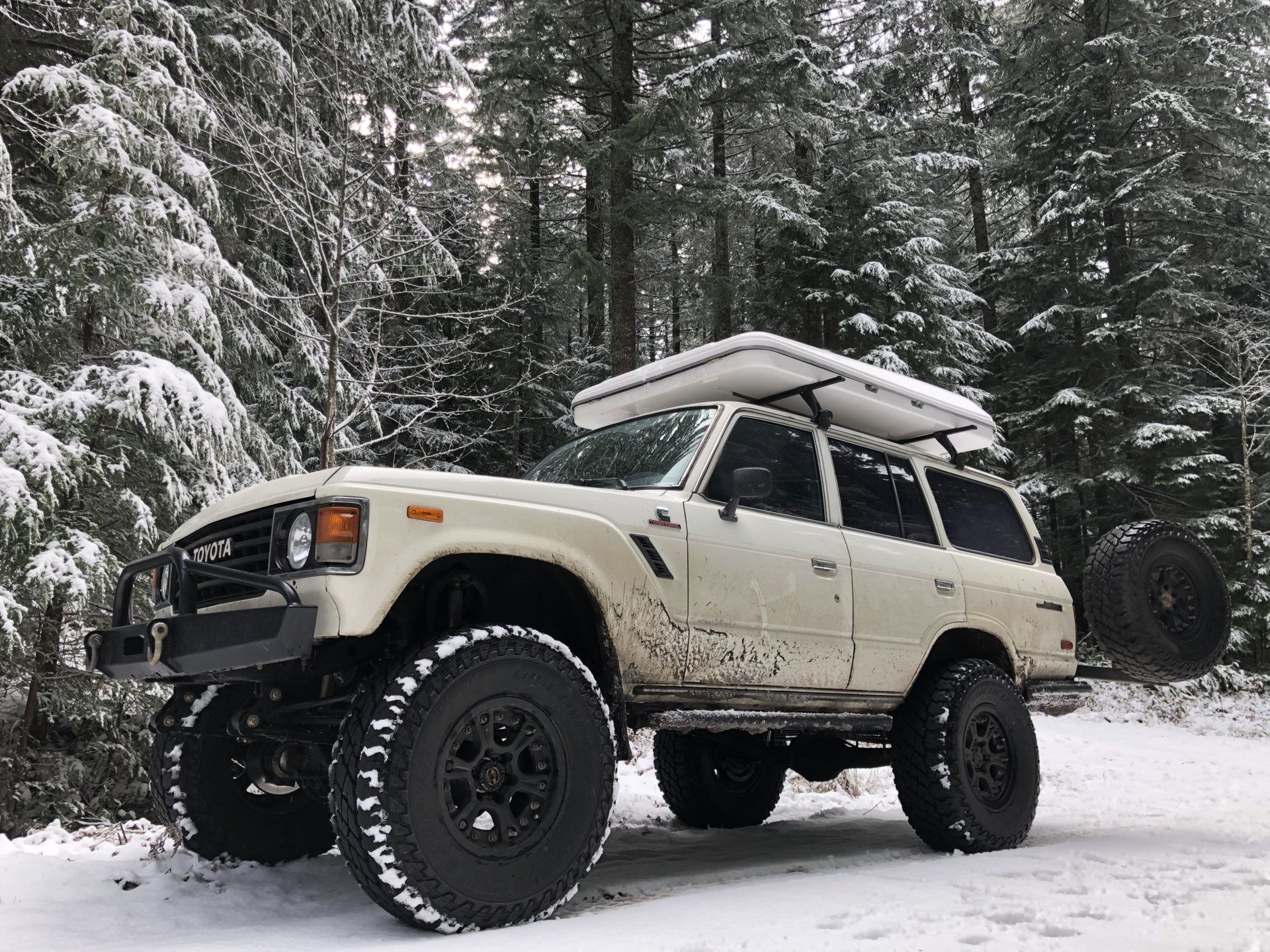

Heres mine with gear in the back. Im about 3k miles away from it for the next 3 months so I can't measure it.
I am running OEM springs with an add a leaf overload spring in front and rear packs. Full internal roll cage and weighs in at 7k lbs on a Cat scale ticket.

This looks very nice! It looks like your front is about my height but your rear is lower. I think that is the difference. When I get mine out on the road it looks like a stink bug and I think that is what I don't like. So maybe I just need to work on lowering the rear a bit. Thank you!

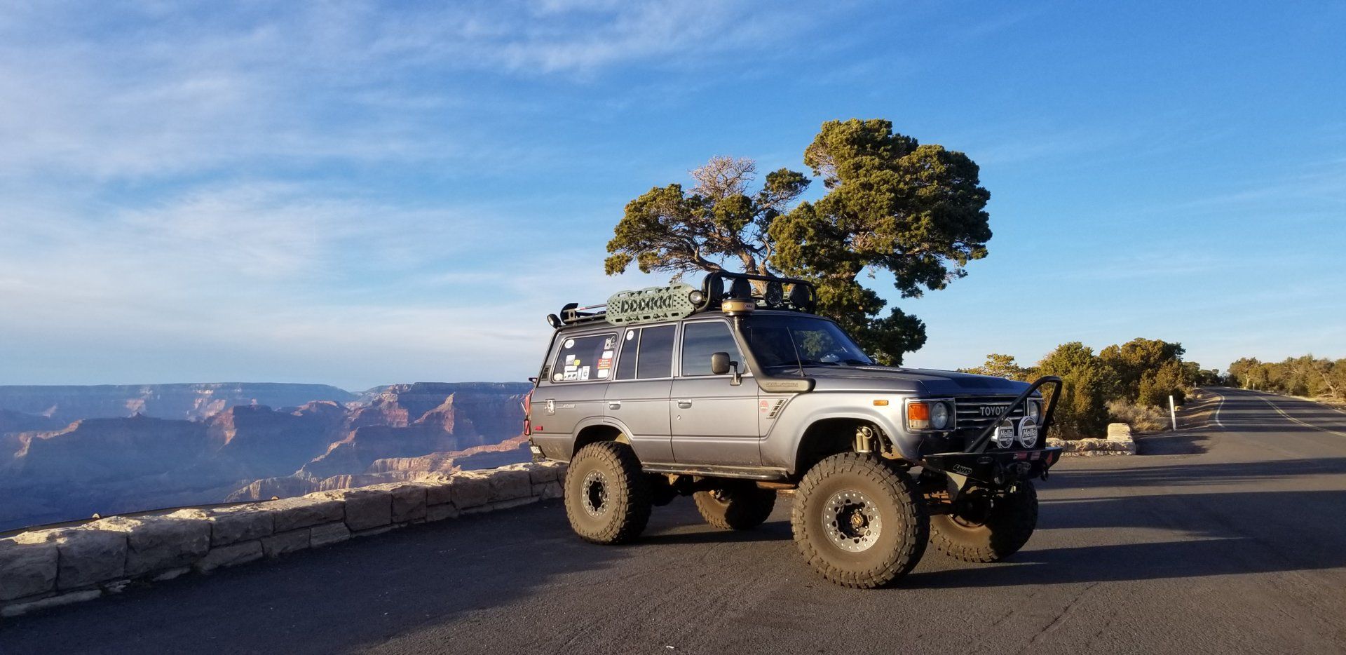

Heres two better side shots for you unloaded and then one with minimal gear

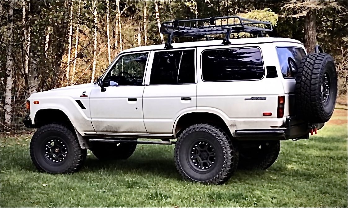

I thought I’d try a comparison. I don’t have any pic from the same angle. Beautiful 60
Looks like my 60
