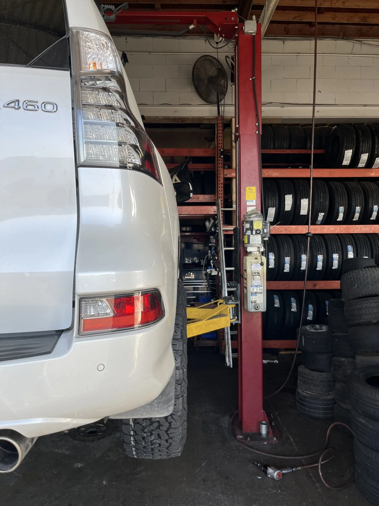

I'm gearing up to finally pull the trigger on a lift and don't want to ruin the Lexus. So I will be going 2 inch Dobinsons IMS or MRA and installing front UCAs and a panhard correction kit at the same time.
I have bp-51s on my Tacoma and Ironman fcp on the GX… you can’t really go wrong with either. The bp-51s are adjustable, so you can really dial them in and change the compression and rebound based on your load out.
I have 265/70/17 on a 17x7 4 mm offset wheel on the GX and the side profile sits flush with the fenders… Tacoma has 285/70/17 on a 17x8 0 mm offset and there us a slight “poke” on the side profile. I’m thinking the GX would be the similar.
I have plans to replicate the Tacoma wheel and tire set up on the GX once I figure out which 33” spare tire carrier option I want to go with.
