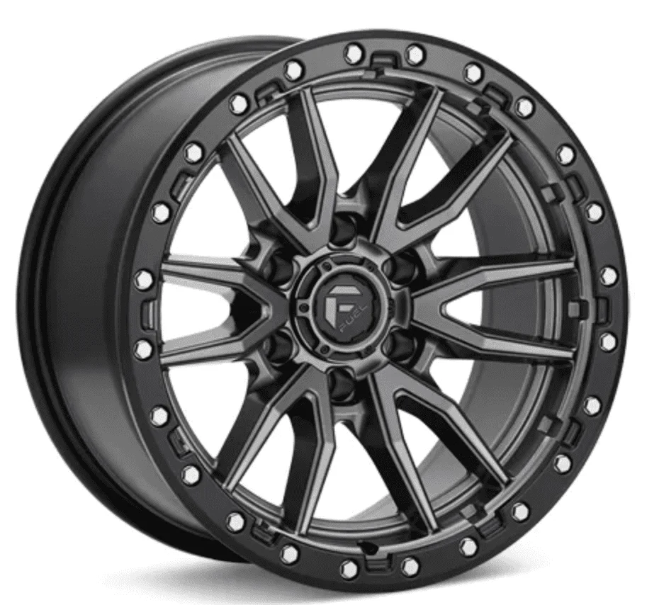

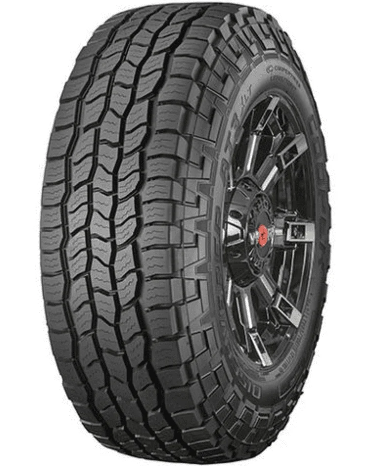

Thank you for the suggestion. Looking for something that rides good on highway/street for commuting. The only off-roading the truck will ever see are light trail rides and very rarely at that so more concerned with keeping a comfy ride quality while getting the desired look. Im leaning heavily towards these 20x9 Anthracite Fuel wheels with a Cooper A/T tire for less road noise bc I usually cruise about 80 mph during highway driving (yes my MPG sucks usually 15mpg)
Just my 2 cents worth, love the rim style and color, but consider a 17" wheel.
Reasons:
Most affordable tires will be in the 17" range.
  • If you're looking for comfort, a taller side wall will give a lot more cushion in your ride than a low profile tire, assuming you don't go with a LT (light truck) tire.
  • If you're ever off roading, and you air down, you're more likely to pinch the side wall of a lower profile tire than a tire with a lot of side wall.
  • If you're ever in the middle of nowhere and you should shred a tire, you'll most likely to find a 17" tire your size than a 20".
  • Also look at the Builds thread: 150-Series Toyotas
One other point, consider the size tires you get so you can still fit a 5th tire in the stock spare location if you don't plan on doing a swing-out bumpers.
You may want to consider the weight factor of the wheels. Most of the wheels I found are 30+ pounds but the SCS wheels come in at 24.5 lbs.
