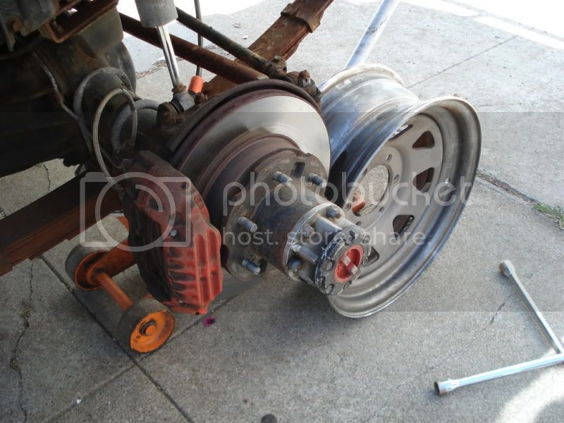

great job, brakes look super clean :D
I'm running fj60 rotors w/LARGE 4runner calipers and wagon wheels:
It's close, but don't need to run a spacer
I believe I'm also running the MT studs...I know there doorman.
