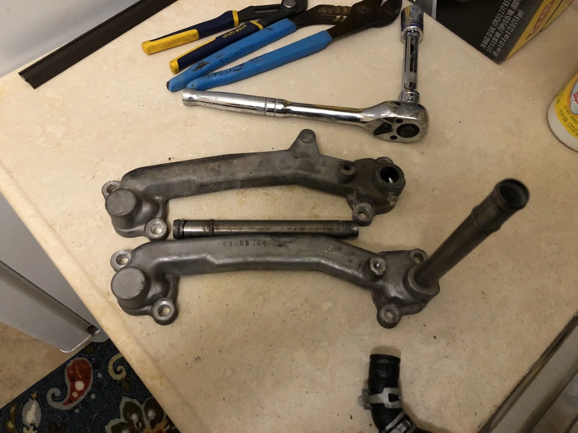

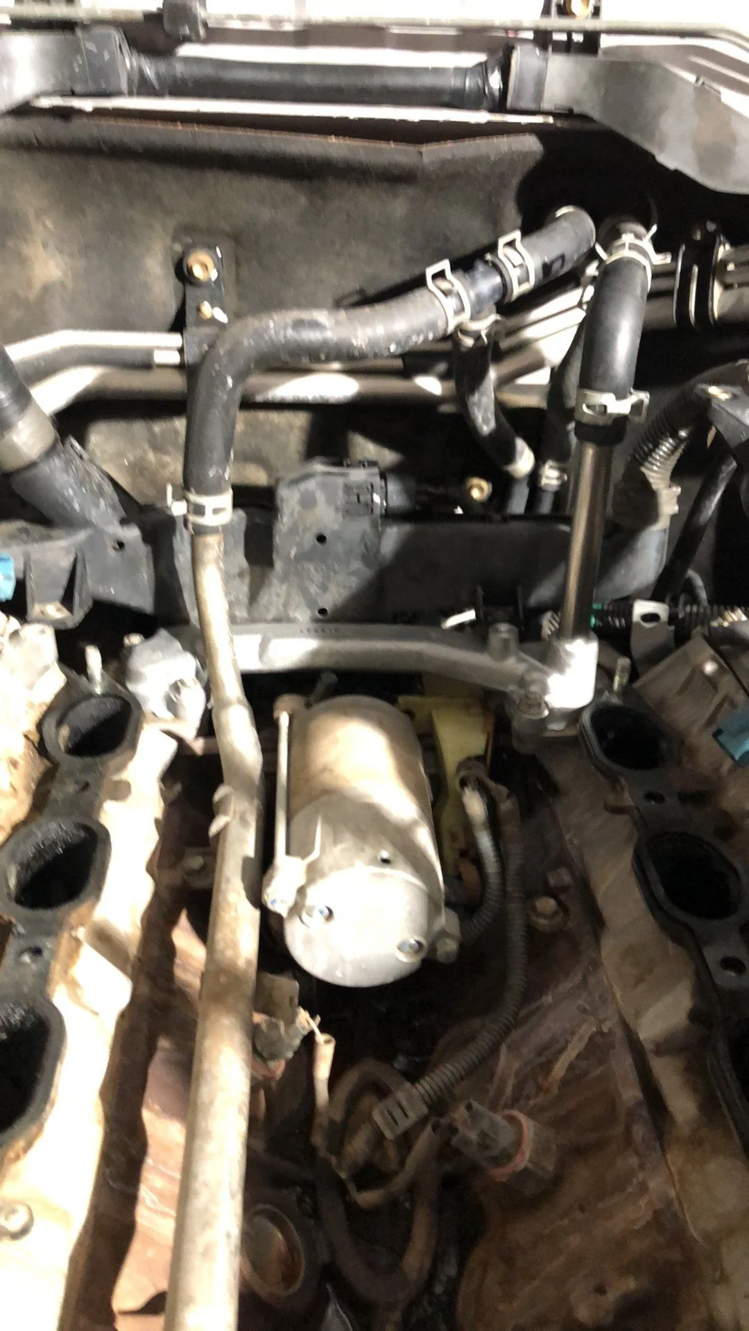

You can shine a light down to your rear bypass, you will see it leaking with engine running if that is it. Here is a picture from when I replaced mine. You can see that vertical metal tube that is pressed into that cast piece. It will leak right at that press fitting. These often get damaged when the T’s get replaced because people are a little rough with them. I don’t think this is it, it’s usually a significant leak, but very very easy to shine a flashlight and check.
Do you happen to have the part numbers for the coolant cross over pipe and any gaskets if any? Looks like the perfect item to replace when my starter breathes it's last breathe!
You are correct. If you do one of them do the other. You will also need the gaskets that go with it, I will look up the p/n. They are very very cheap. Sometimes the rubber portion of the gasket dries onto the block where the bypass sits. You need to scrape the excess and get new gaskets to prevent further leaking,
Coolant bypass:
16356-50120
