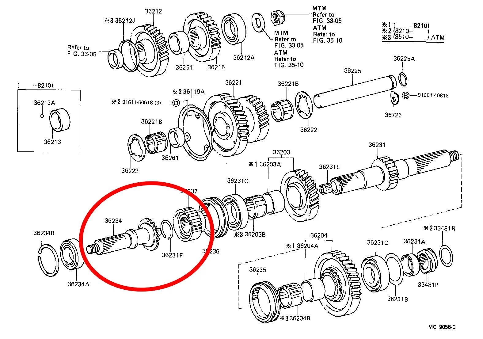

There's a good chance that the front drive engagement teeth inside the transfer have rounded off their normally square edges. If the teeth get rounded enough, they can't maintain a grip and the gear pops out.
Remedy: replace the transfer front output shaft and transfer front hub clutch (official name).
