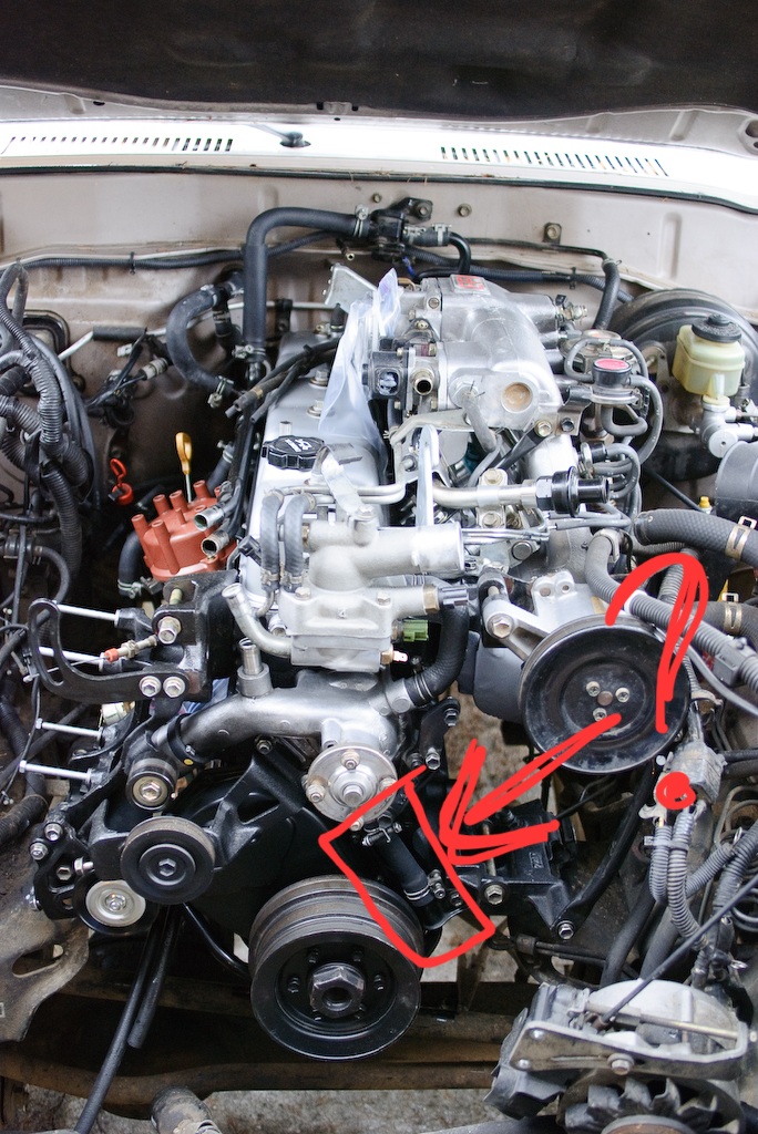

Good day fellow cruiser family,
I need help identifying the lower water pump hose to replace it. I can't find it on Google. Any help is greatly appreciated. This is for a 1991 fj80 with a 3fe engine.
-Randall Alonso Gutierrez

you have a production date change here ,
BUT ,
this IS a straight hose if TOYOTA DISC> / NLA ?
call out # 15777
part # 99556-30210
or
part # 90445-24039
- Needed Clamps are part #
15777D
CLAMP OR CLIP, HOSE(FOR OIL COOLER HOSE)
91621-40812
** Std Part​
90461-10696
** Std Part​
90480-20018
Parts list​
No.​
Spare part code​
Part Name​
date of manufacture​
Description
15777​
99556-30210
HOSE, OIL COOLER​
01/1990-02/1990​
3FE..FJ80
*H,L=210,PIPE TO WATER PUMP
15777​
99556-30210
HOSE, OIL COOLER
01/1990-08/1992​
3FE..FJ80
*H,L=210,PIPE TO OIL COOLER
15777
90445-24039
HOSE, OIL COOLER​
02/1990-08/1992​
3FE..FJ80
*H,L=105,PIPE TO WATER PUMP

hello , Randall Alonso Gutierrez :)
- you should be able to got to your local toyota dealer and purchase qty x 2 part # 96112-10250 clamps , and use HIGH quality 5/8" heater hose from NAPA , get there
PREMIUN hose / cost the most money , you ONLY need 1" feet , should have a STRIPE on the side like yellow or green ........
- is the METAL PIPE where hose goes 5/8" inch or 16mm OD ?
