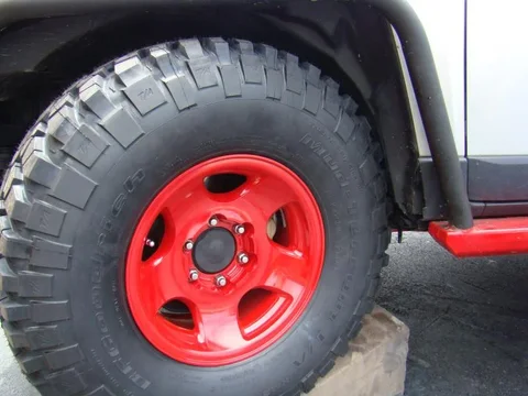

This is what mine looked like before removing all the plastic inside the front wheel wells. I eventually removed that inner section that is held in place with plastic rivets and a few screws. Then with the wheel removed, pounded against the well area (floorboard) that showed signs of rubbing (rubber material worn off, exposing bare sheet metal).
