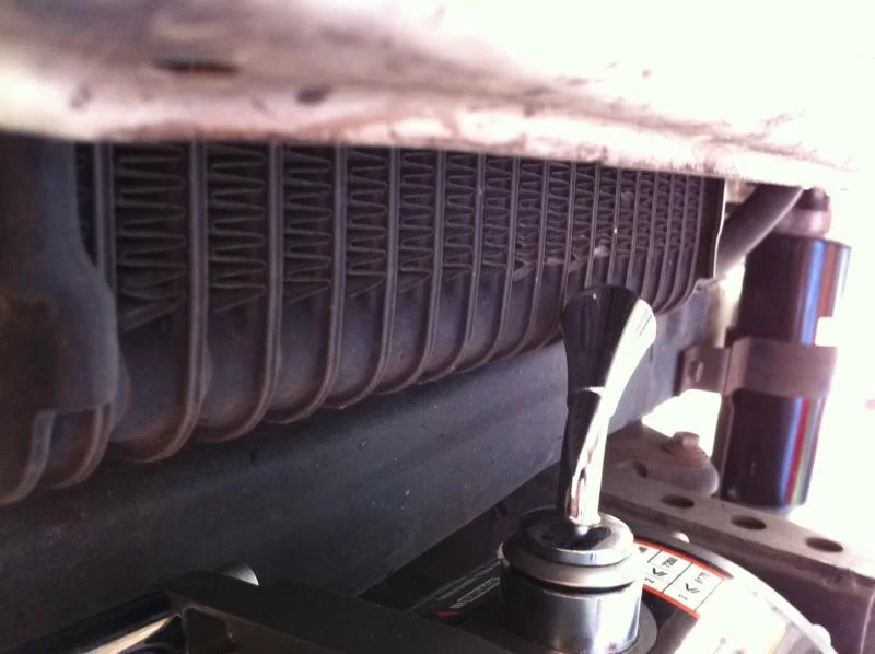

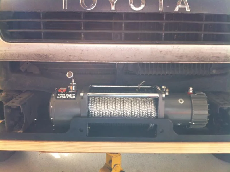

I have the Badlands 9000# winch, and I have the Harbor Freight channel mount bracket. After cutting the first part out to test fit with the winch, I discovered that the clutch knob is going to be a problem, at it hits the tranny radiator. :doh:
Here are some pics to help describe the issue - photo1 shows the assembly, photo 2 shows how the clutch knob is hitting the radiator. It's supposed to rotate 180 deg, but is probably only making about 120' until hitting the radiator.
I've thought about making my own clutch knob, and maybe mounting the winch upside down... but I don't like the idea of exposing it to the elements like that, especially when it's going to be the first thing to test ground clearance.
And I can't rotate the clutch knob... already took it out to check to see if that was a possibility.
Any bright ideas out there? I'd appreciate it :)

can you rotate the housing with that winch?
I know on a warn you can
This is no Warn! So no unfortunately. I think my best choice is to heat that thing up until it glows and bend it a bit. I might move the radiator as well... Looking at red redrilling the brackets now as well.
That's a thought... I probably could grind the heck out of it as well. I'd be even more inclined to do so if I can buy a replacement!

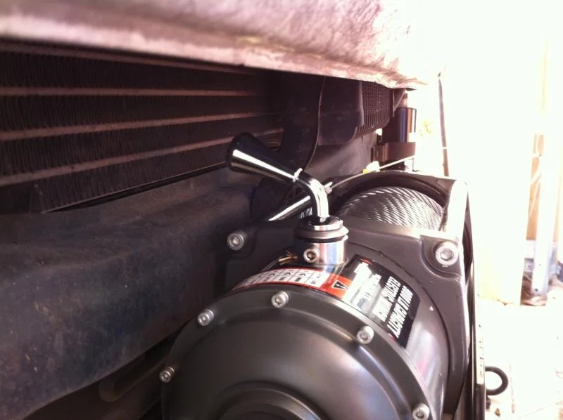

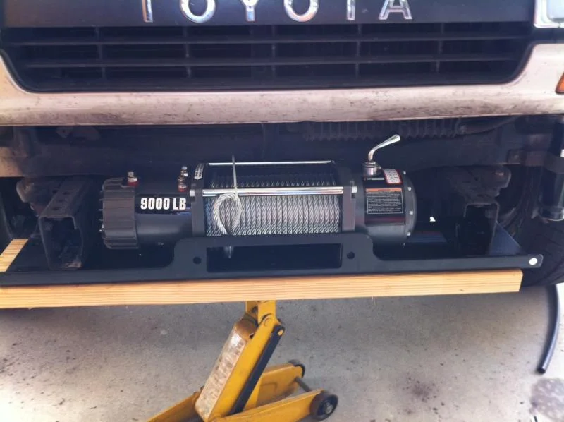

I just had another thought handed to me... turn it around!
I'd have to rewire it so the forward and reverse go to the 'wrong' leads, and I'd have to unwind the lead and put it back, but as you can see from these pictures, it would fit in there just fine...

Don't know that I would try that without a lot of checking first. Since they are only built to pull one direction and manual even says "DO not run in reverse - use free spooling" because of the braking system.

Making it function as you show won't work. You'd have to address the braking mechanism.

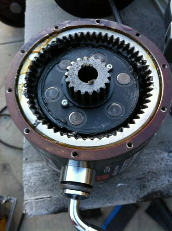

Thanks. I just took the gear end cap off to get a look, and I'm glad you posted that information...
FYI here's the gear side with the cap off.
Ok. I don't think this is going to work. I rotated the housing but it has no effect on the clutch handle position. If you look at #14 on the assembly diagram, note the groove is the same all the way around the drum. I assume in other winches this is cut at some kind of pattern that allows the clutch handle to change position.

I don't have the same instructions/diagram so can't see diagram #14. but leave the clutch in free wheel position. Then you want to rotate the cover that was held on by the ten little screes one screw position counter clockwise. Just slightly tighten a couple of the screws then hold it back up by your winch and you should see how the clutch handle is moving.
hope this makes sense.
Or maybe this will help.
The clutch handle itself is not going to move, it stays the same. It is that whole outside gear casing, handle and all that you rotate. IF you look at it from the side the handle comes "stock" in the twelve o'clock position on the winch. When you rotate the gear casing the handle will move to the 10 o'clock position. When you get it where you want it, just put the ten little screws back in.
Oooh, I think I know what you're saying now.... let me give that a shot and see where it gets me.
