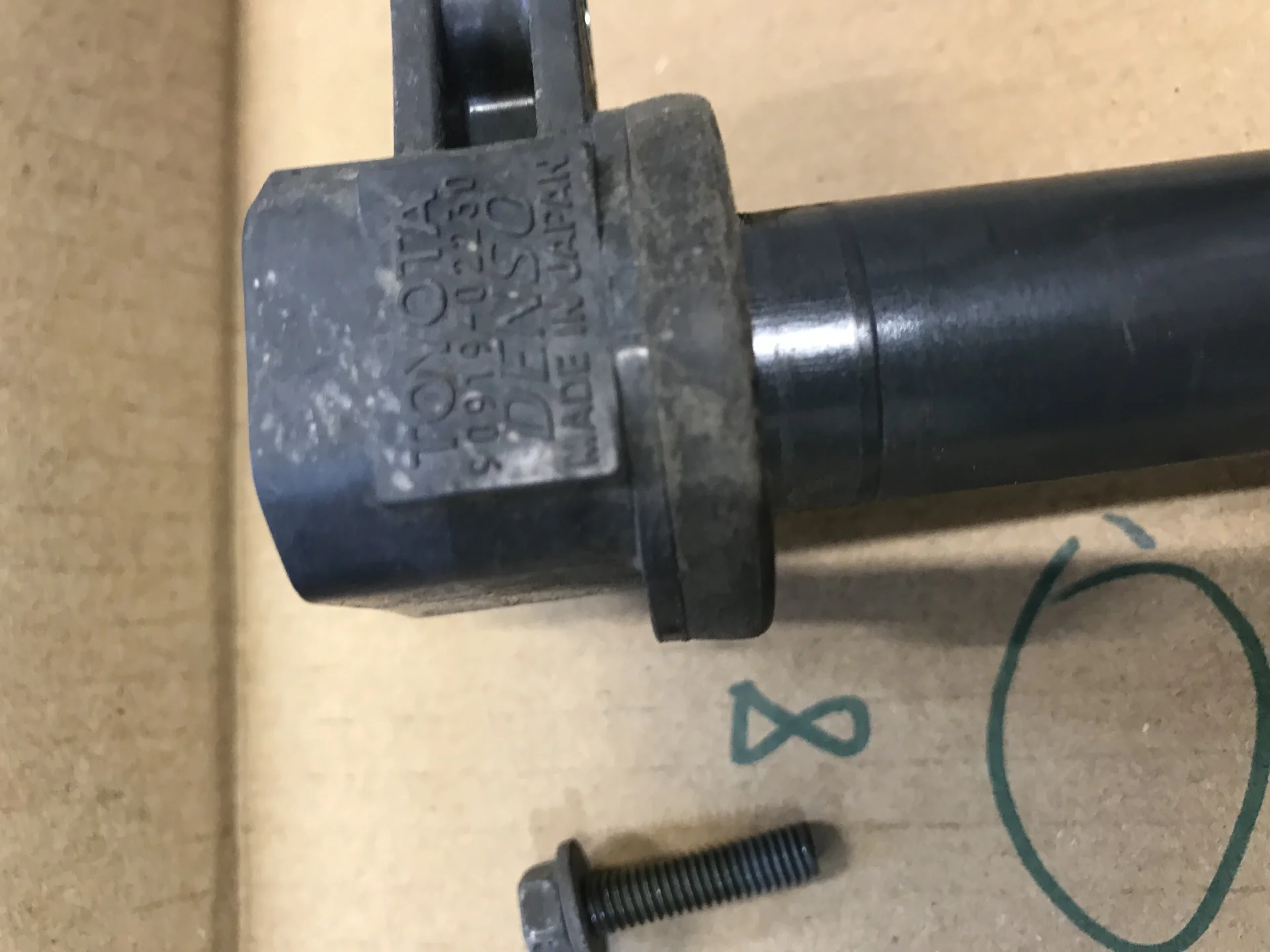

Had my LC approx 1 year now - recently diagnosed bad coil on cyl #8 - pulled it out and it is stamped as Denso 90919-02230.

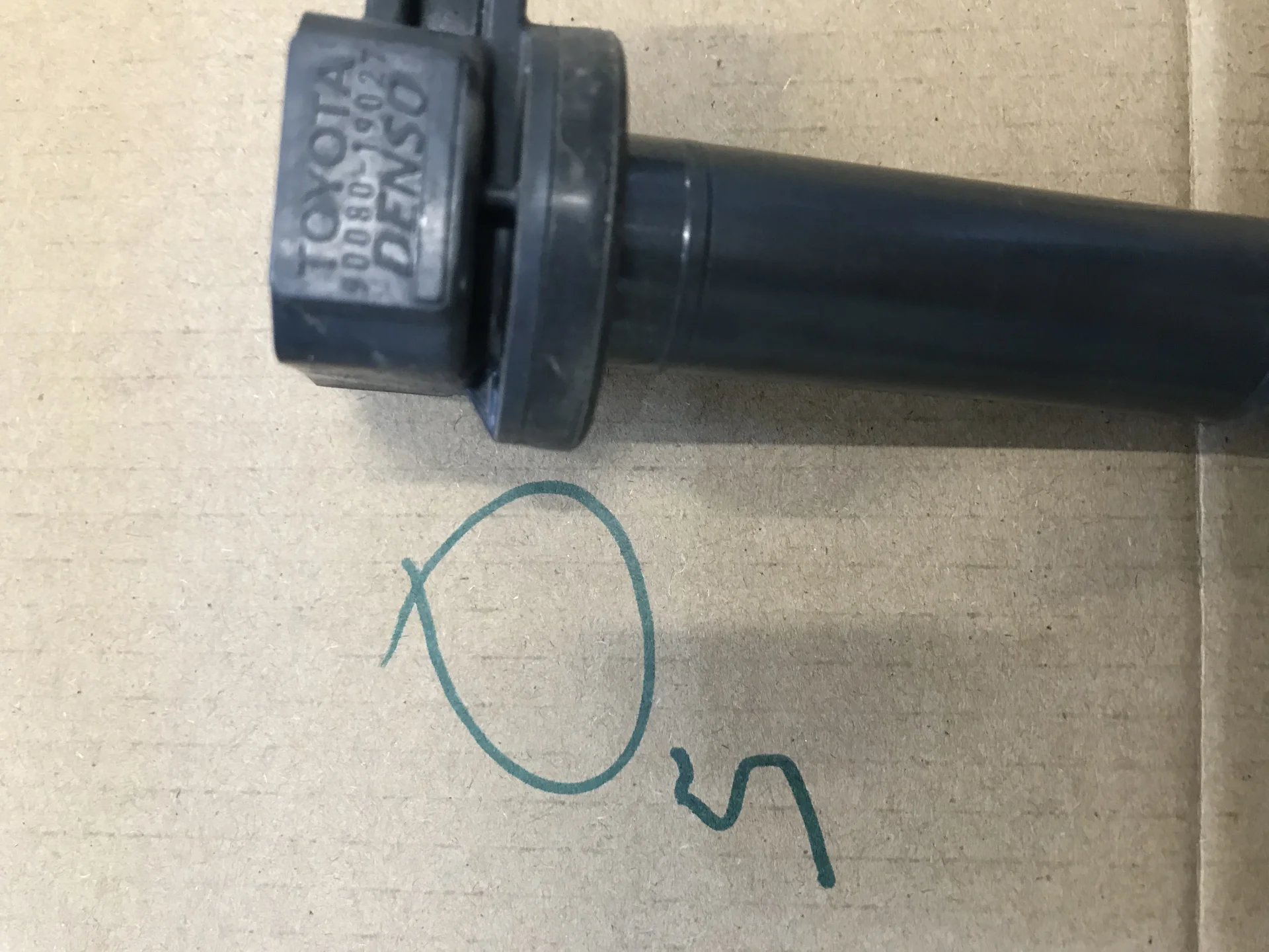

All the other coils are identified as Denso 90080-19027. Suspect that #8 had a replacement unit in it (from the previous owner) and it was a counterfeit unit.

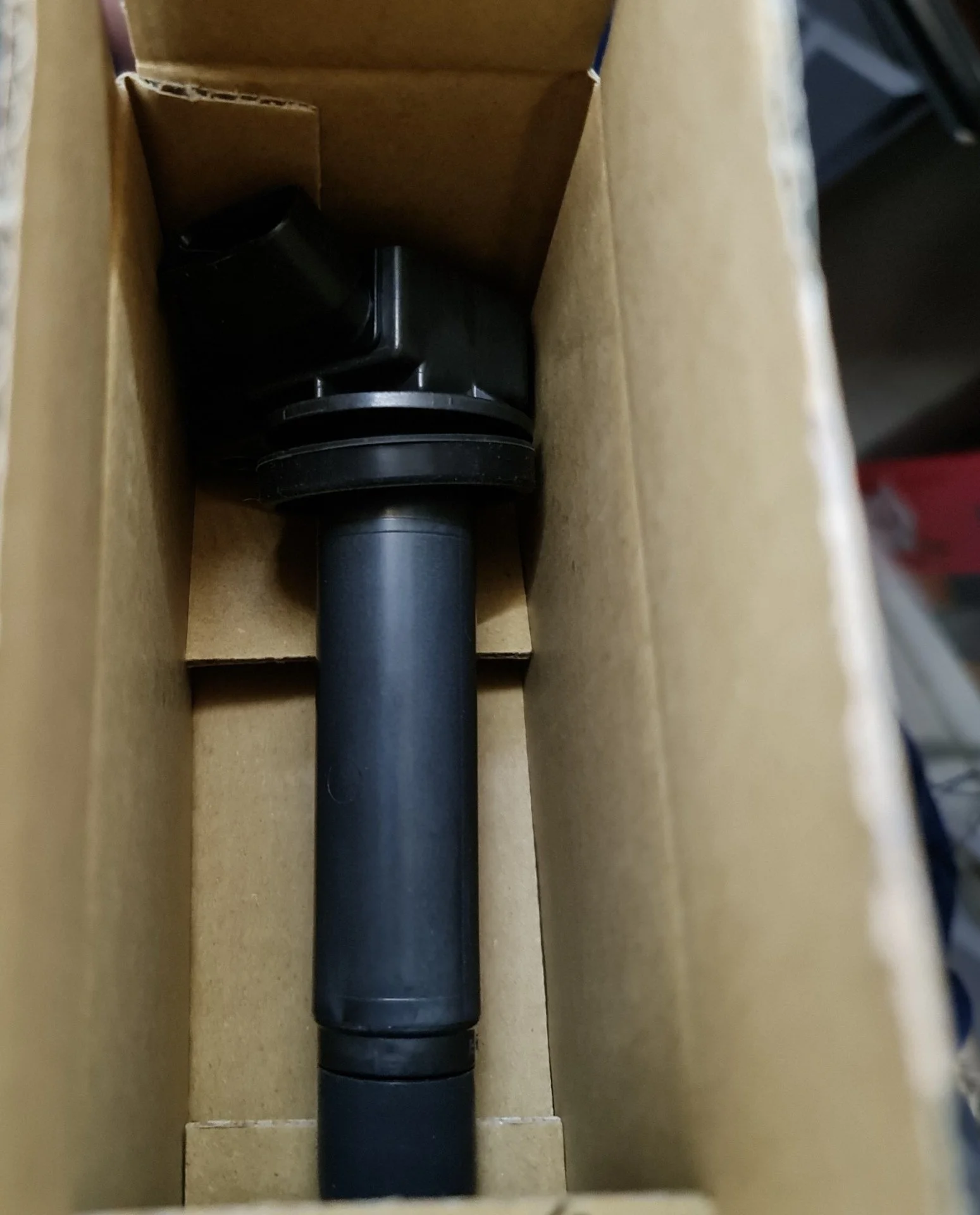

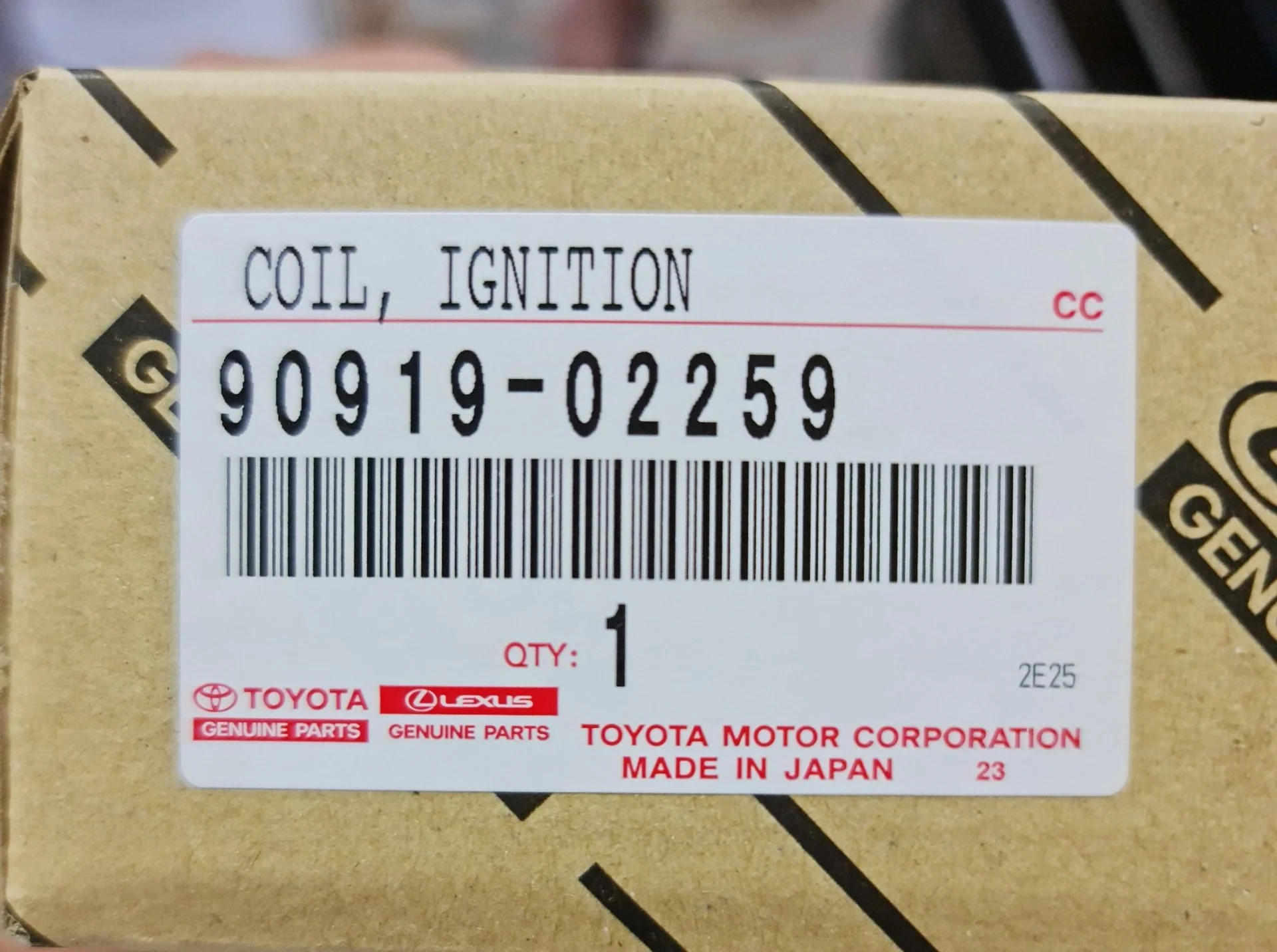

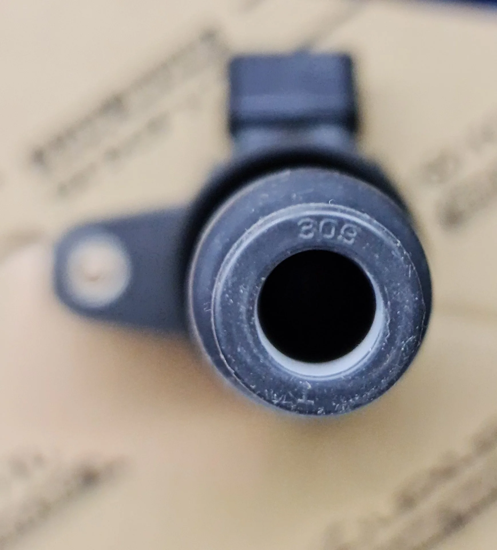

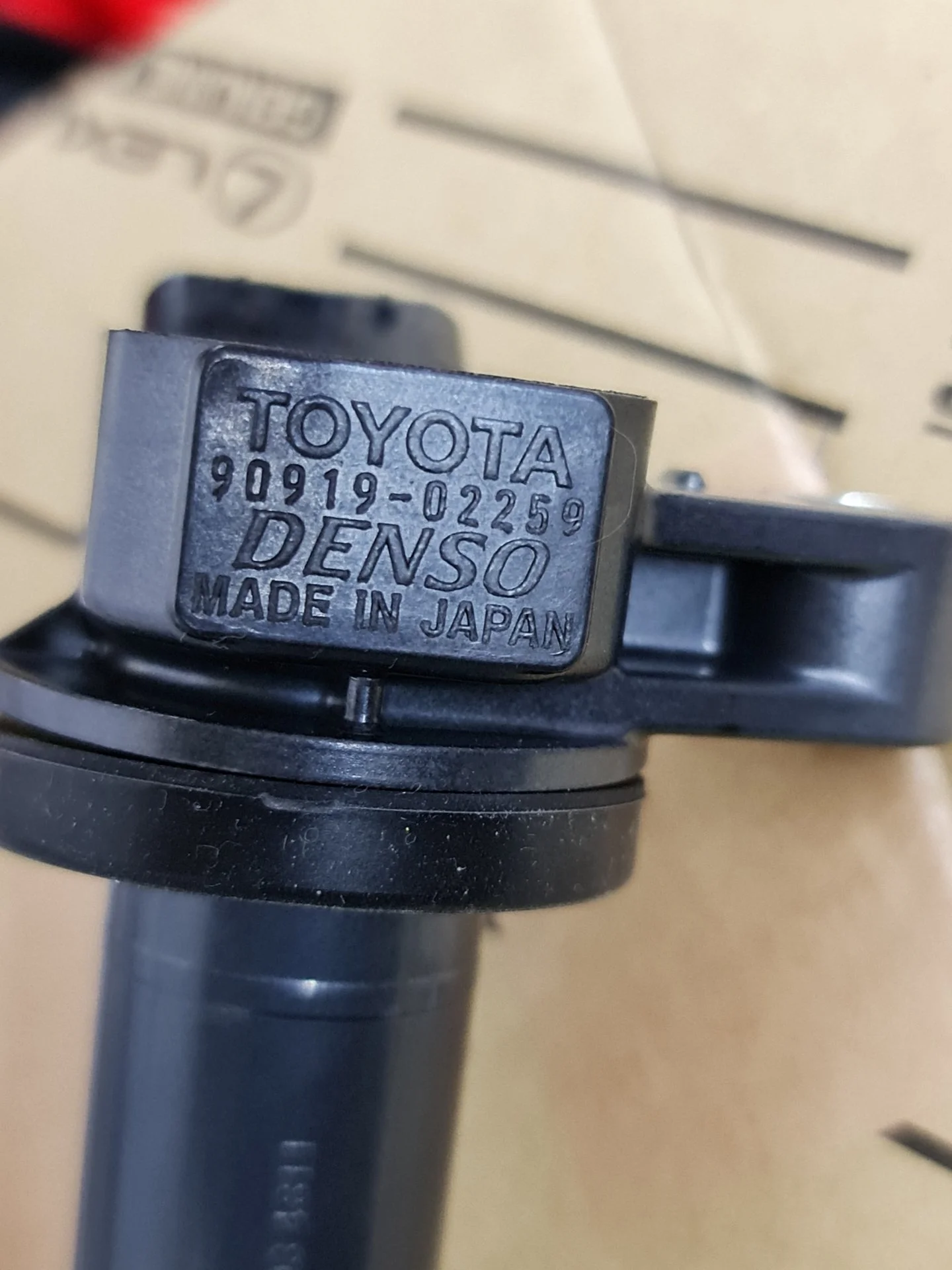

In the meantime, I bought 2 "genuine" Toyota Denso coil from an authorized dealer. Attached all the photos. These came in brown box without any plastic in them. Has no flares at the bottom. I will compare them to the ones I have on my LX470 but I don't know if those are genuine.
