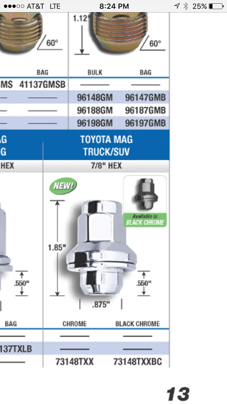

Gorilla auto 7/8 are OE fitment Black chrome is what you want.
Perfect. I am using OE Wheels, had them powdercoated. The ones that didn't fit came from Gorilla, will just do an exchange. Exactly the answer I needed.
