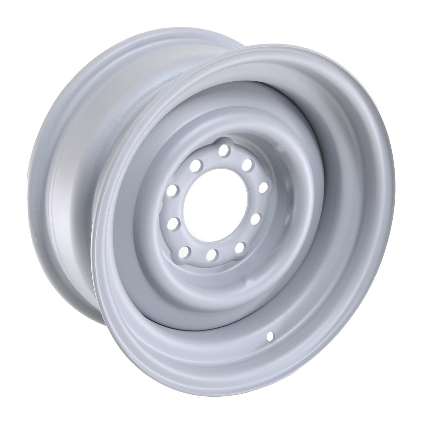

No idea what a TC3 trailer is, but if I were to guess at the wheel I'd say that it is a 5x5.5" bolt pattern. Those should be pretty easy to find since most Jeeps, all Scout's, all Early Broncos, and most Samurai's use that bolt pattern. If I'm correct in my guess then you should be able to buy that wheel fairly easily.
Likely that a new non OE type wheel will be less $$ than the OE type that you have unless found used somewhere. Something like these for $56 each new:
