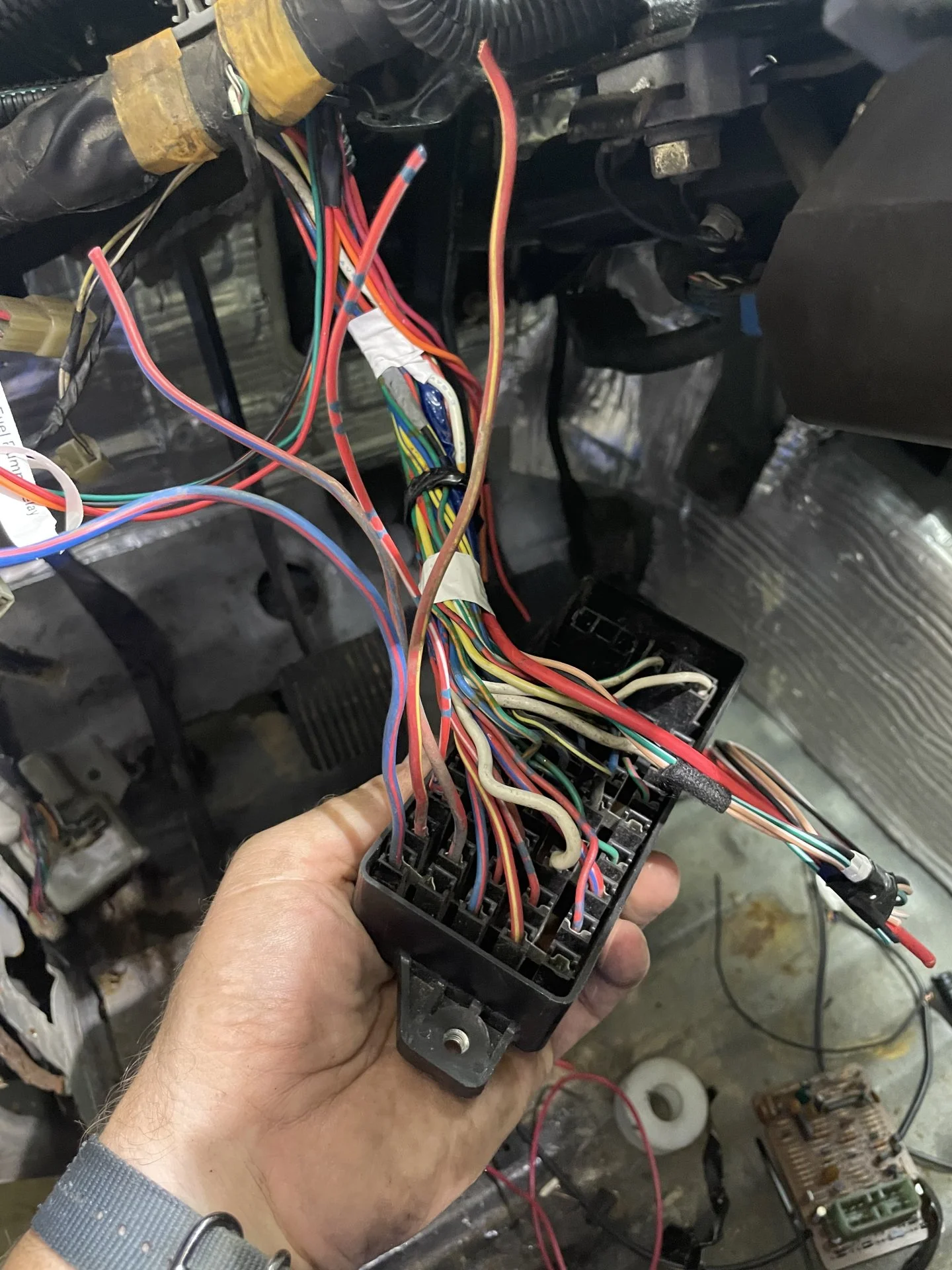

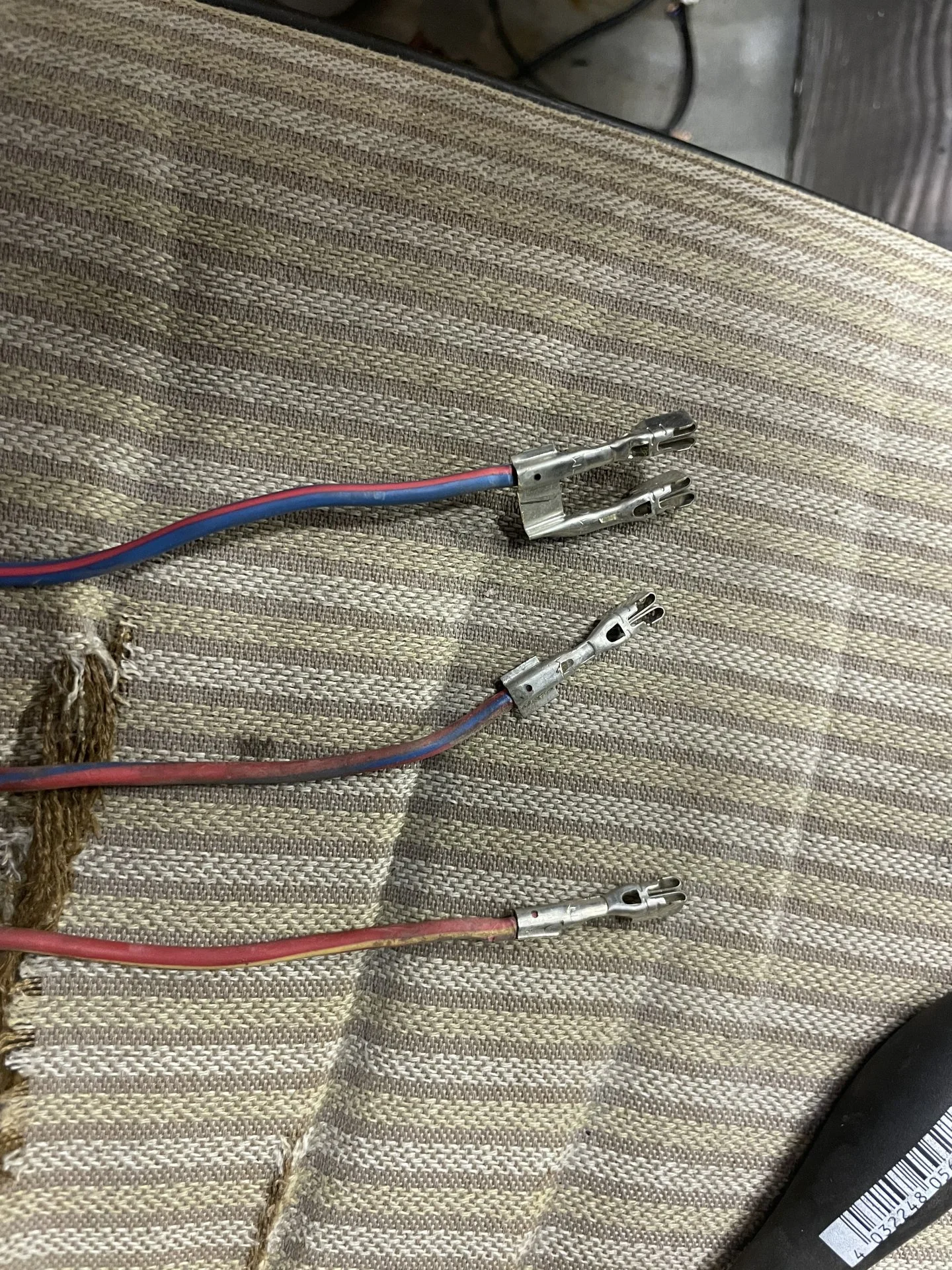

Prepping the 60 fuse box for EFI. I don’t like the idea of have random inline fuses powering things. For future simplicity and a favor to anyone that may work on the truck in the future, I like the idea of having all the fuses in one location. Removed a few pins from a spare 60 fuse box and added them to open spots on my 60 fuse box.
With the dash back in, it will look completely stock.

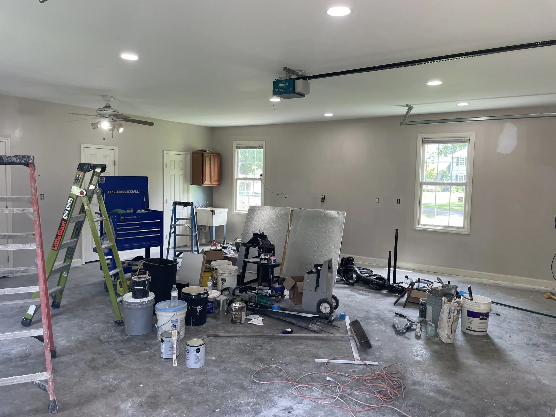

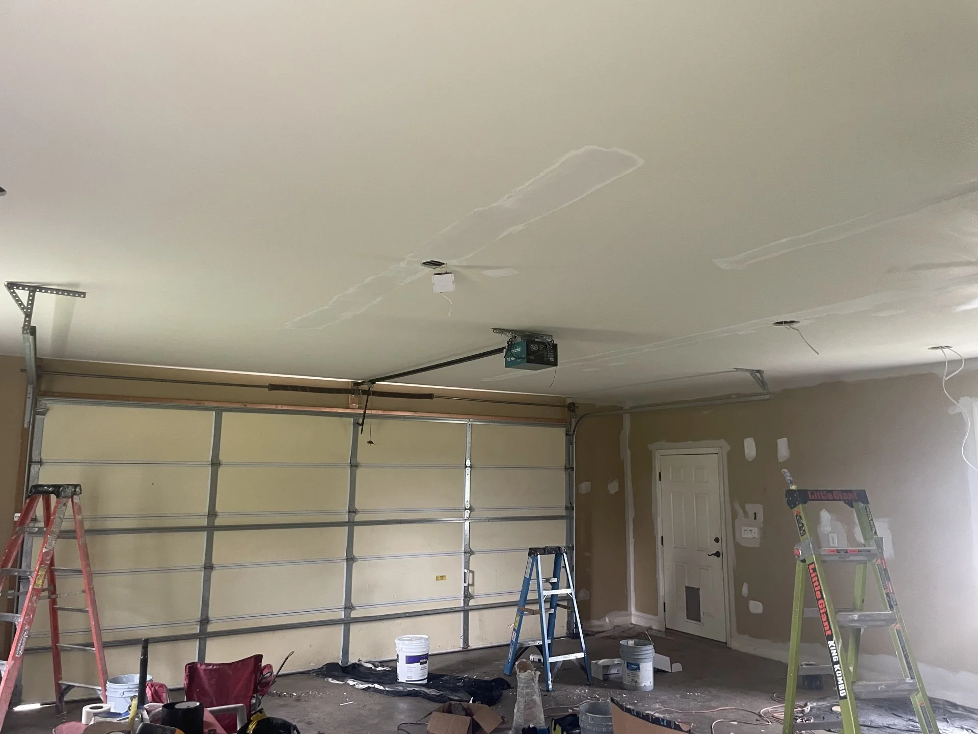

Put Jack on pause this week. We’re hosting a birthday party in two weeks with a inflatable water slide. I convinced my better half to have it in the garage. Wet kids wouldn’t be running inside and out of the house and the adults could stay cool in the a/c. This gave me permission to spend some money out there. I took the old ballast lights out and added 8 low profile leds. Its going to make it so much easier to work and see what I’m doing. The old brown paint made it feel like a cave.

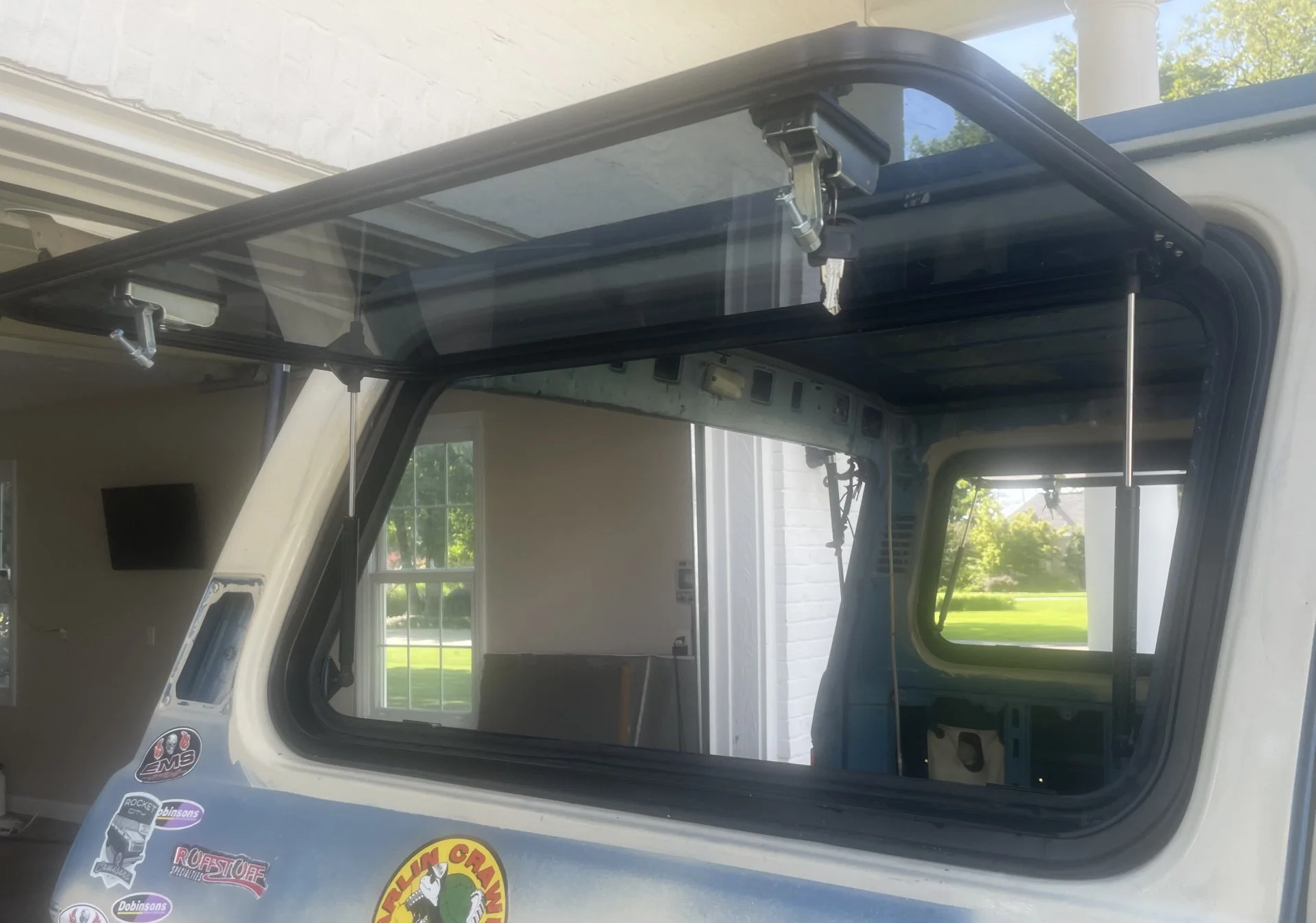

On to the back windows. I had a set of Flip up windows that I had ordered out of the Brisbane, Australia. The old window frame was in great shape so minimal prepping was done. Forgot to take pictures, but I used 80 grit, filler primer and brushed inside/outside with some left over paint from the firewall. Installation took about half the time of prepping. Fit and finish was spot on and it came with tinted windows. From this point forward they will be referred to a my beverage access portals. Seems appropriate considering how “Jack” came to be.

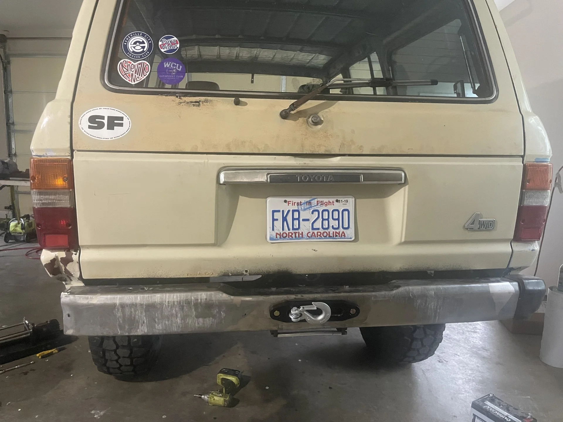

The rear hatch and tailgate is going together. I pulled the original 86hatch out of storage and reinstalled it with some new shiny hardware. I swear it makes Jack drive better. It still has the original hardware, glass and sweet Asheville stickers. I can run it while I prep the 83 hatch for paint.

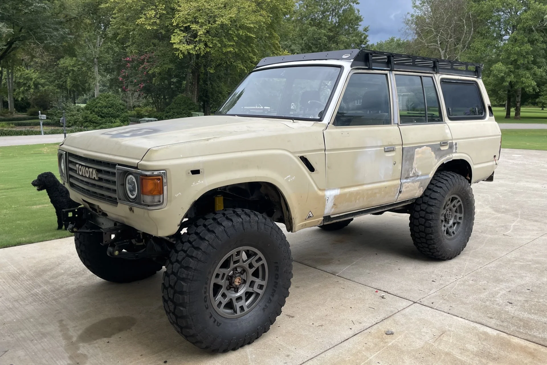

Glass is going in tomorrow. Stripped the roof and cleaned the rain gutters down to the spot welds. Welded up a few small spots and seem sealer around the gutters.
Pulled it out in the field and sprayed the roof. Bowfin rack will cover it so the few imperfections aren’t on my radar currently.

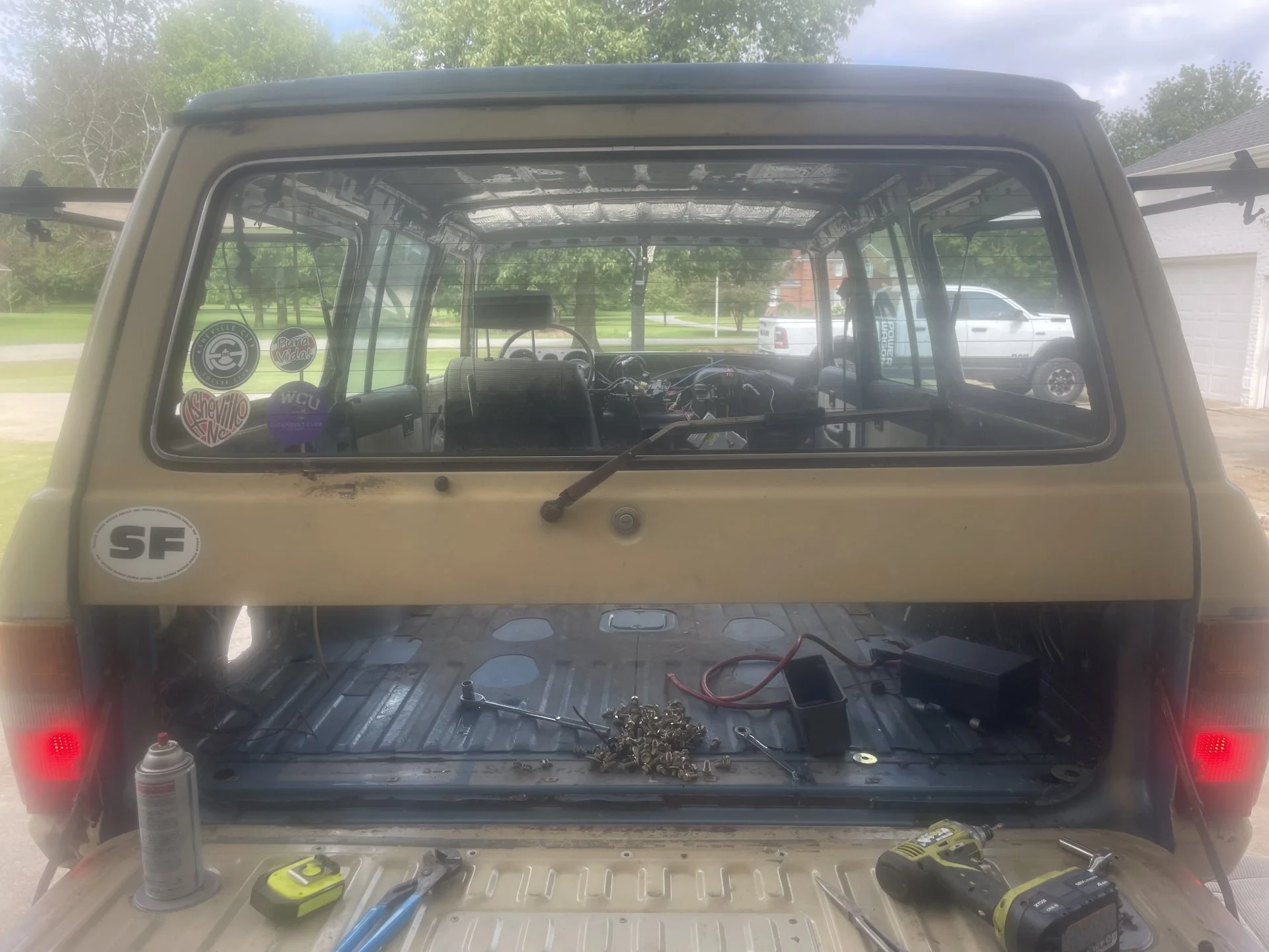

Glass is in. Went on a run down the Hwy for the first time in almost 2 years. A few initial driving impressions
  • It’s not bad around town. Takes off quick, easily merges in traffic.
  • Tracks straight, which was the big one. Did my angles right.
  • According to GPS Around 55mph 2500 rpm.
  • With out the interior and nothing between me and the gear box, The H42 felt like it was screaming at me. (Realized it was low on gear oil. Added a qt and it seems much happier.
  • I kept looking for 5 gear. H55 would be nice.
  • Fuel gauge isn’t correct, Guage was reading below 1/4. Stopped to top it off and it only took 3 gallons.
  • Exhaust leak at the manifold feels like it getting louder. Could be the lack of interior and speed not seen yet.
Really happy. Time to start digging through bins and get the interior somewhat together.

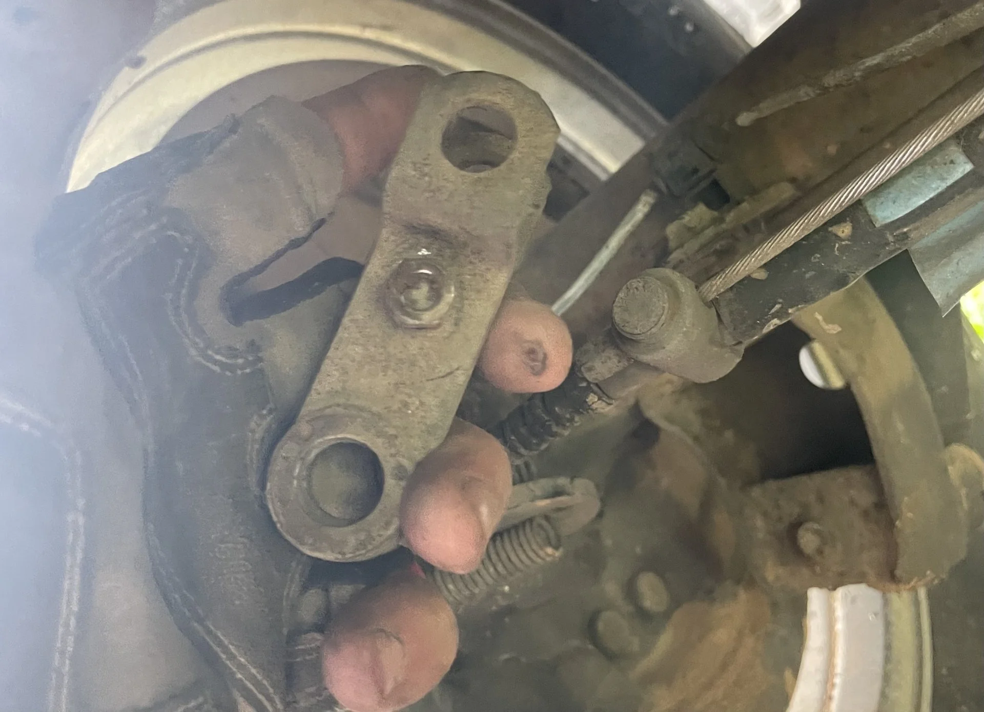

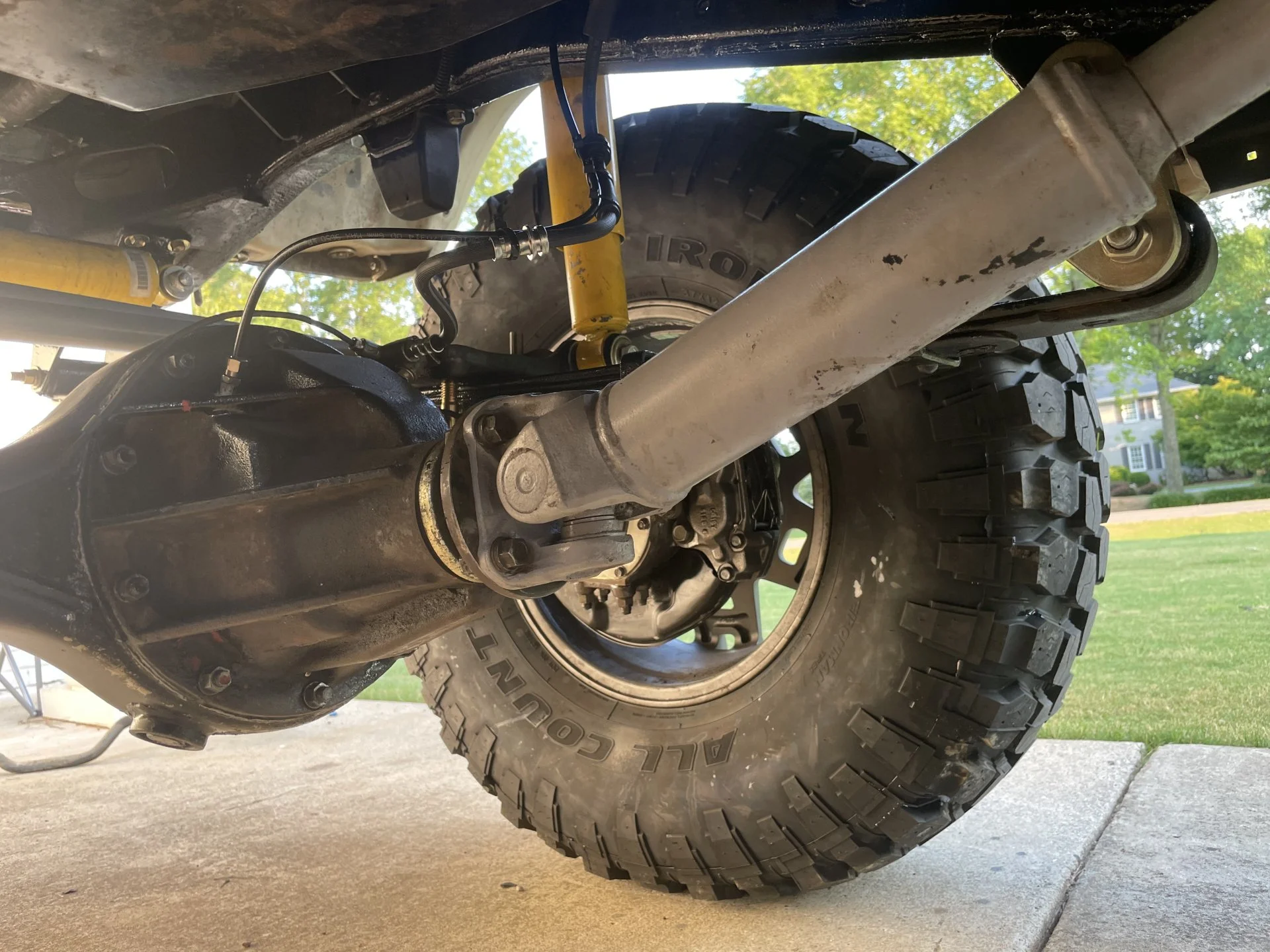

Sometime in 2020 I purchased a new Aisin e-brake handle and 60 e-brake cable. Installing them last night I couldn't find what I did with my "equalizer parking brake" bracket. Part number 46341-31010. Pretty frustrating since i've had one as recent when I stripped the 80 axle.
Luckily I was able to find one under a late 90's 4runner. It worked out because I was able to get the hardware and bushings. Fit perfectly.
A trip to Lowes for 5' of cable and I was able to lengthen the 60 cable on the 80 rear.
Nice pull. Question, though, is the main cable run from the body to the axle as tight as it appears?
It’s a bad picture. E brake was on.
The mount at the frame was altered when the frame was on the ground at the salvage yard. Moving it back into place will help move the cable over to driver a few inches.
