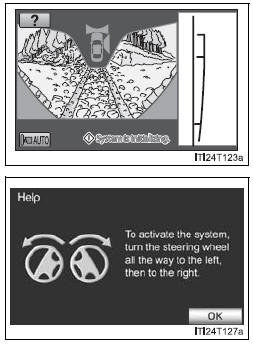

Started seeing this message the other day on the nav screen when putting the vehicle in reverse or using the forward camera. I tried following the reset procedure at
Toyota Land Cruiser: Multi-terrain Monitor - Using other driving systems - When driving
but the message hasn't cleared. Everything seems to work except the yellow lines that appear on the screen that show the vehicle direction. Any ideas? I assume there's some miscommunication between the nav system and the steering position sensor, though the little graphic on the MID shows the direction the front wheels is pointed seems to be working fine. I'd rather avoid the trip and waiting at the dealer if there's another way to clear this.

  • If the message “System is initializing.” is displayed
“System is initializing.” will be displayed on the screen under the following conditions:
  • The battery has been reinstalled.
  • The steering wheel has been moved while the battery was being reinstalled.
  • Battery power is low.
  • The steering sensor has been reinstalled.
  • There is a malfunction in the signals being output by the steering sensor.
    Initialize the system by performing either of the procedures below:
  • Drive for a short period of time while keeping the steering wheel straight.
  • Stop the vehicle, and turn the steering wheel as far as it will go to the left and right. On the system initialization screen, touch the “?” button to display the operating procedure.
If this does not resolve the symptom, have the vehicle inspected by your Toyota dealer.

I changed battery and headlamp. Received the system initializing.
Fixed the issue.
