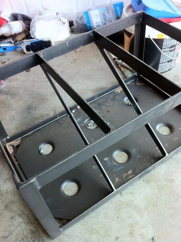

First cab off the rank is the Jerry Holder. I made this with about $50 worth of steel and the use of the awesome "Fatz Fabrications" workshop thanks to Nathan. It holds three 20L Jerry Cans giving me the ability to carry an extra 60L of fuel or any fuel/water jerry can combo. With the frame bolted up to the first and second ladder rungs I have about a 1.5" gap between it and the tyre, it sits flush with the tyre in terms of rear protrusion and it doesn't come out passed the join between the inside and outside tail light assembly.
Here is a photo, sorry I don't have any close ups of the mounting but you get the idea.
This photo was taken on the test run for the Jerry holder to make sure it would be ok before I tidied it up and painted it. The roads in and out from this beach location are fairly horrendous with a lot of heavy corrugations and some big wash outs. From what I can see through the rear vision mirror and post trip inspection there is little to no movement/vibration when loaded up with the 3 full Jerry cans. I am going to keep an eye on the swing out on future trips but if the Tyre carrier handles the 35" tyre and Hi-Lift jack which together weigh between 55 and 60Kg then I can't see that being a problem.
Here is a photo of the bracket itself.

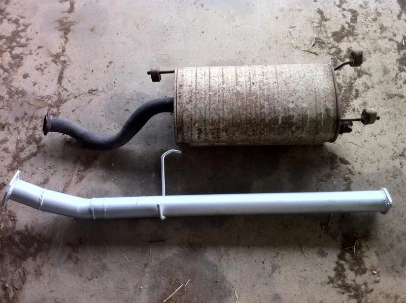

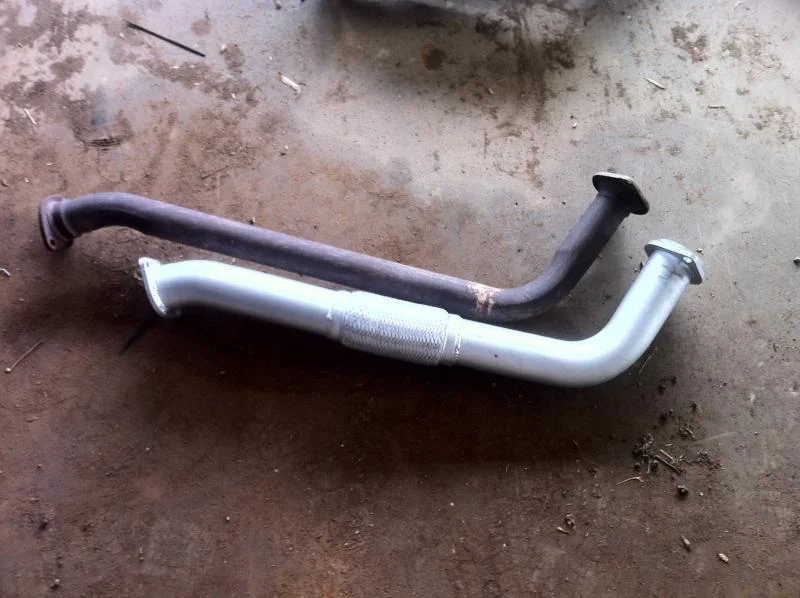

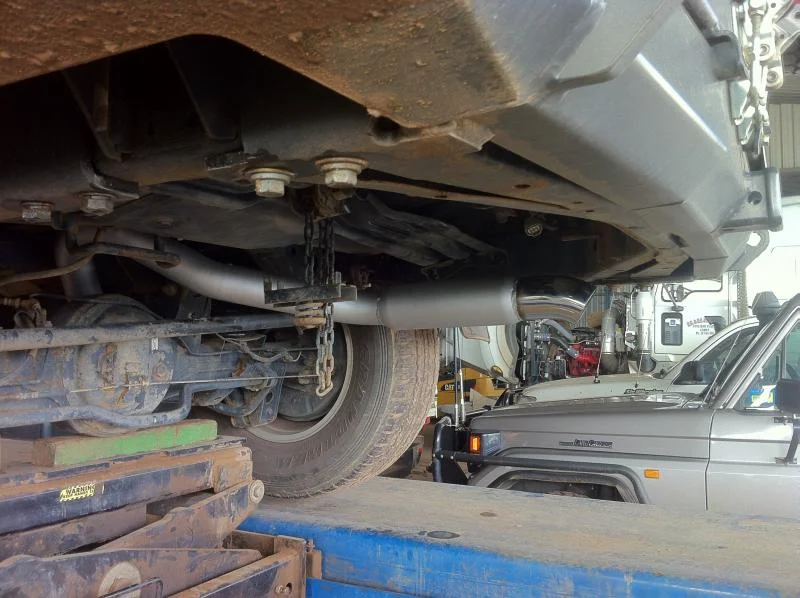

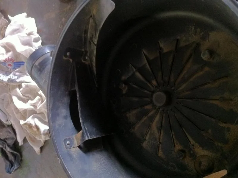

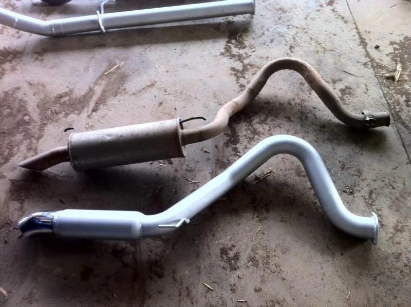

I got around to fitting the 3" exhaust last weekend and at the same time I did the air box modification detailed on the LCool forums here http://www.lcool.org/forum/viewtopic.php?t=2191 My 100 has the later model safari snorkel on it which negates the need for the inner guard modifications, I just removed the dust spinner tube section leading into the air box and removed the tin plates in the actual box. But here are some photos comparing the standard exhaust with the new one.
I bought both the dump pipe and the tail pipe that goes over the rear diff, and made up the bit in the middle with no muffler, as every kit I could find came with a reasonably large muffler still in that part. I also modified the rear section by adding a hot dog and 3.5" chrome tip to take the bark out of it and also add a nice finishing touch :cool: as it was just normal pipe right to the end.

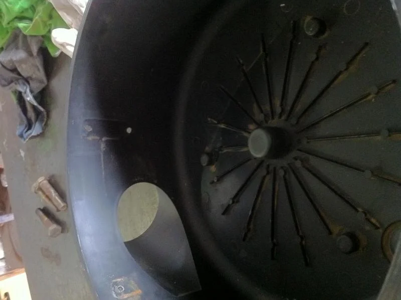

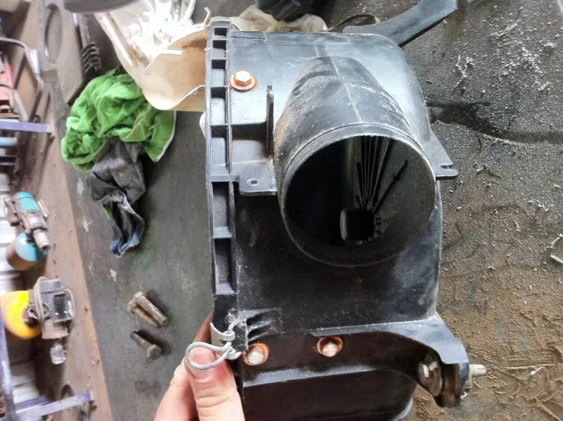

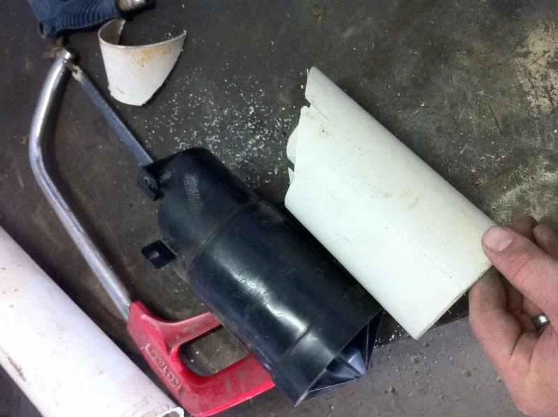

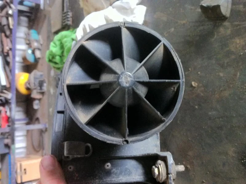

The Air Box mod was fairly simple as well, I just removed the whole lower half of the box to do the work. As it goes through in the Lcool forum thread I just drilled out the rivets, put some bolts with sealant on them back in the holes that go through into the box and fitted it all back in, good as gold! Here are some pictures of the process.
The removal of the tin plates on the inside of the box:
And the mod to the tube leading into the air box. The orignal pipe just gets replaced with some PVC pipe cut to suit. Then quite a large quantity of silicone to seal her all up! ;)
Bolts in the old rivet holes.
THE RESULT!
After carrying out these two mods I've experienced a very noticeable power gain with a lot more response from the turbo and cooler EGT's. The turbo is operating at higher average boost pressures and I've gained about 1 PSI peak boost increase with the more free flowing intake and exhaust set up and it is also holding that boost pressure at a constant 12 PSI where as before it would drop off higher in the rev range. The EGT's are down by about 40 to 50 degrees Celcius across the board with it peaking now at about 670 Degrees C.

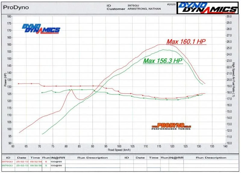

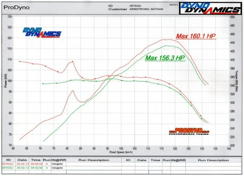

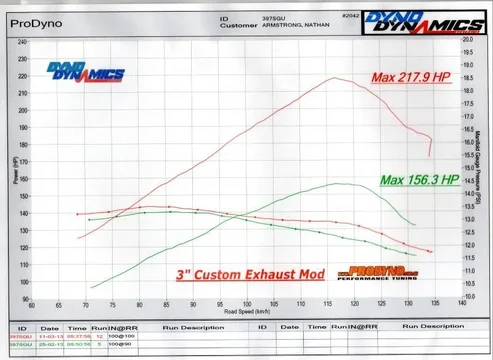

This morning I went back into ProDyno to carry out another power run, to see the difference on paper and I was very surprised at the result.
Horsepower and Torque in FtLb's
Kilowatts and Torque in Nm's
Horsepower and Manifold Air Pressure

Looking good Nathan! I have removed the intake spinner and boom bottle, but hadn't thought of removing the tin plate inside the airbox.
I am off to Melbourne for the F1 on thursday and am leaving my car with Graeme to see if he can sort out the boost cut problem. When I get back I will be sourcing a 4" intercooler with 3" inlet/outlet and starting to play with a 3" intake.
I am off to Melbourne for the F1 on thursday.
Yeah Brad at ProDyno mentioned that they remove that inner part as well, makes sense I guess. I'll be at the F1 as well! Who's your money on this year for constructors and drivers champs?

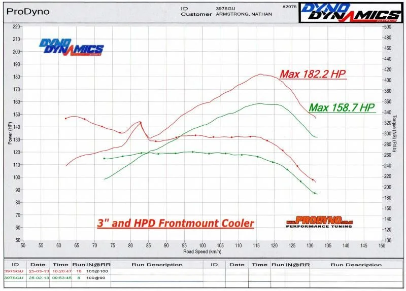

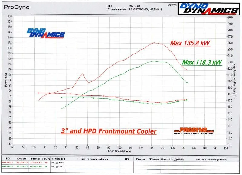

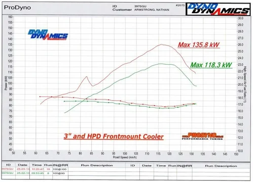

Ok so I've had the HPD Intercooler fitted for a couple of weeks now and I went back to ProDyno for another power run to see where we're at... BUT!! It seems, as I'd suspected by the overly high figures, that the dyno was a fair way out of calibration last time I was in there for the power run on the exhaust. Since then they have had the dyno calibrated, Brad apologized for the drama and didn't charge me for today's run.
So unfortunately the figures shown in the last few dyno sheets I put up are not consistent with the real numbers we're getting. Which buggers up my plan a little bit to show everyone what increases you can expect for the different mods, but from here on out, they should be pretty spot on.
All the info on the HPD Front Mount Intercooler Kit I purchased can be found on their site: http://hpdiesel.com.au/toyota-landcruiser/100-series-landcruiser/toyota-landcruiser-100-105-series-intercooler-upgrade
My honest opinion on this kit. The cooler itself is a high quality piece, however the fitting instructions and fasteners supplied to do the job leave a little to be desired. The instructions consist of two A4 pages with a bunch of pictures on them, no written directions at all, and the bolts supplied were barely long enough to be properly secured. So much so that I ended up getting longer bolts to do the job. But, if you've got this information and have longer bolts ready, the fitment is probably a 6 or 7 out of 10 for difficulty to do yourself. Only because you have to do some trimming of the grill to get it to fit nicely.
Anyway, onto the results! Now on a recently calibrated dyno. Keep in mind that the standard reading that we are comparing this power run to was probably a little on the high side as well due to the poor calibration of the dyno at the time. The flare up you can see on the red line is just from the Auto trans locking up the Torque Converter.
As for the real world results that I've noticed behind the wheel. The car feels like it has a lot more torque now with the cooler along with the exhaust. The dyno results show we're now at just over 400 Nm or nearly 300 FtLb of torque. With EGT's dropping by about another 30 to 40 degrees Celsius across the board. All in all I'd say the two mods compliment each other well and if you aren't looking for massive power figures but want a bit more grunt and drive-able power then these two upgrades are a good bet. With the both of them costing me roughly $1600 to do, (fitting myself, which saves a bit of money in labour) it's pretty decent bang for your buck in my opinion.
Here is the power in imperial measurements
And in Metric
And Metric with AFR
