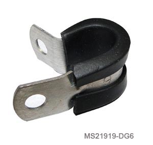

If you can't find the factory clamp your looking for you might want to try a aircraft Adel clamp, they are made out of metal with a rubber liner. They are made to clamp tubing or wires in sizes from 1/8 inch, all the way up to 3 1/8 inch.
MS21919 DG / WDG CLAMPS from Aircraft Spruce
