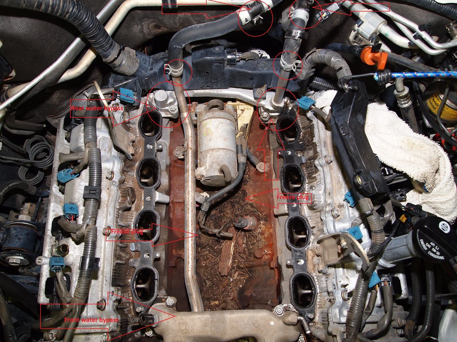

It would be very hard for A/C drain water to get on top of transmission. You do have heater hoses, pipes (heater tees) and rear water bypass joint that coolant runs through. This is all at rear of engine and could appear to come off transmission. Sometime people just put water in cooling system, not good.

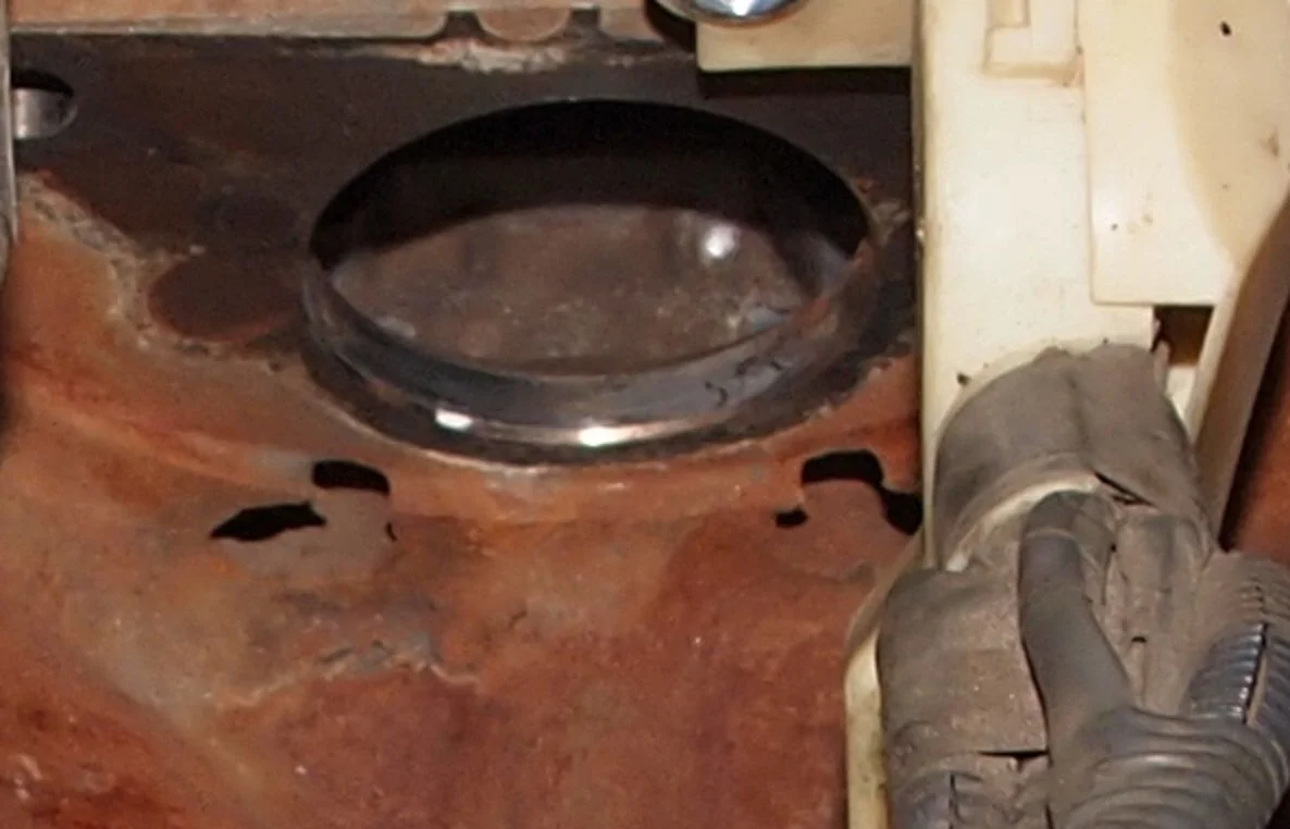

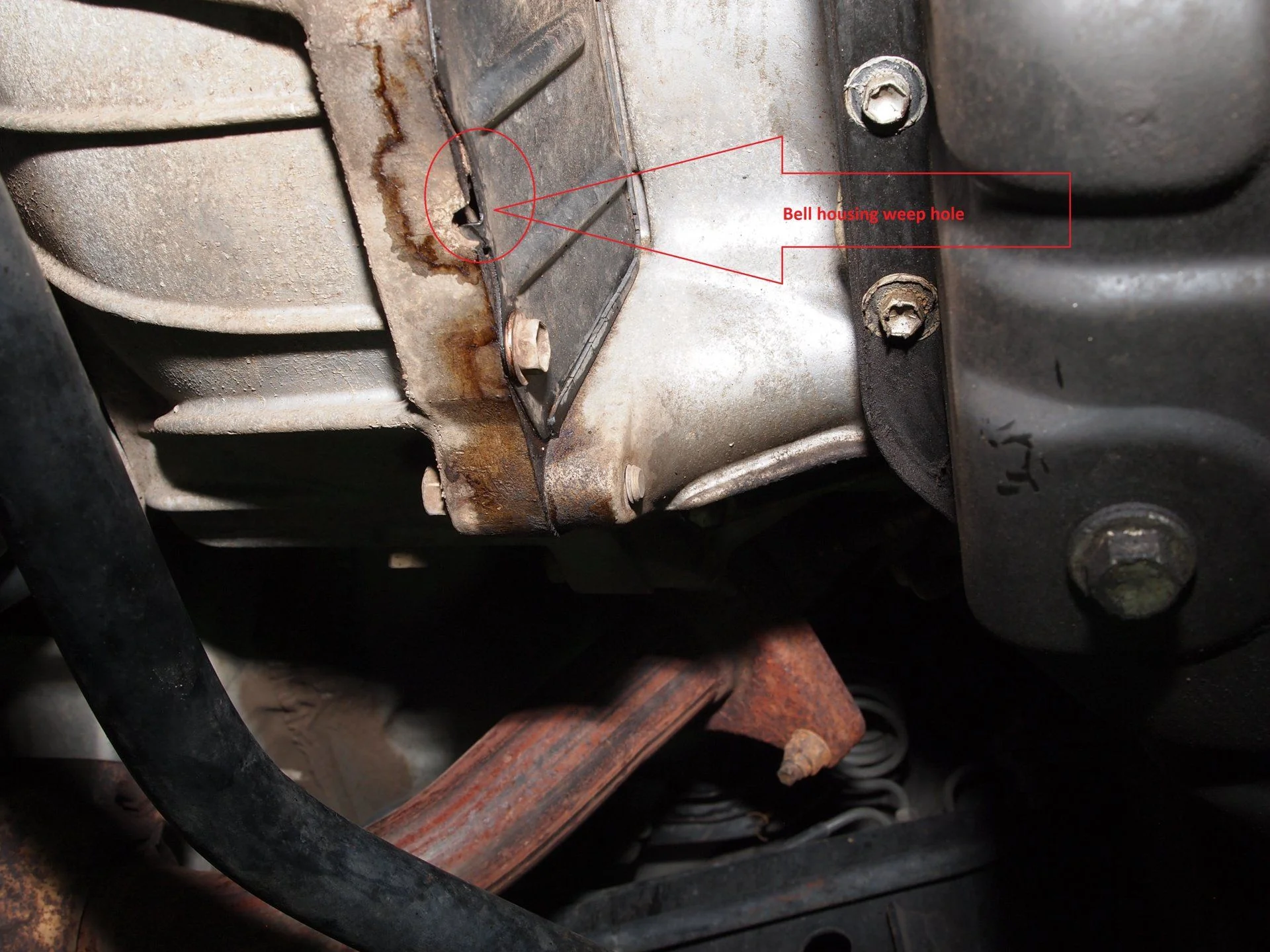

Also the engine valley has two drains in rear of engine block on either side of starter. Any fluid their will run down inside bell housing and come out weep hole. Raising front end will till engine just right to get and leftover fluid from valley. Fluid could be from cleaning engine or a engine leak.
Starter removed, two valley drain holes. Drains to back of engine comes out weep hole.
View attachment 1804147 Starter removed, two valley drain holes. Drains to back of engine comes out weep hole.
