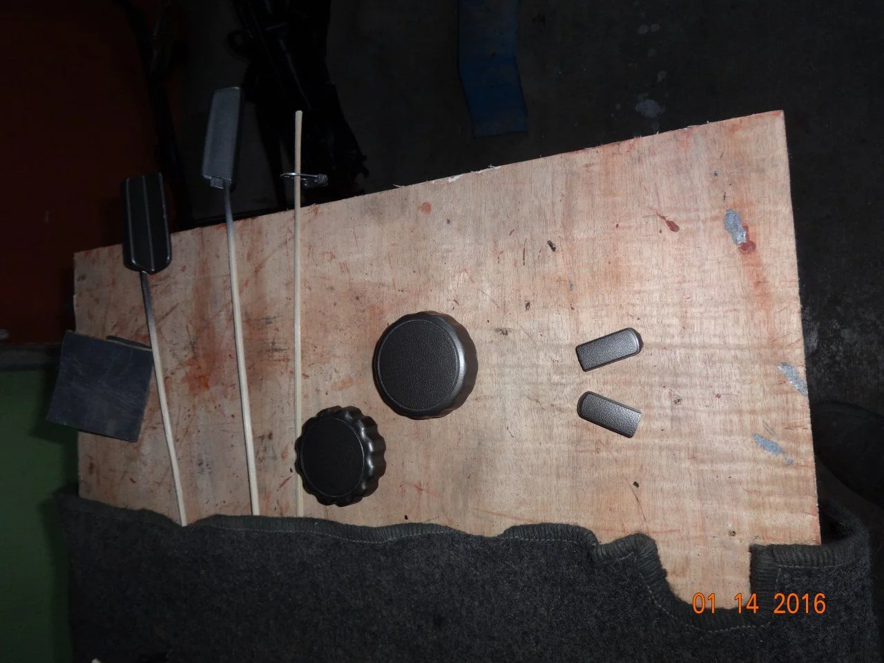

Door switches ready for installation.

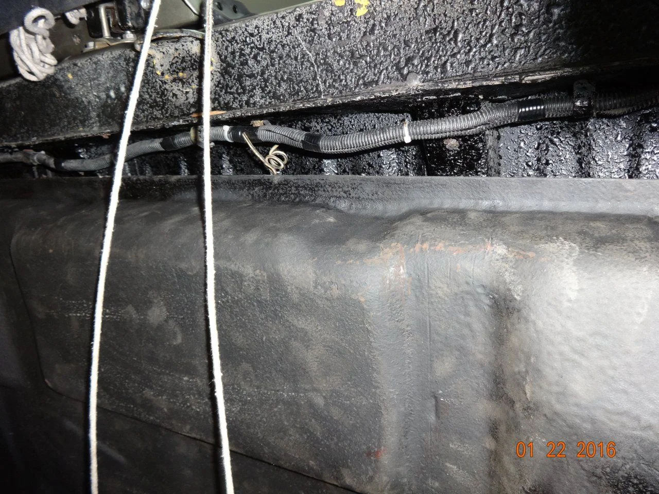

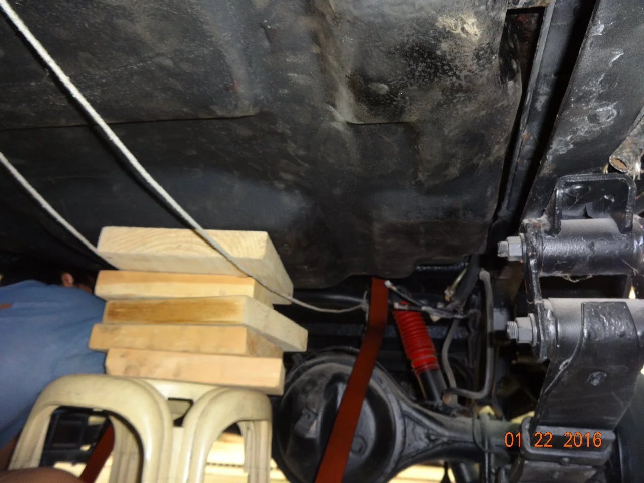

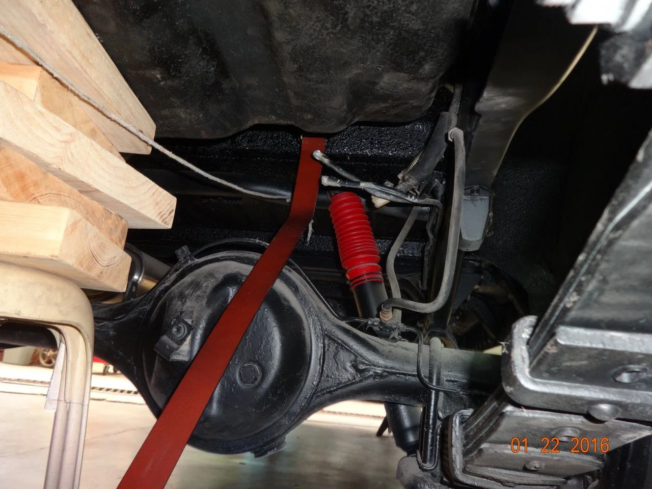

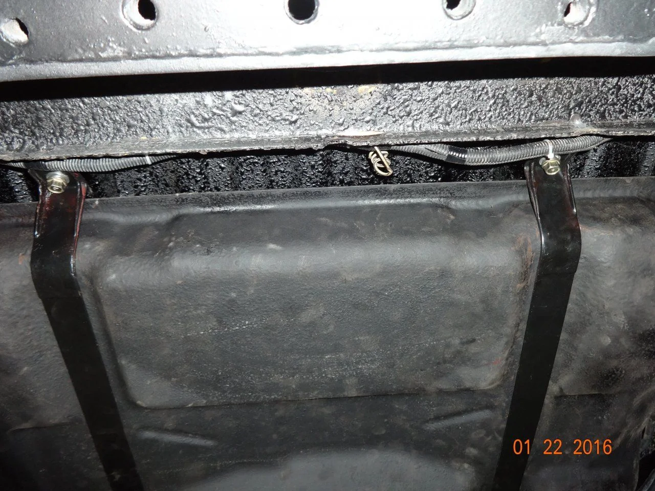

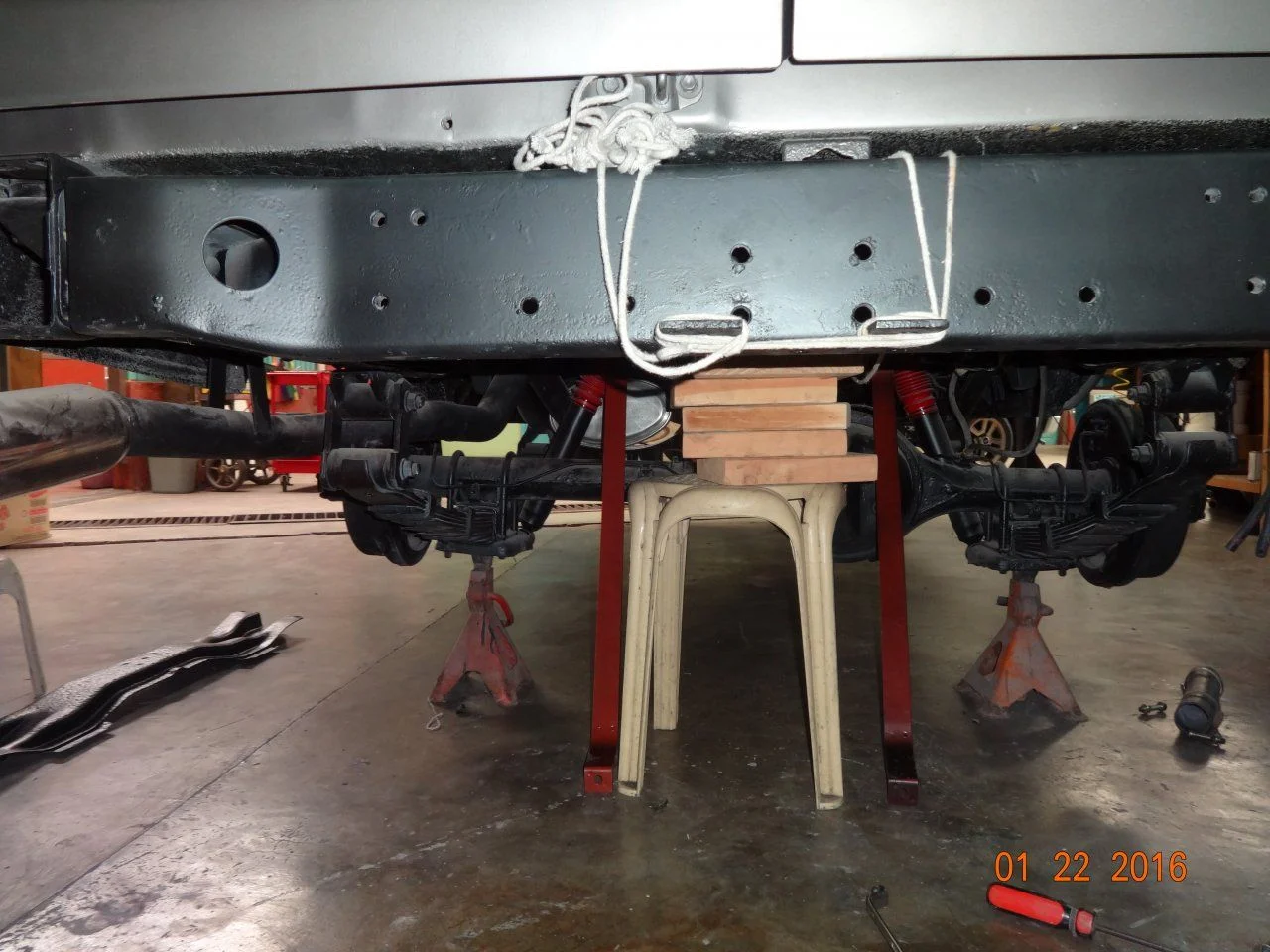

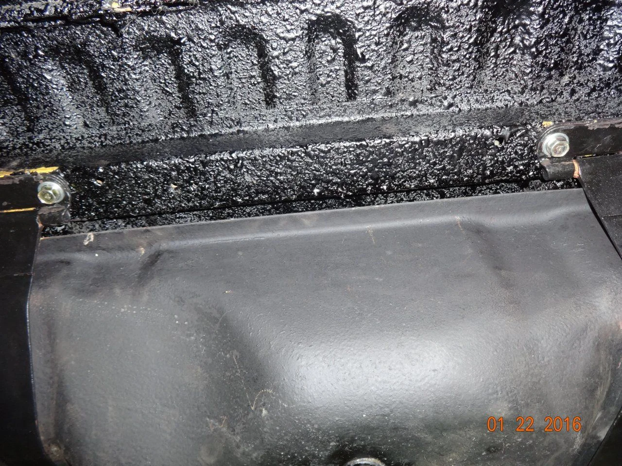

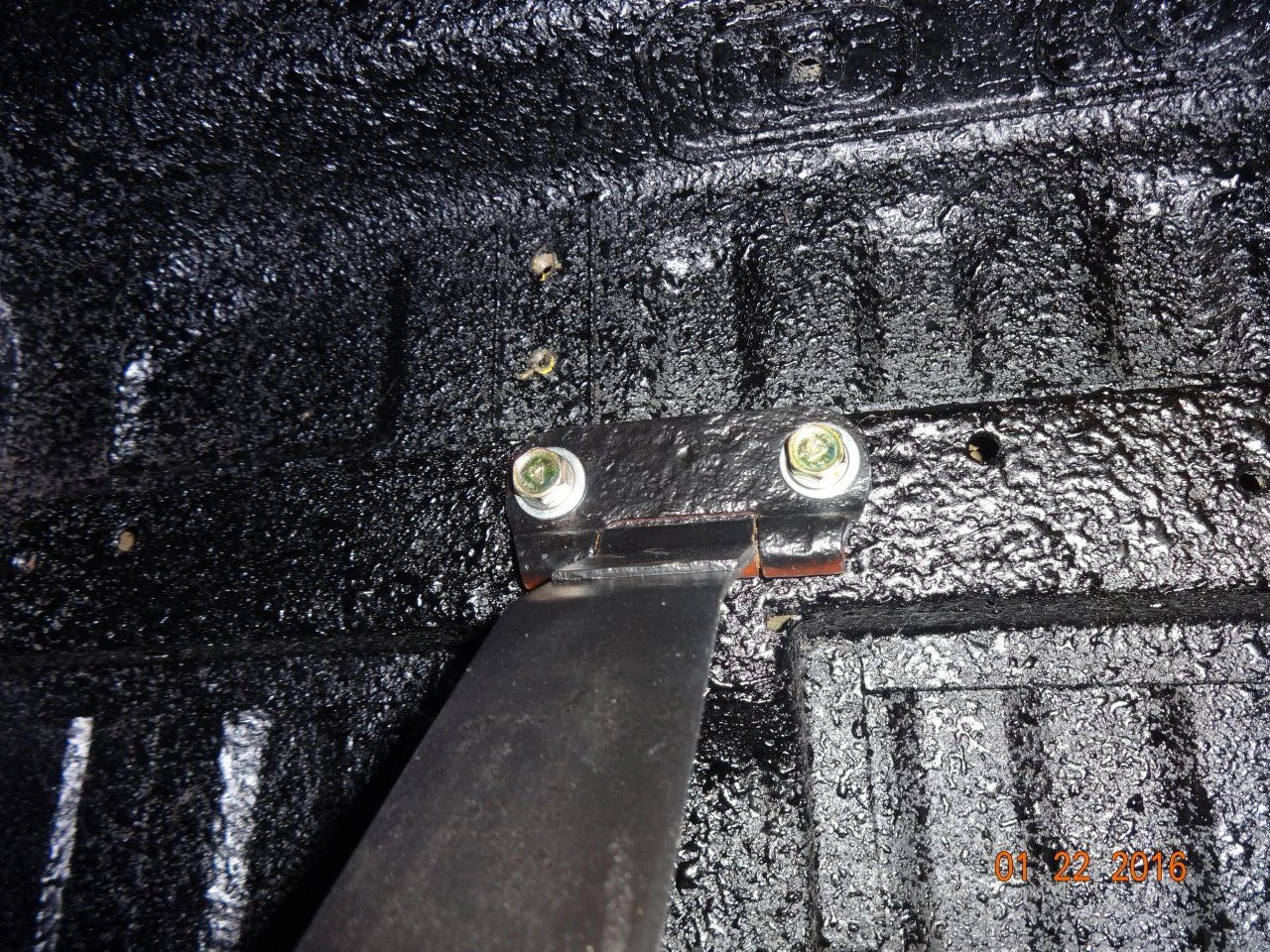

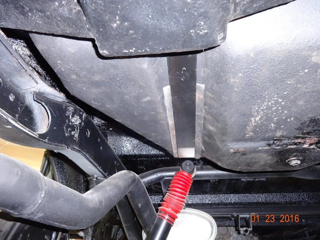

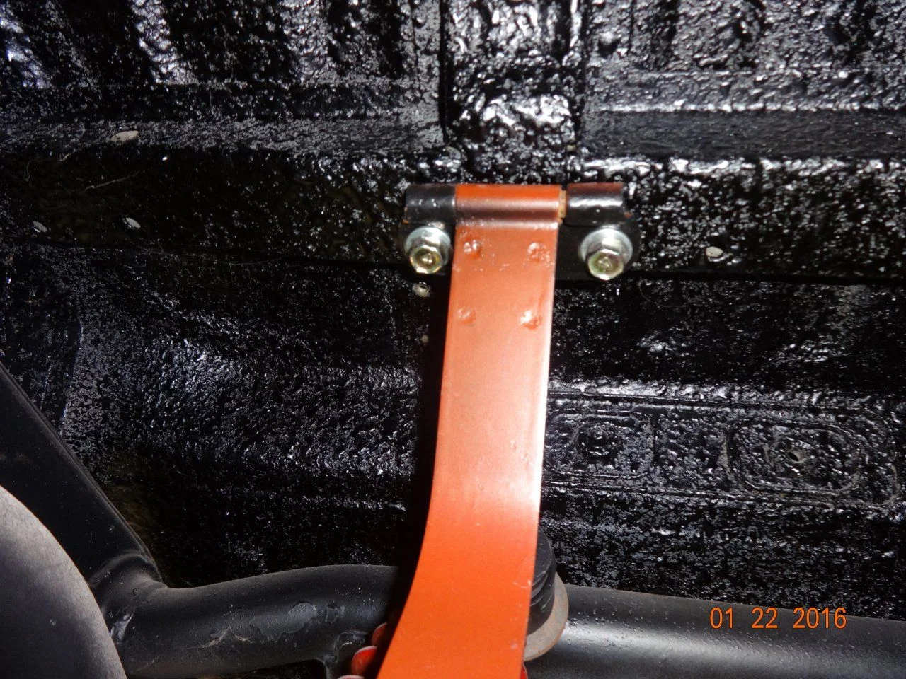

There are supposed to be little rubber cushions for the straps so that the tank rides on the cushions, not on the metal straps.
Beautiful :D
I did place a cushion similar to the ones place on the top of the fuel tank. It is actually felt cushion. The real cushion for the bottom is a protector and I believe is made of plastic based on the weight of .5 kg. See photo attached.

If I remove the tank one more time I will replace the clamps with screwable (...:confused:) because they have been on it for 25 years and somehow mine started leaking when using a fast truck diesel filler, :slap:
Not nice when road check guy smells diesel leaking, impossible to replace when tank is mounted.

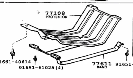

I dont have that protector plate, is that an accessory? ( it does have the felt/carpet bit)

When I bought Willie (my HJ61) it came as is without a protector for the tank. So I improvised a felt lining so the strap would not get into contact directly with the tank. Still serves the purpose.
I believe the protector plate is available in Amayama Trading. This is where I get most of the parts from. They are based in Singapore which is nearer the Philippines and less shipping cost for me. :clap::clap:
Cost for the protector from Japan and OEM US$38.66 excluding shipment.
