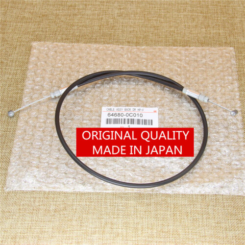

Factory cable for the hatch, or did you find a good aftermarket? I just replaced my handle assembly and then 2 days later it’s not opening again. I’m guessing the cable is stretched or not staying put.
I bought mine from a dealer I buy from a lot, although here is one on ebay that seems OEM.
The OEM part number for the cable is:
646800C010
Thanks for the link. I know the parts girl at my dealer well (she has a done up 3rd Gen 4Runner) and she loves my Sequoia so always gives me good deals. I’ll price it there first.
