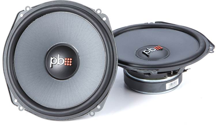

I did replace the front blown speakers and have to say I am impressed with the amount of bass and power they will take. For $59, I am very happy.
cheap here:
I just chopped up the old ones to use their metal bezel as a mount and screwed the new speaker into that metal bezel. Still 7" and 2ohm. They work GREAT.
