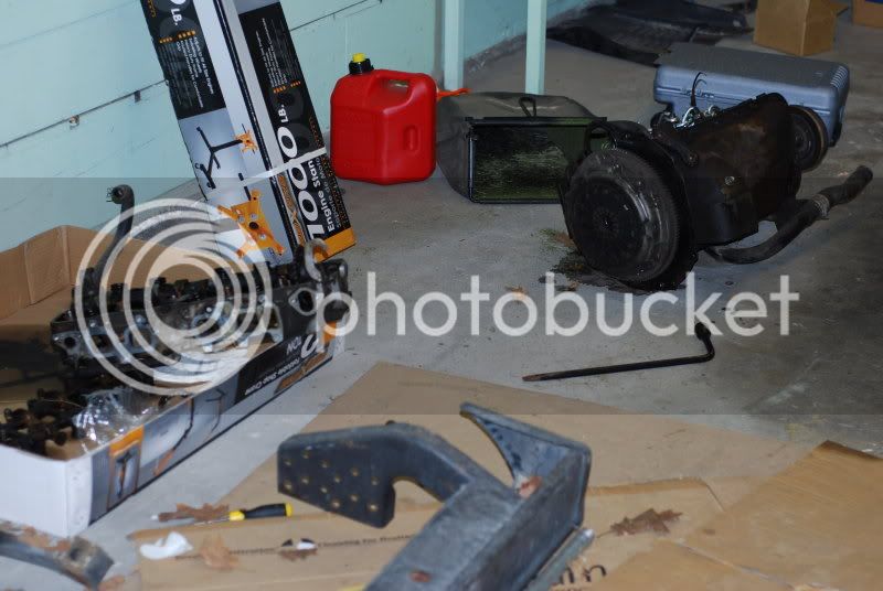

To begin with, my tiny garage has been a mess, and the engine has been laying on its side with the clutch still attached and all.

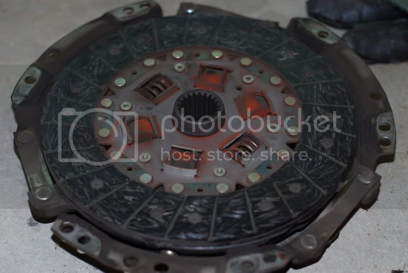

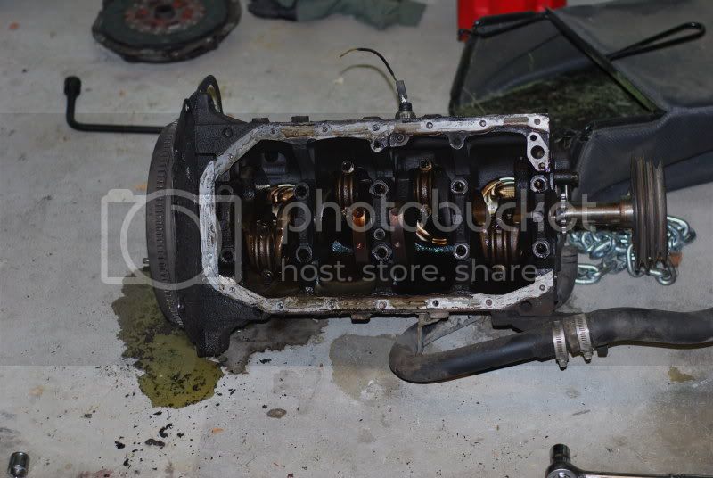

So after cleaning up the garage and setting up the engine stand, I set to removing the clutch. After encountering some problems with the 17mm bolts between the flywheel and engine block, I decided to tackle removing the oil pan and getting the crankshaft ready to take out.
(Yes, thats oil/coolant sludge in pools under the crankshaft :barf: )
Any tips on how to get those 17mms off? I can't seem to keep the engine from turning over when I try to undo them, and if I brace the engine I don't seem to be able to apply enough force.

If you don't have access to air tools then the flywheel bolts can be difficult. Cut two wooden blocks that will fit between #2 & #3 rod journal & the side of the block, soft cheap wood like white pine. These will prevent crank rotation. Have a plus sized friend stand on your engine block. Now if your friend is big enough everything should be immobile.
Alright, progress today!
The suggestion to use wood to brace the crankshaft from moving was brilliant, worked perfectly, though I broke one of my [cheap] 3/8ths wrenches on those bolts, since I can't seem to find my 17mm 1/2'' socket.

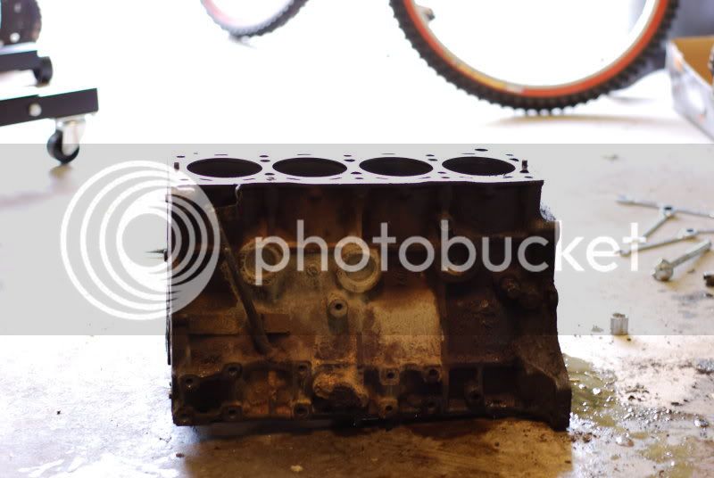

Now the block is all ready to be cleaned and possibly bored... not sure what exactly I'm going to do with it. To be honest I was quite pleased with the power I had before.

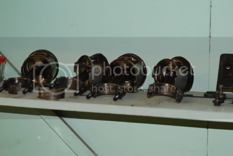

I've decided to try to keep things semi-organized, even if I don't use those pistons.

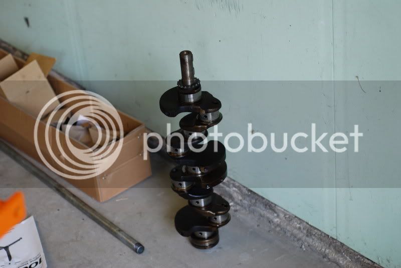

Yee olde crankshaft :bounce:

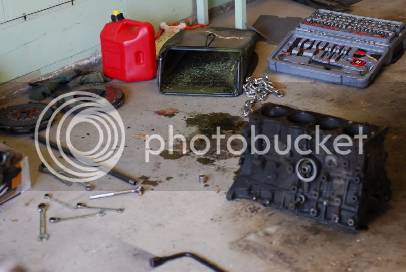

Here's what the garage looks like now..

Should I just have the block cleaned and re-honed? Should I just get my crank honed and get new bearings/etc? New pistons or just new rings?
Like I said, I was happy with [probably less than] stock horsepower and torque, and I don't plan on using bigger tires than 31'', since I run IFS.
The machine shop will mike all the journals in your engine and tell you what is best. As a rule I would not just willy nilly go boring. That's that much more you have to pay for, and that much more it will be over bored in the event you want to rebuild it again.
How was it doing before the tear down?
Ran good? Then I'd run a hone down it and re-ring it. If you get a precision gauge set you can mike it yourself.
Knocked and rattled? Then she'd go to the shop.
See FSM on redoing the block and head. If she used allot of oil then it's possible vale seals were the reason,,,pretty common on Toytas
