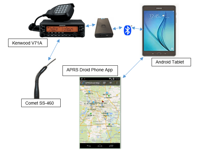

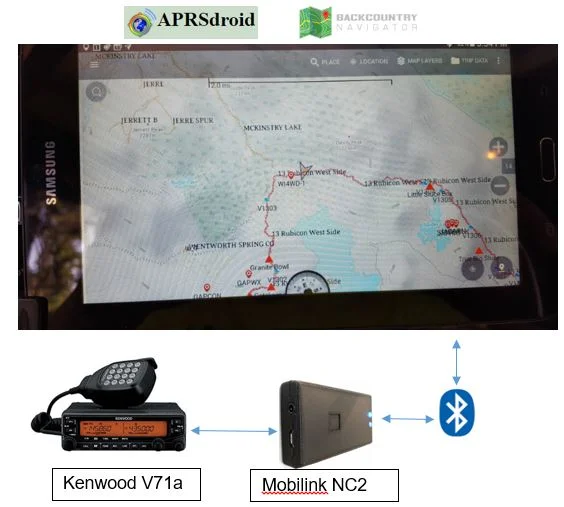

This is what I am using and it has been working excellent so far. The antenna is a bit of a compromise but found I need a springer when
trail riding in the woods of Wisconsin. I see I did not label the TNC it is a Mobilik TNC2
Hi Joel - how did you connect the TNC to the Radio? (It's bluetooth between the TNC and Tablet I believe?)
Yes it is Bluetooth between the TNC and the tablet. There is a cable between TNC and the radio. I just Velcro'd the TNC to the radio body and mounted the head up on the roof header.

When you use a tablet like this can it be wifi only or does it require cell service?
No Cell needed, the tablet is providing the GPS fix for the TNC to shoot out of the rig using the APRS network. You load the maps etc to run the aprsdroid app while in town and on wifi.
