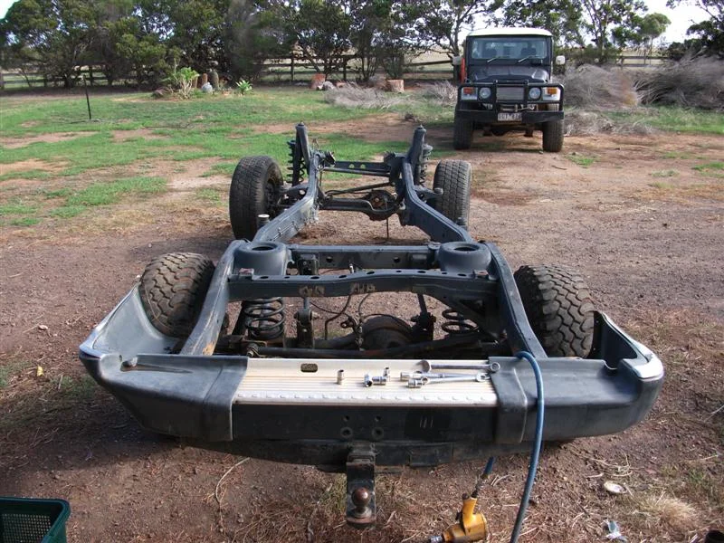

and yesterday i stripped down the entire 80 series chassi i had removed all the factory mounts of it and the coil hats ect ect
have a project im painting in the garage at the moment once its painted it can live outside and the troopy will get to live inside to get the 80 diffs and suspension fitted under it over winter so its good to go come summer YAH

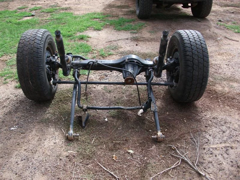

GRRR bad news this weekend staretd swapping in the 80 front diffgot the 40 stuff removed and rolled the 80 diff under put it on stands and started measuring getting it all lined up so i can mark and start welding on the mounts
while im measuring i notice that both radius arms are warped or the diff housing is warped by around 2"
so out it all came for more measuring and checking to find out whats bent im really hoping its only the housing cause i can get a bare one for 50bux
grrr
in the end i swapped the 40 gear back in as im heading away next weekend camping if the weather is 1/2 decent so was hoping to get the front diff done this weekend

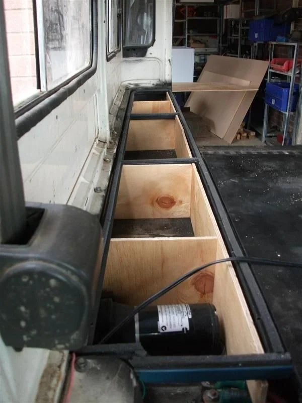

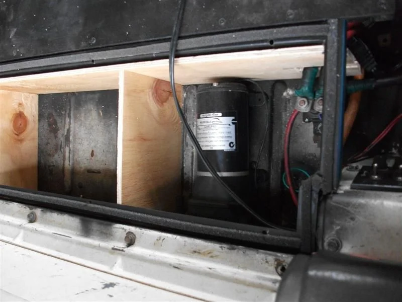

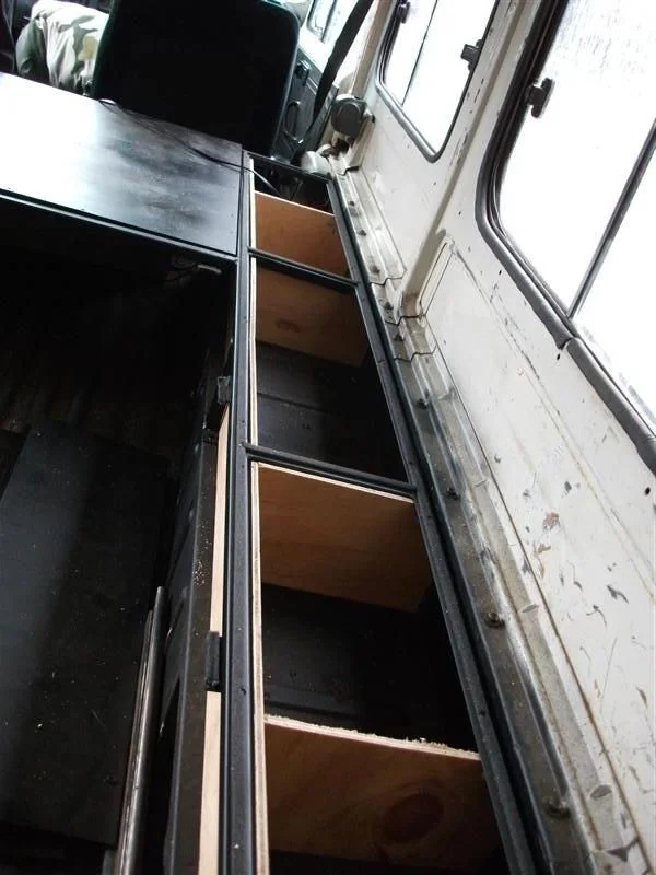

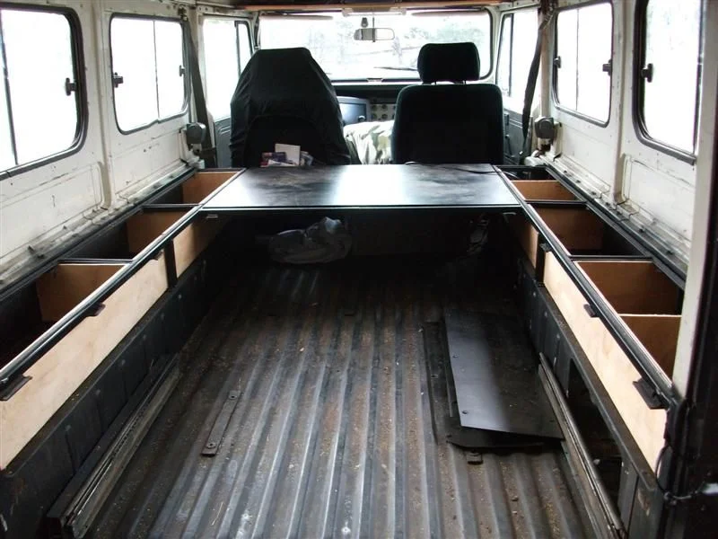

been working on the rear of the troopy for a while now LONG WHILE but finally its almost done still some of the draws too box in and make some dividers

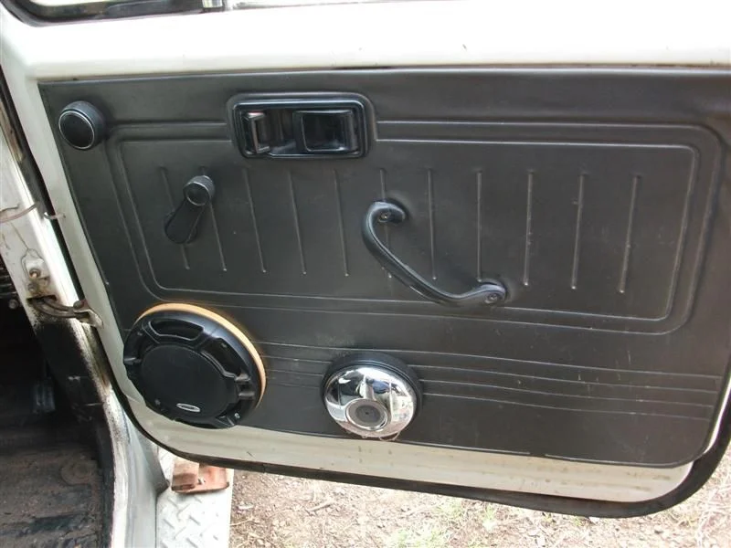

and some more pics along with new speakers and some spotlights - the spotlights are actually 20+ years old they where from,my grandfathers landcruiser that has been all over Australia up to cape york twice my grandma got me to sell there cruiser a few months ago and i kept the lights as a memento

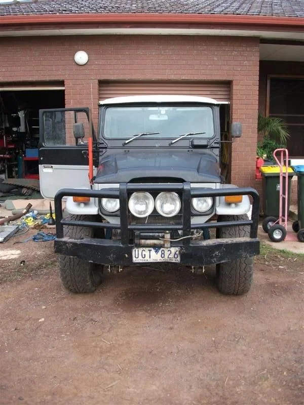

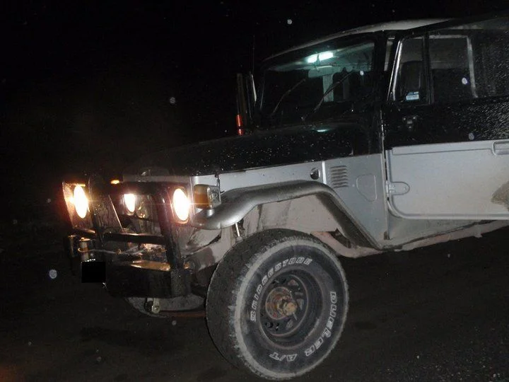

the troopy in its natural habitat
did a trip up into the high country this weekend troopy did really well however no turbo i blew the oil seal last week and didnt have time or money to have it rebuilt so i yanked it and bolted on a set of extractors
man its gutless i miss the turbo around town i didnt notice it was gone but get to a hill and its like day and night
tho now im considering going to a v8 ford windsor and efi so i have range to do a longer trip
anyway heres a few photos that where taken
