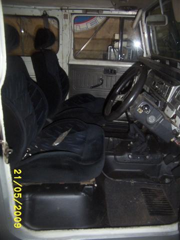

Thinking of setting up a similar thing in the back of my troopy...
none that i can find and its actually all removed at the moment for a tidyup and some reorganisation and trying to squeeze dual batterys in the back without cutting into the flat sleeping area
so ill get some pics and post up when im reassembling it all

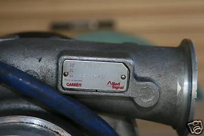

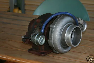

nice low km garret gt4082
specs looks perfect for the landcruiser should still have full boost by 3000 and should happily keep boosting till 6000(not that ill ever rev a stock engine that far)
just means it will be more drivable on the freeway and long distance wont be on boost as much so i should use less fuel
wow been a LONG time since updates
well the new turbo arrived and SCARED ME it was heaps bigger than i expected so i canned fitting that to the 45 it now sits on the shelf waiting for a mate to be convinced that a turbo on there v8 would be a good idea

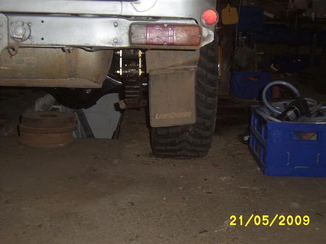

then i ripped the rear diff out and set about fittign a fj60 diff i had lying about and well 5 months later its drivable again i was totally slack and demotivated but after going camping over easter and nealy getting my pos car stuck i deceided to finish it
so that is all done apart from a handbrake cable i will have to get made up

Nice mechanic's pit- I'm jealous. I wish you lived in SA:). Once you get it outside, could you post a pic of the rear tyre sticking out looking from front to back? Thanks! I can't wait to see what the front axle looks like.
Cheers,
Josh
yeah the pit is great a little bit shallow for a car but perfect height for the 4x4
