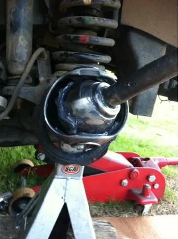

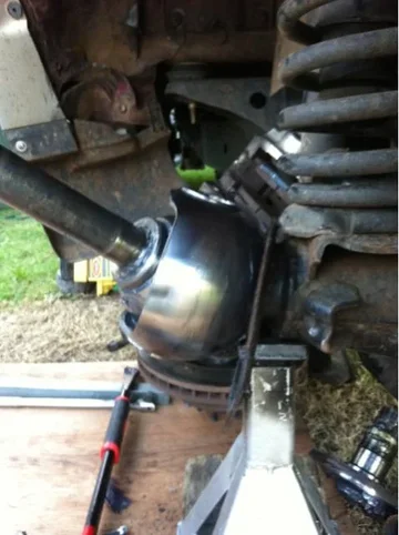

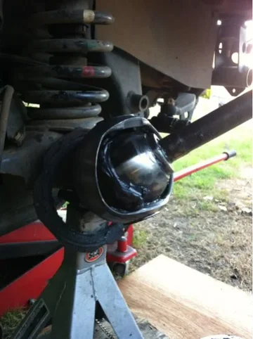

Finally I had the chance on the weekend to remove and inspect the drivers side hub on "Merlo" my new 79! Shes had a hard hit, hard enough to twist the axle housing to the point where I can't remove the axle!
Not sure how to get it out just yet?
Any thoughts? Obviously I'm up for a complete diff housing

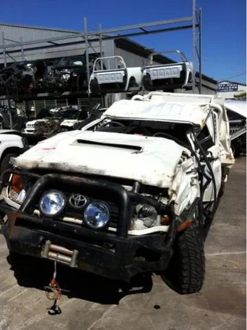

Heres a 79 that had a serious hit to the passenger side..........

Ouch...never seen a housing like thta.
It musta been a good hit.
Time to get out the power tools, grinder, and plasma torch.
Can anyone suggest why I am struggling so much to get the cv and axle out ? I've cut the bottom half of the swivel housing off and have been trying to leaver it out, was thinking of welding my big slide hammer to the shaft and giving it what's for!
It should just slide straight out! I'm thinking it must be bent further inside the housing maybe?
It's stuffed now but I want it out still!
Thanks in advance
Cheers
Sent from my iPhone using IH8MUD
