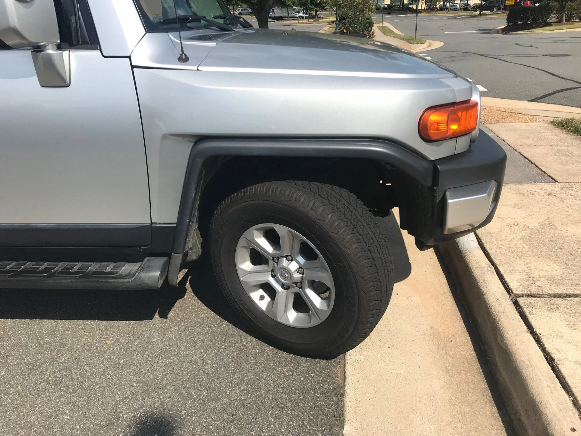

I don't know what wheels these are? Any idea?
