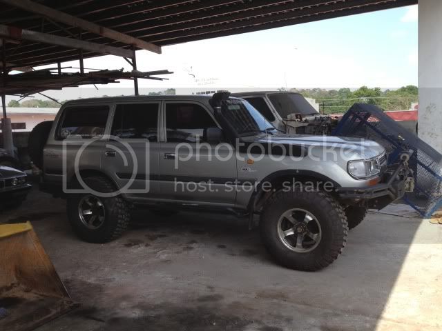

My New 1999 Venezuelan 80

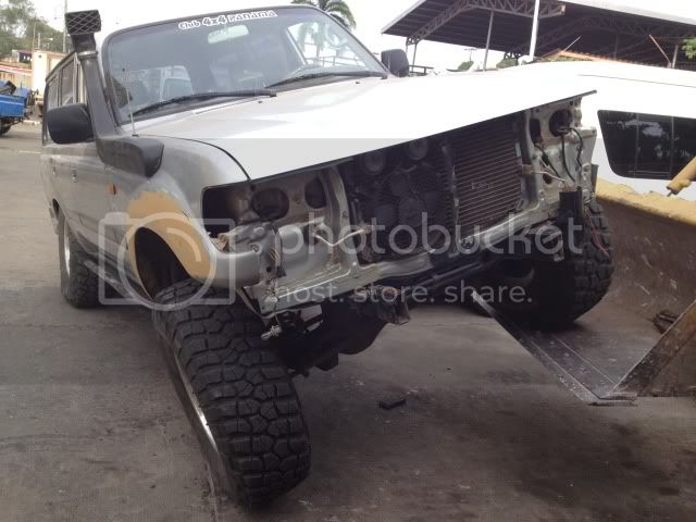

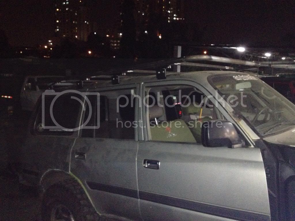

Hi Guys, I wanted to revive this thread because i Had sold this truck to my friend Tapage , actually his wife, And after 5 years of hardcore mall wheeling , I bought it back to finally build my ideal 80.

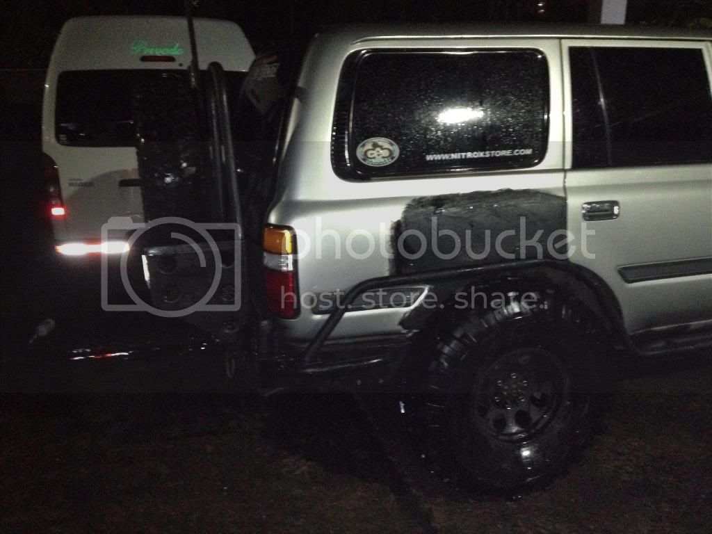

I've had it over a year now and have got it almost done. But when is any of this ever done??

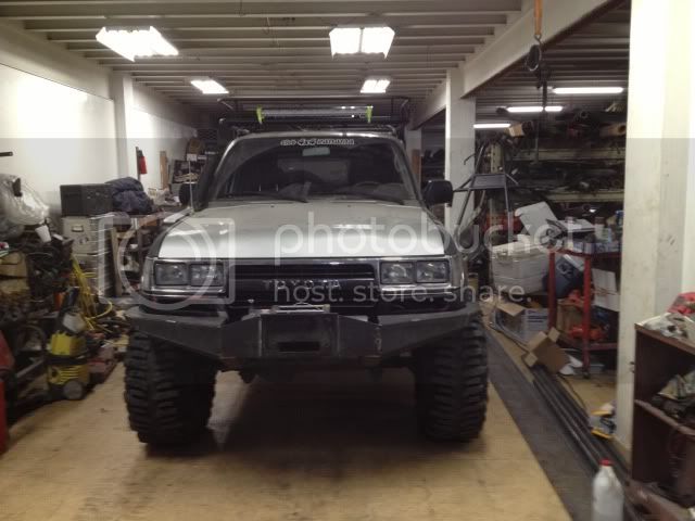

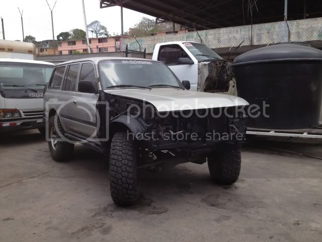

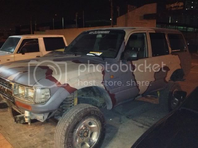

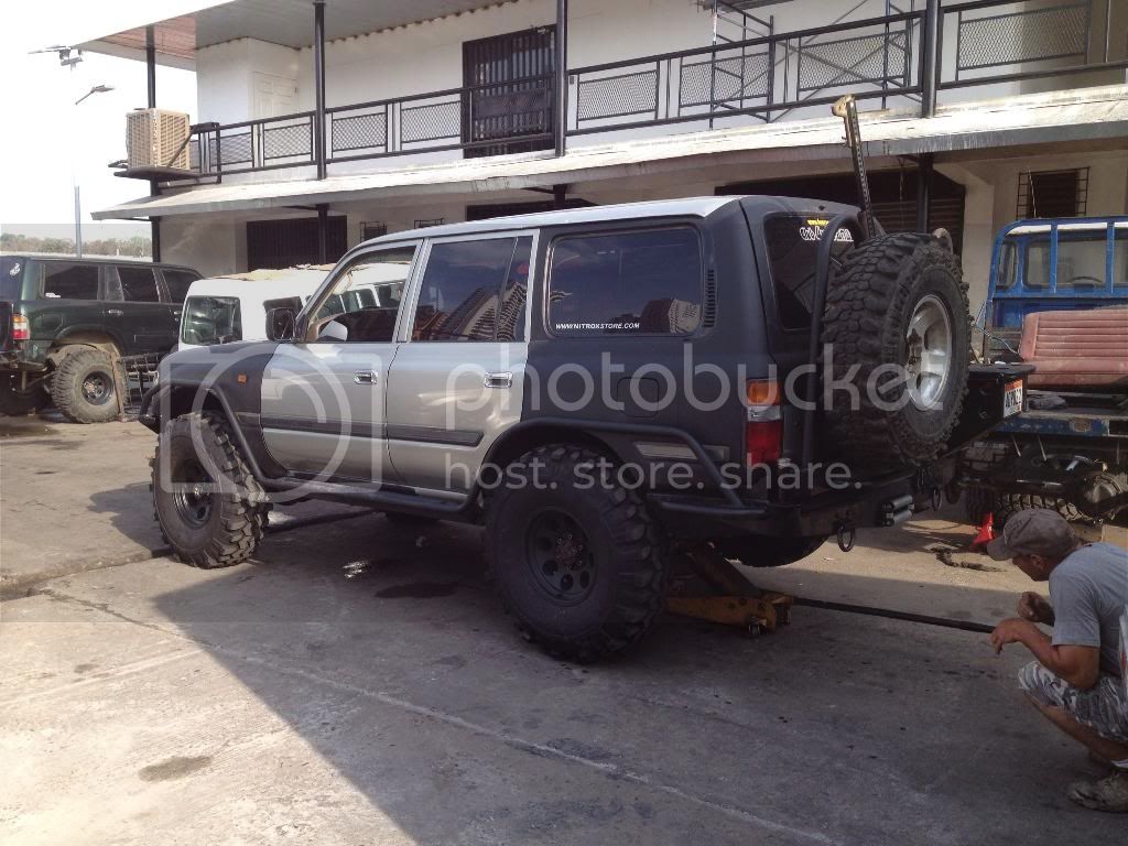

This is how i got it.

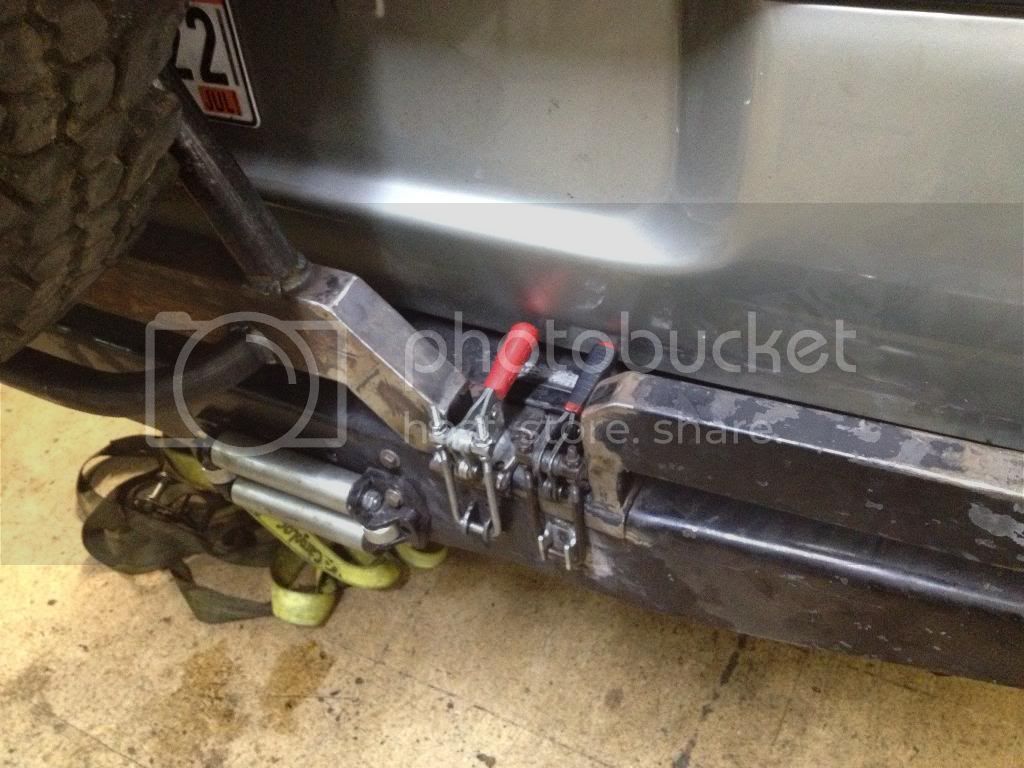

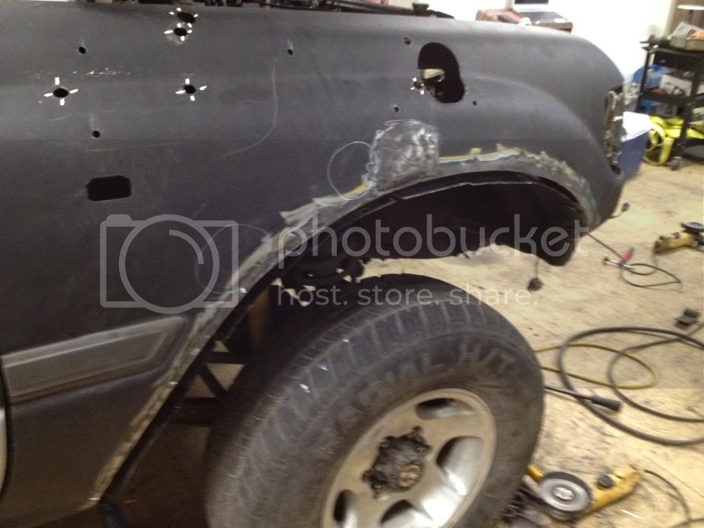

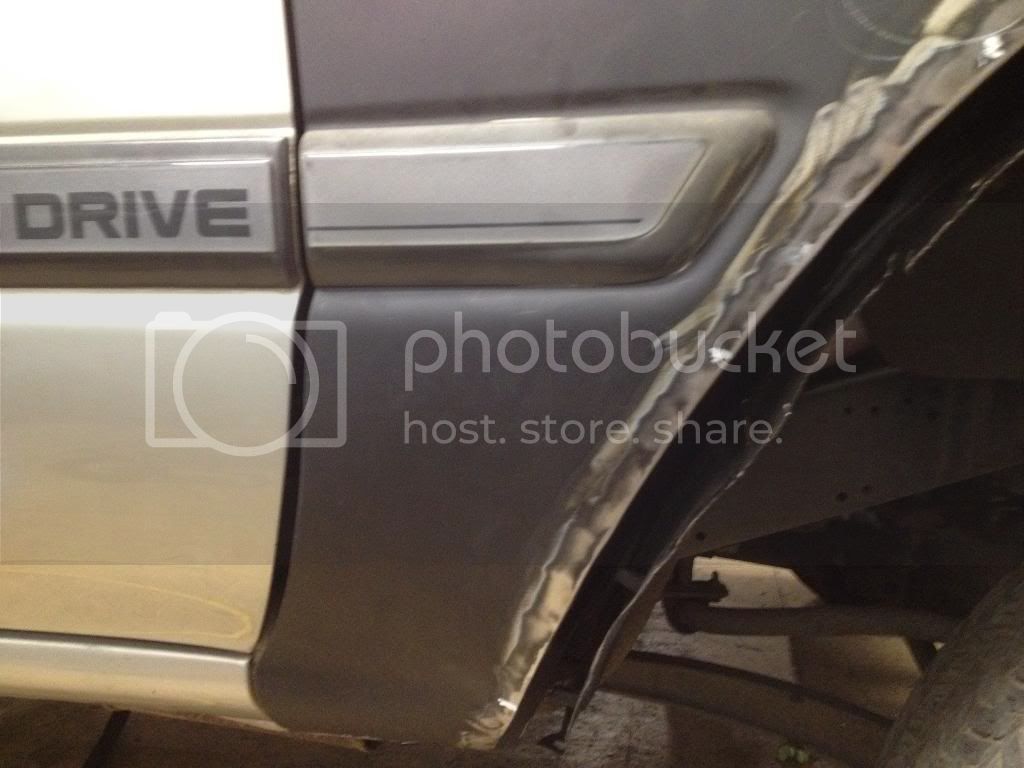

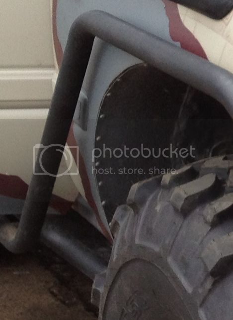

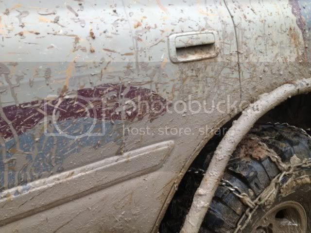

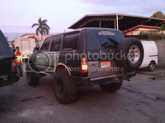

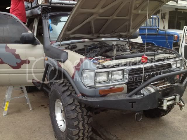

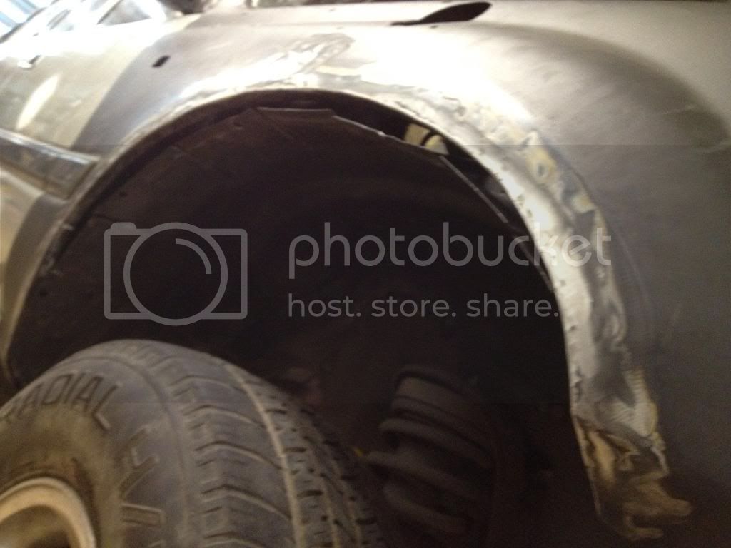

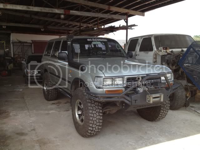

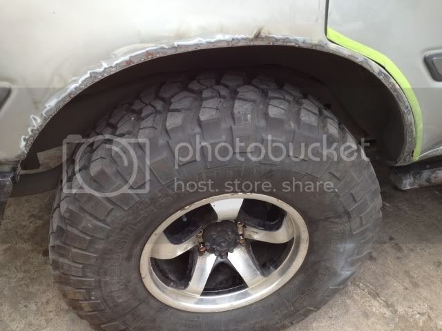

The inner fender was pie cut and filled to match the outer fender. The outer fender has a strip welded to the edge to match the inner fender.
5mm rivets were installed on the lip, and button head bolts tie both together.

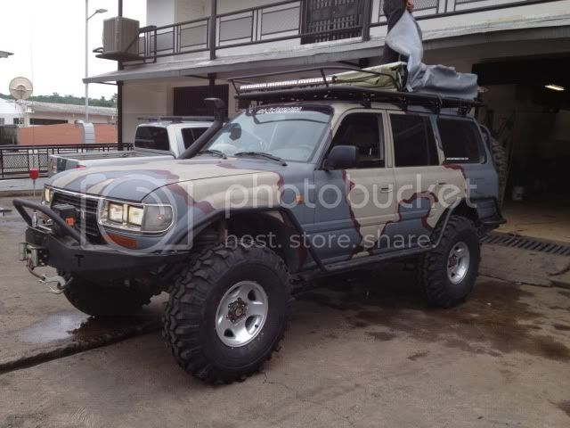

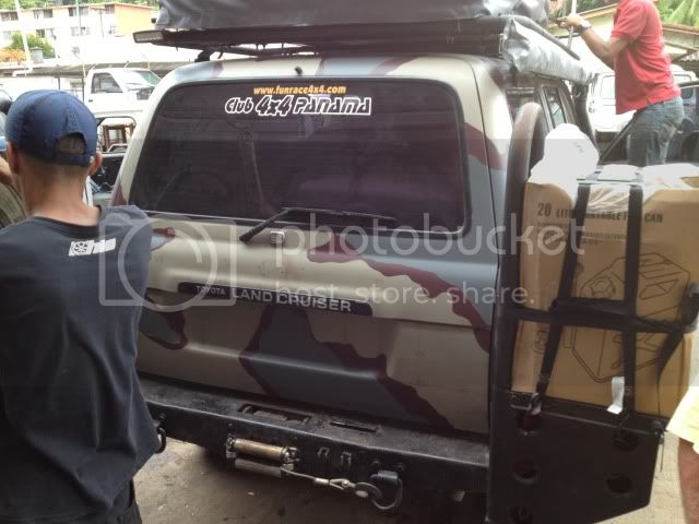

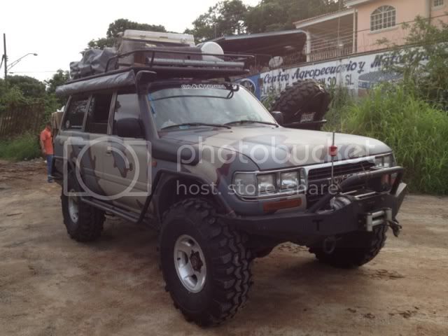

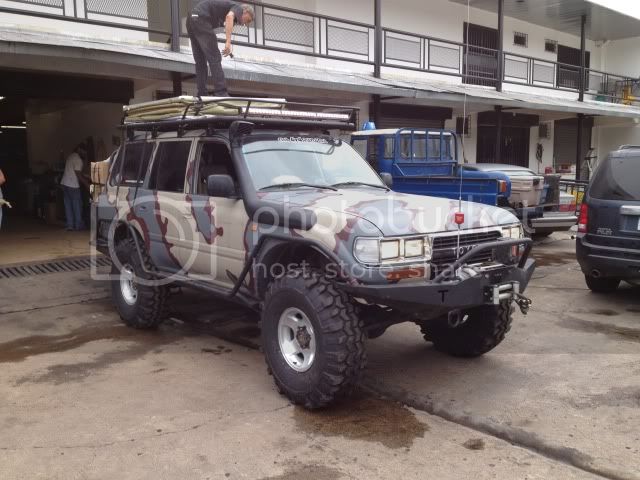

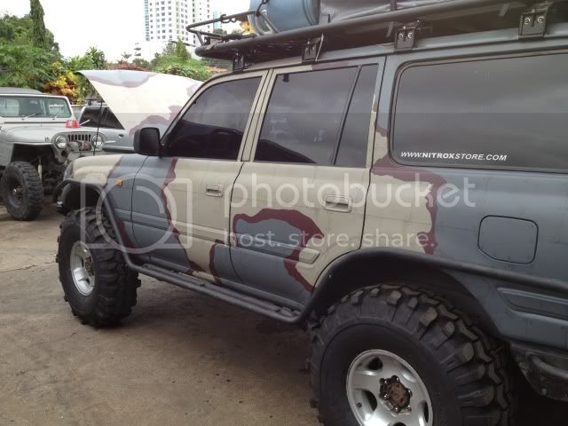

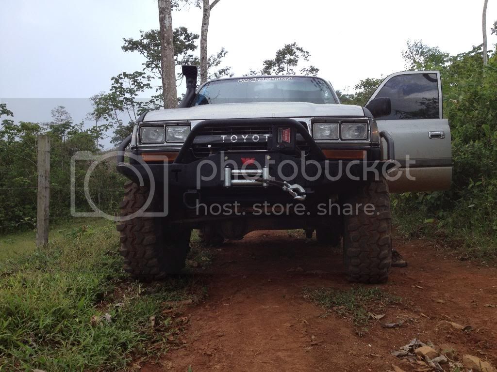

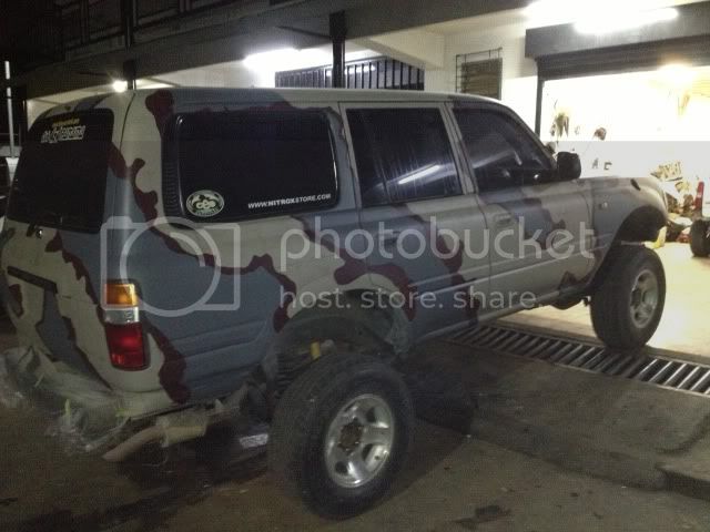

People say i stole the paint job from Iceland, But the truth is i hadn't even seen that truck till after i painted mine. I admit i stole the paint job from these guys…

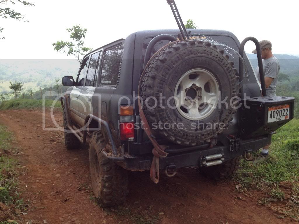

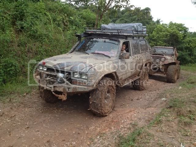

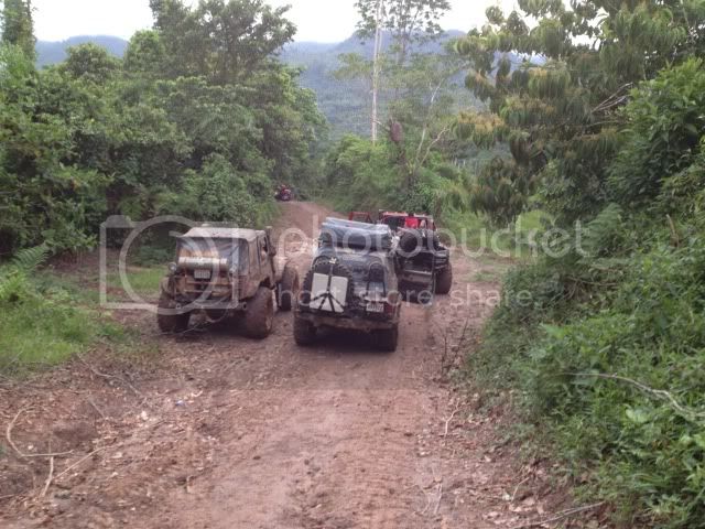

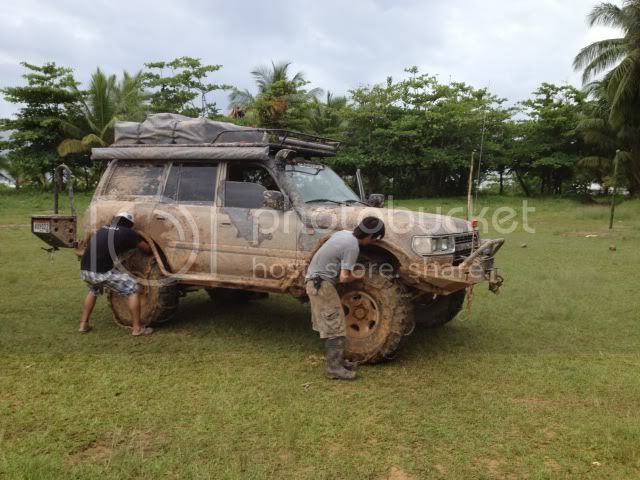

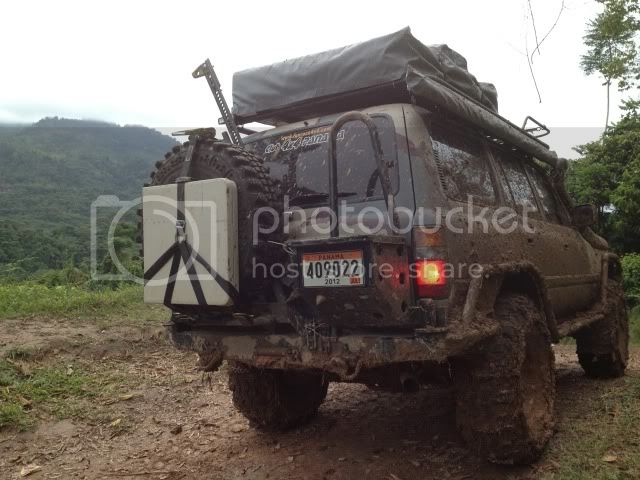

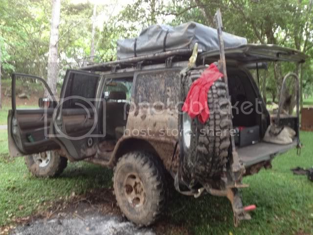

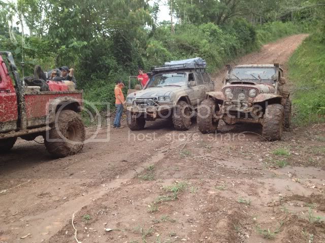

Pics of the first hardcore trip. 700Km round trip. About 120 of those off road.
My 80 makes a 1 ton jeep on 43's look small

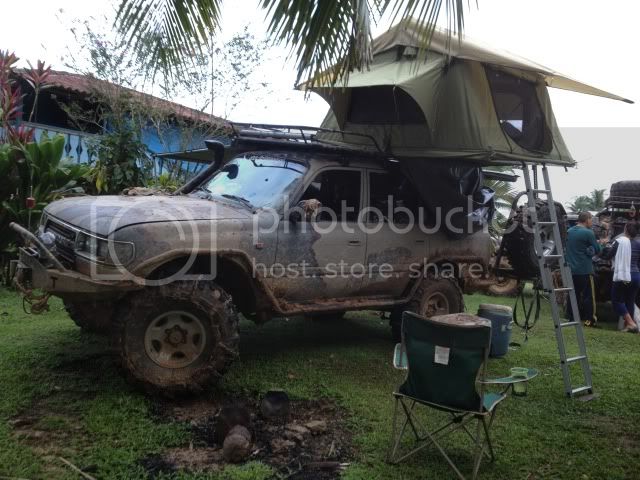

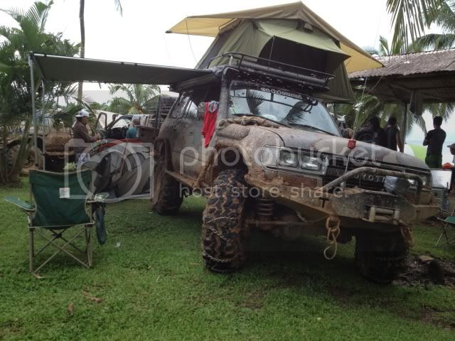

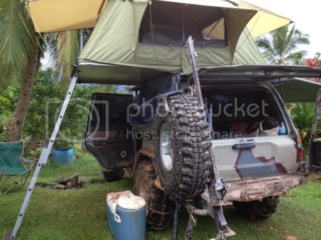

Camping in style
Proof we made it from pacific coast to atlantic coast and back.

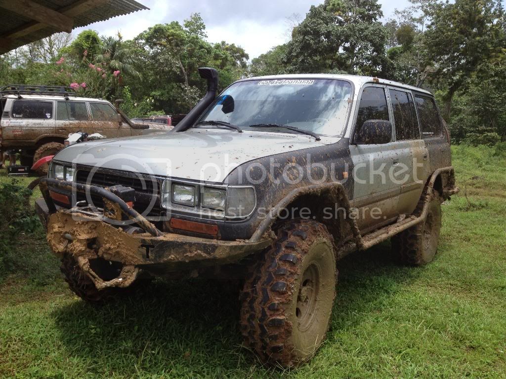

virgin jungle

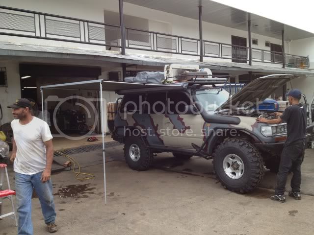

Camo matches up good.

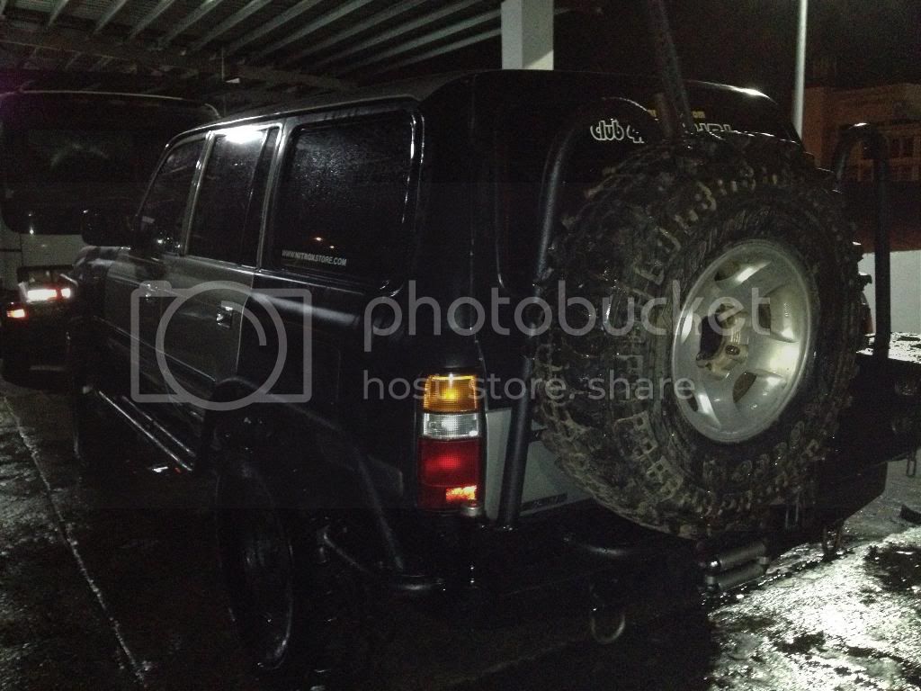

Chains a must
Needs a week long carwash
