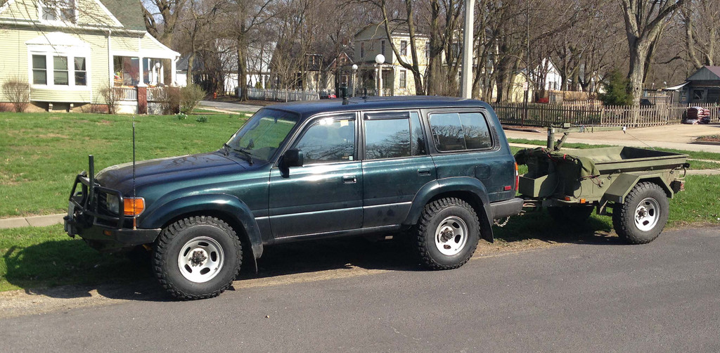

Another thought after getting a set of new tires and an alignment...
The previous tires had a pair that were on the front, I neglected alignment and they were a mess. Thought my diff was going south or something. Then the diff gasket started leaking, seemingly confirming my shoot from the hip diagnosis.
Took it into my pro mechanic ( Eric at Specialized here in Urbana) - as opposed to me the shade tree mechanic - and he took it for a spin, came back and said I need new tires - and an alignment. I put the front tires on the back and the funky rumble moves to the back seat. Hohray! In the meantime, my mom gets very ill, taken to the hospital and dies without anyone physically present, although the nurses' did an exceptional job of using an iPhone with Zoom, on the day Eric tore into the truck and put new TRE, etc on. We get new KM3s on the way and on the truck today at the alignment shop.
Amazing quiet (as well as smooth). Now, some of that may be in the difference between KM2 and KM3 flavors, but if you'd been riding in our 80 for the last six months, you'd just realized that an alignment could have saved the tires and have made them substantially quieter. What's the wear pattern looking like. Got alignment? Something worth considering, especially if you need new tires or alignment anyway.

Here's a pic of the evil tire that was making things growl and thump.
It was my fault for not paying attention, but it's OK now. It was a zen-like day for me because of everything going on. It just occurred to me that one of my inisghts - freshen truck with nice round tires - was so amazingly quieter. Not that lots of dynamat is a bad thing. But you need good tires and if it's also quieter, then it's all good. Things are smooth and quiet on new rubber and I definitely needed it.
