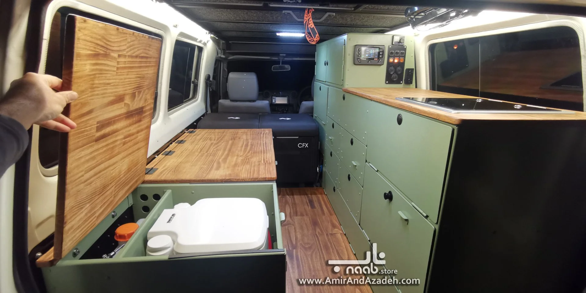

Looks decent. Any idea on the weight?
Thanks the Aluminum parts only all together will add around 120Kg below is a photo of my final installation after powder coating the cabinet,
Also electrical parts all installed from Redarc, then water tap sink and top bench and fridge all in place,
For all the detail of this build see my website posts by this link : OUR OVERLANDER TROOPY - Amir And Azadeh - https://amirandazadeh.com/our-overlander-troopy/
