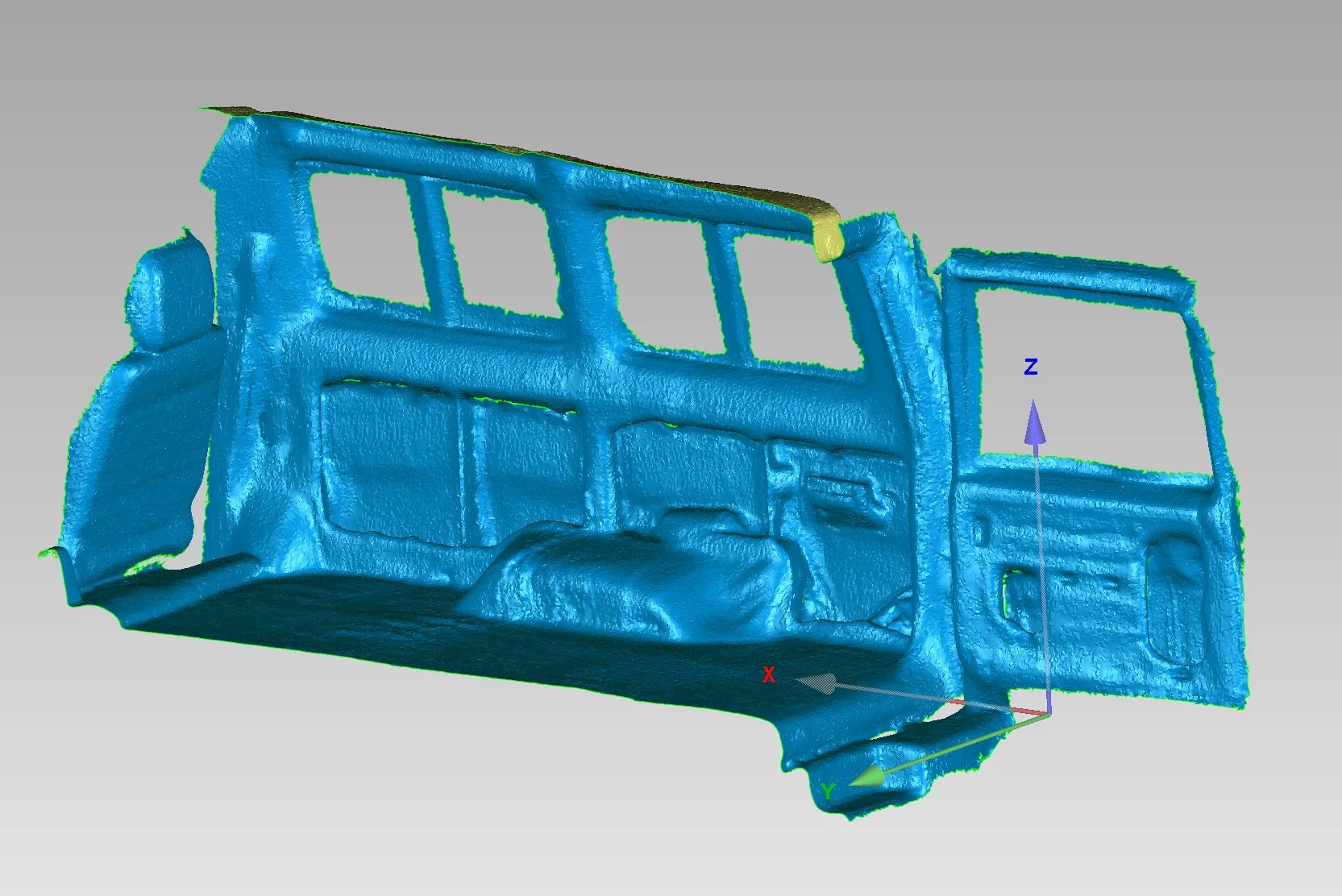

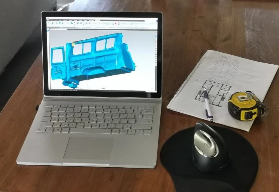

I started to 3D scan the Troopy wagon and product design my needs on it inside Autodesk Inventor software and will inform you about my progress,
So far the 3D scan finished, initial cabinet layout designed and I will finalize the components needs,
Then 3D detail design the aluminum cabinetry to start its laser cutting/folding and welding then assemble our new tiny house on the wheels of the legendary LC78 Troopy

@AmirTroopyNZ would you be willing to share your 3D scan outputs? This would be very useful for many people.
Yes I remember even myself long time ago trying to find a proper 3D scan of a Troopy, but no luck at all,
I think I will be the only first one to share this for all the Troopy fans, so enjoy it guys ;)
Here is a link to download it:
Landcruiser78-Troopy Interior 3D SCAN-No Trim
I separated my scan into two .STL files, LH and RH side to ease up any future design,
both files aligned properly and will be opened in a same global XYZ axis,
Cheers guys 🍻
This is very cool thanks @AmirTroopyNZ .
I loaded them into blender and the align very well. Have you ground-truthed the measurements (scale)? They look correct just want to be sure.
The scale is true and 1:1 also they aligned on the flat floor, XY is corrected too, you may only repoint your zero point.

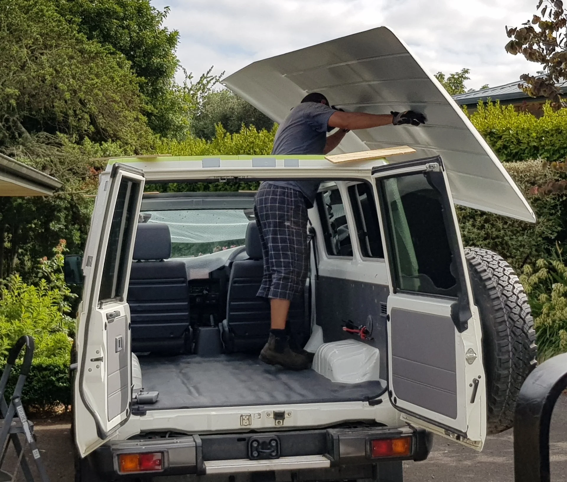

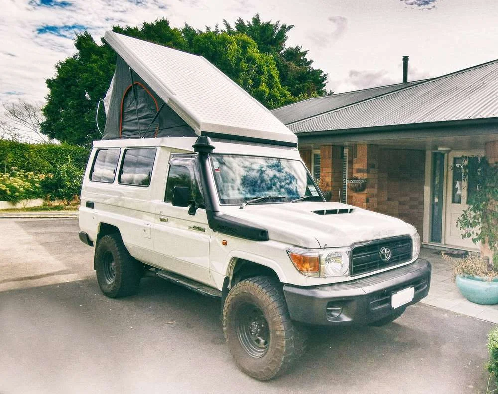

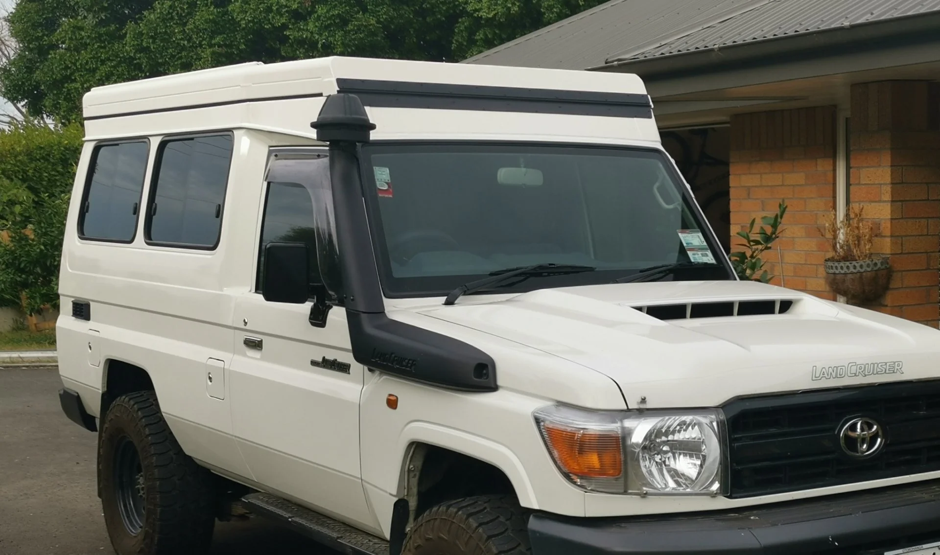

An update on my build,
The AluCab Hercules roof conversion arrived and installed it myself on the Troopy,
I would say is not really hard install and any average DIY tool handler could do it himself neatly,
Main thing is lifting it, either 4 friends help or a forklift will needed to install,
Im happy with the quality and design of the roof conversion kit and have to say Alucab did a good job for this useful kit which is fitting and matching on the body very well,
I have detailed all the needs for this kit installation on our website by below link,
OUR OVERLANDER TROOPY - Amir And Azadeh - https://amirandazadeh.com/our-overlander-troopy/

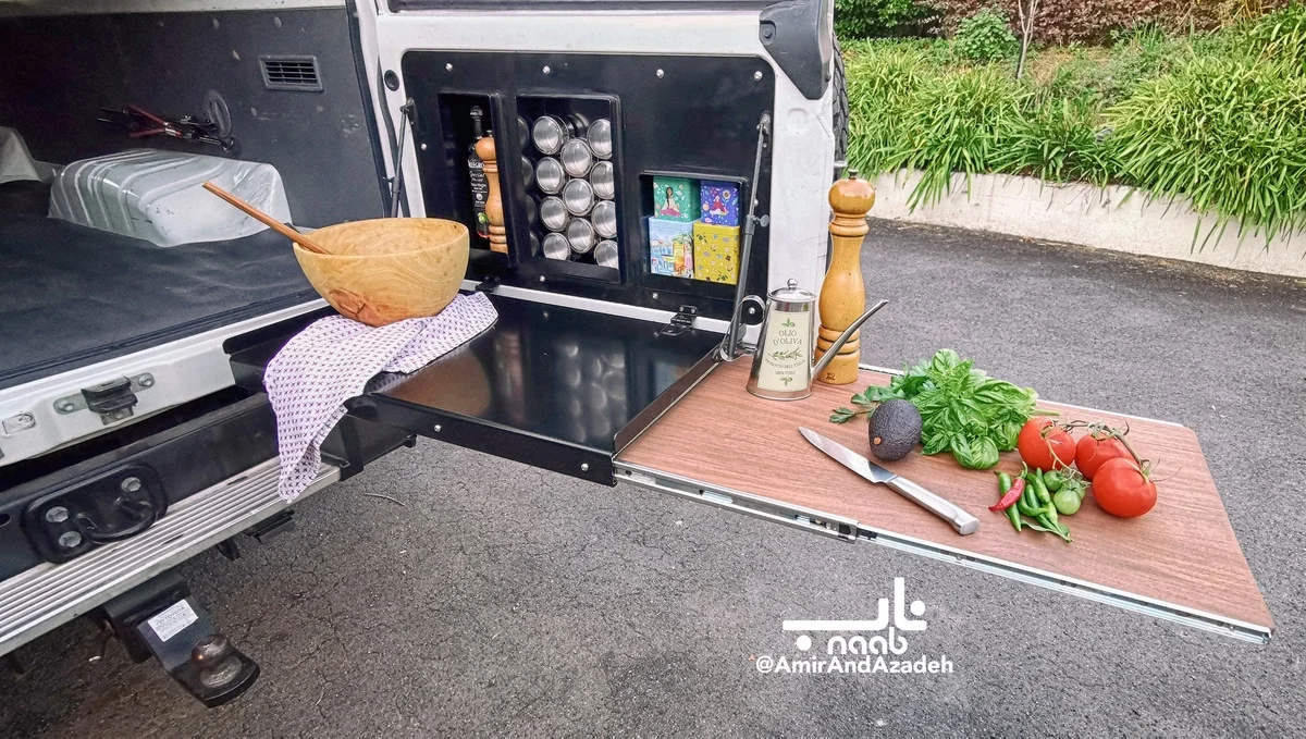

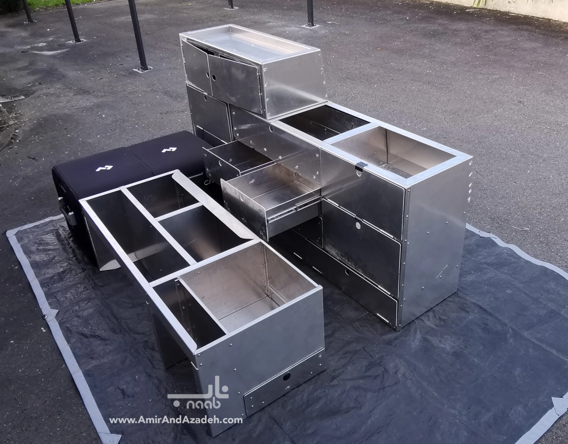

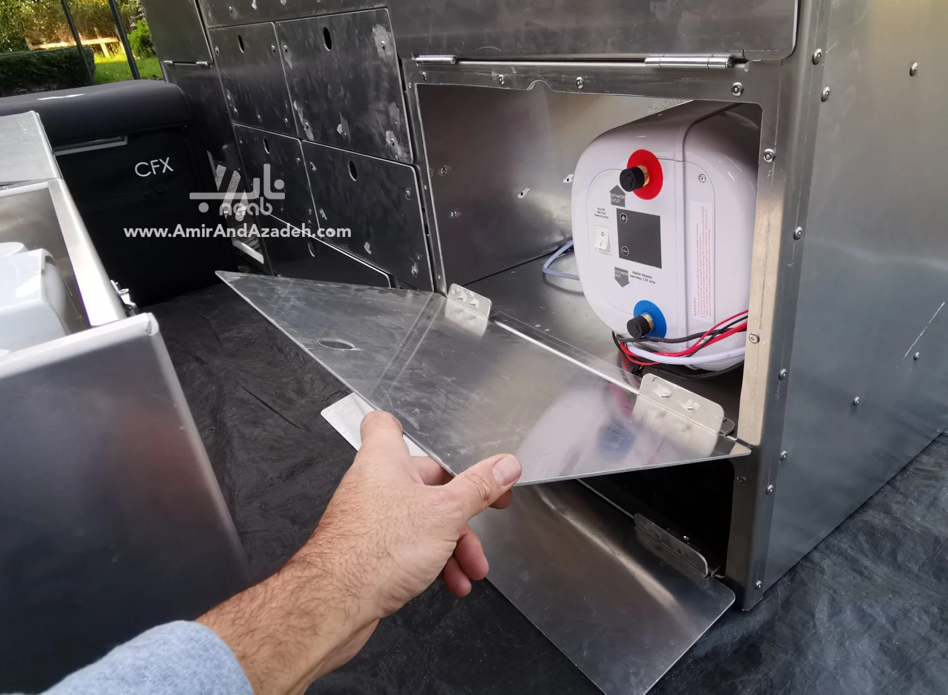

Greeting all, finally my Aluminum cabinet is ready and fitted perfectly in the Troopy,
I made a full detail post with some more videos on our website for anyone interested to get more info,
Also excited to announce that this Troopy Aluminum kit set could be flat packed and sea freighted to your address and easy to fit in a day just by rivet fixing,
If you needed such a cabinet you can send me an email on our website in below link you can have all the details too:
Troopy Interior 3D scan, Cabinet layout and Product design - Amir And Azadeh - https://amirandazadeh.com/troopy-interior-wagon-3d-scan-cabinet-layout-and-product-design/
