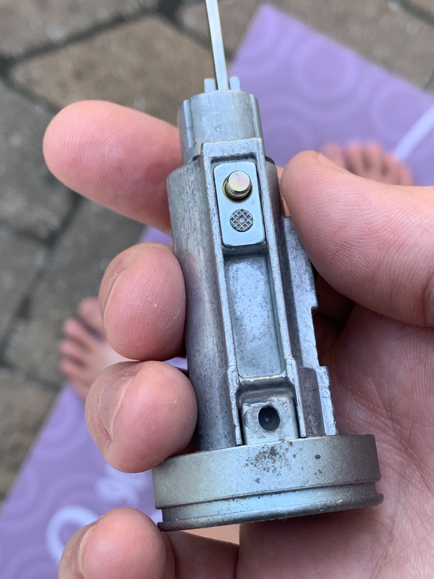

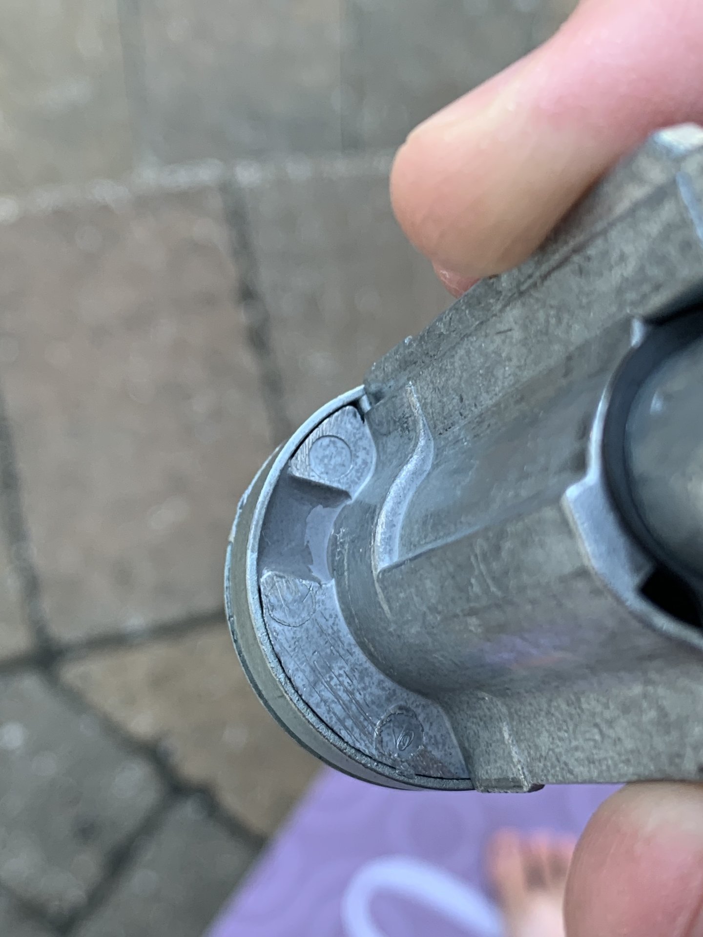

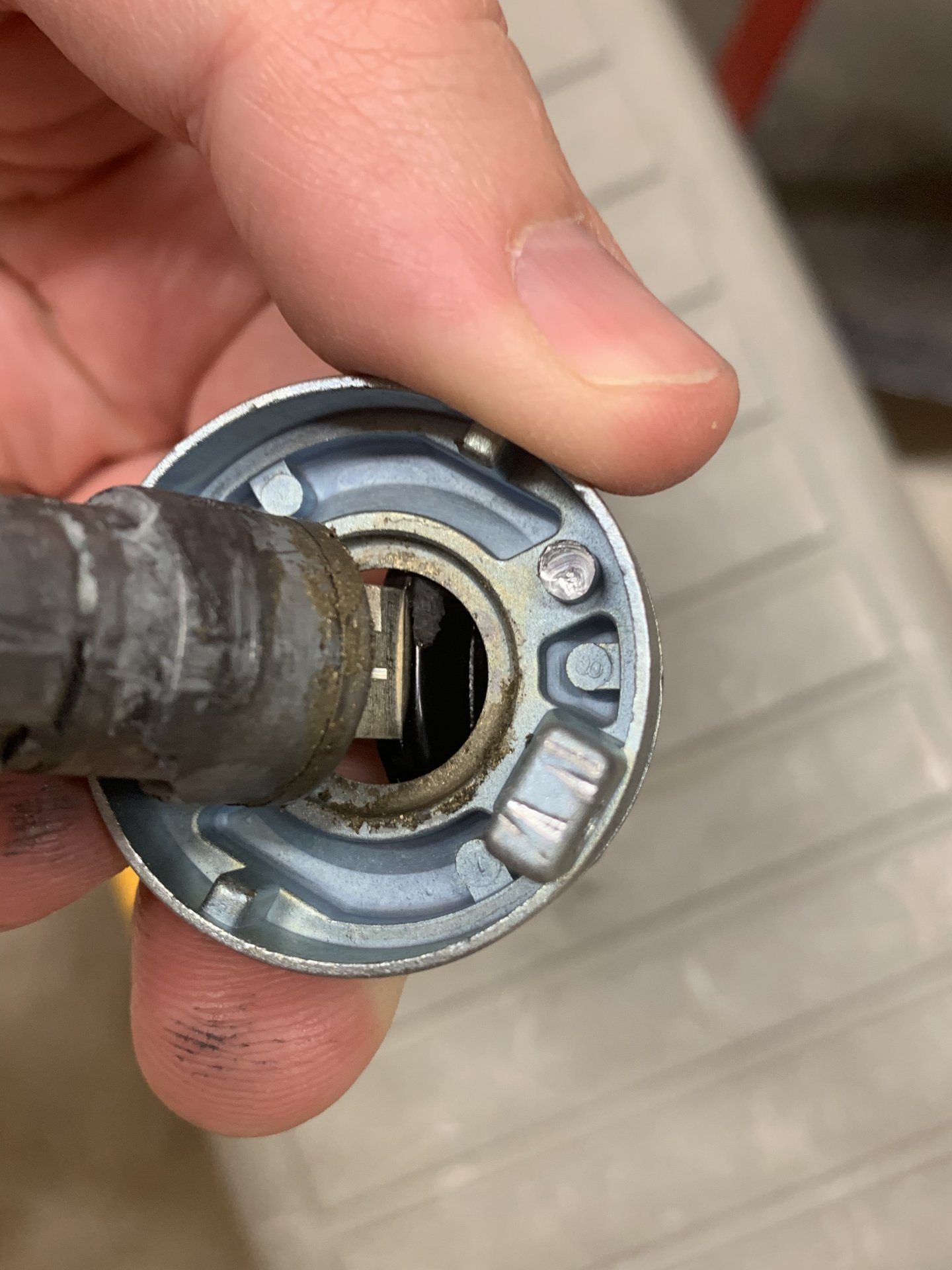

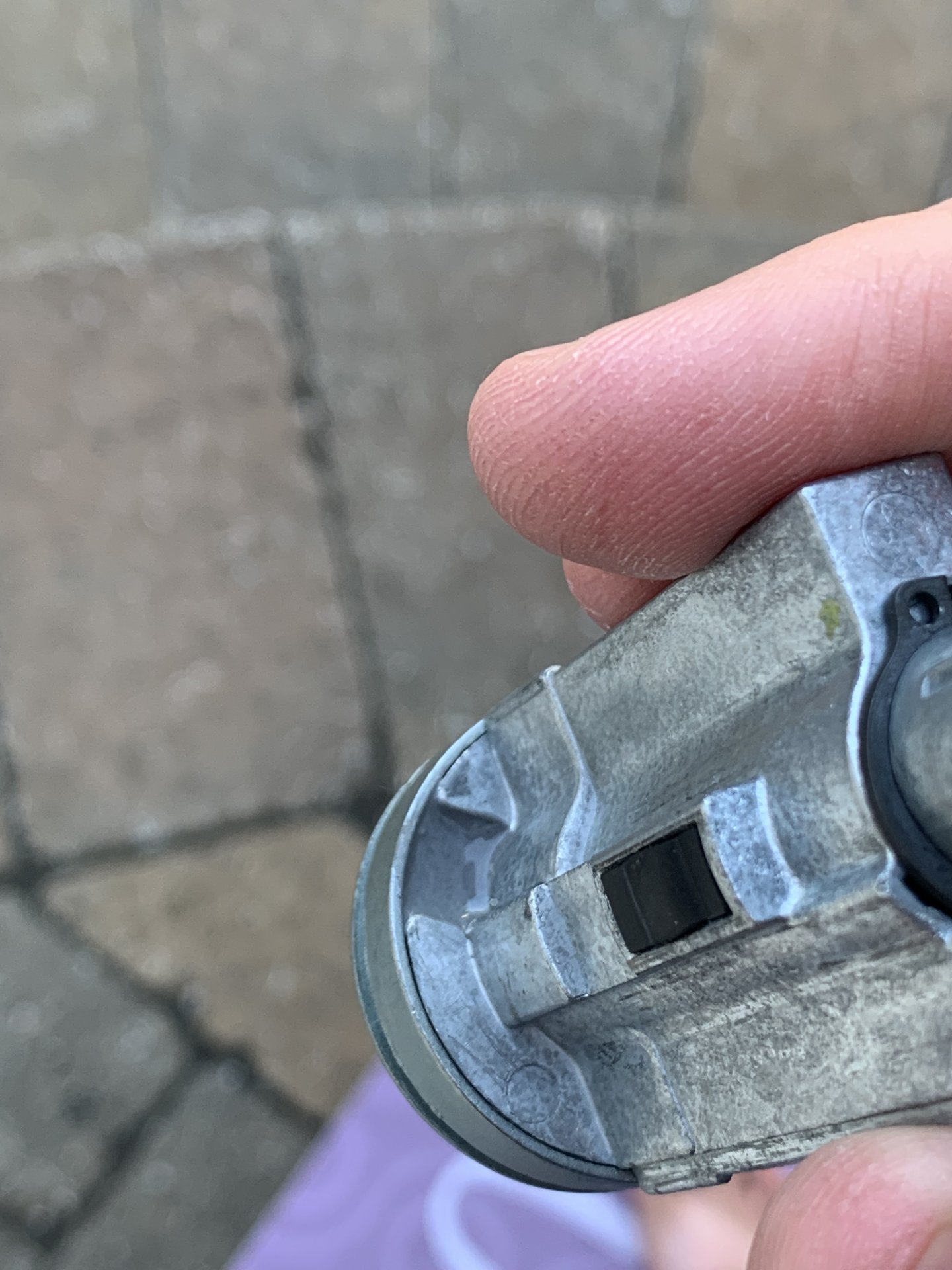

Well I don’t like to leave cliffhangers in threads so I wanted to post an update. No matter how much jiggle/twist/shake/push/pulling I did on this key, it was not coming out of the lock cylinder. I got a pm from @ToyotaMatt that said he may be able to help. He gave me his private number and I FaceTimed him. @ToyotaMatt gave me some ideas on how to try to get the key out, as well as confirmed to me that my cylinder appeared to be the original oem cylinder. We talked for about 25 min or so and he said if I couldn’t get it out he would help getting a replacement.
After messing with this thing for another hour or so I had enough and decided I was going to take the cylinder apart myself. Just to be clear @ToyotaMatt did not suggest this, It was my decision to drill the rivets out of the cylinder and drill out the top pin on my own. At this point I figured I would need to buy a new cylinder anyway. Below is a pic of the two side rivets I slowly drilled out. After that, I drilled, very slowly the top pin out (2nd pic).
After that I was able to gently pry off the front of the cylinder cap. The core then slides out. Mine was very gummy. I could tell some of the pins were sticking in place (3rd pic). After I got it apart I could push on the pins and release the key. I cleaned the entire thing with brake cleaner and an old toothbrush and made sure all the gunk was out.
Continued below..

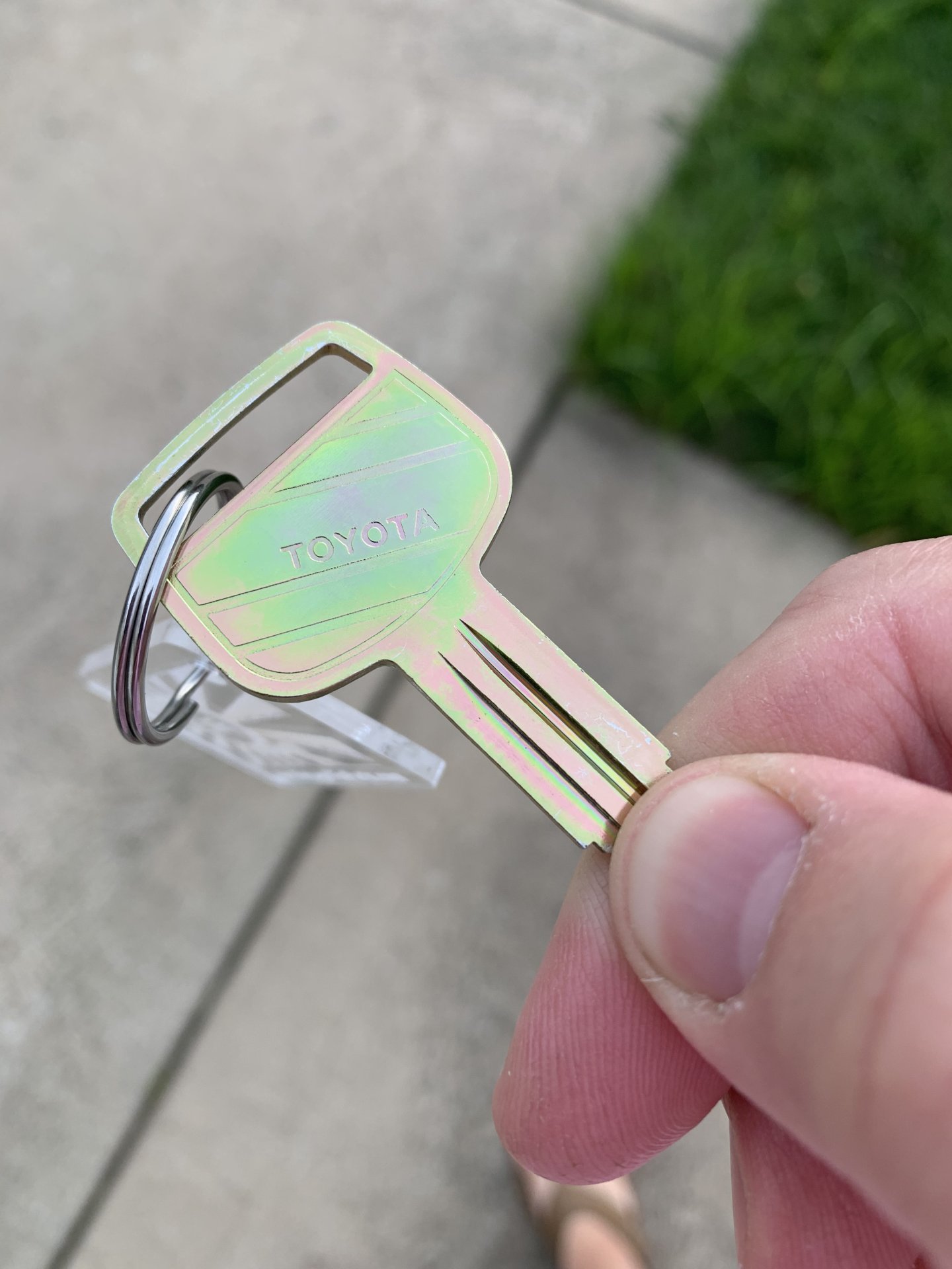

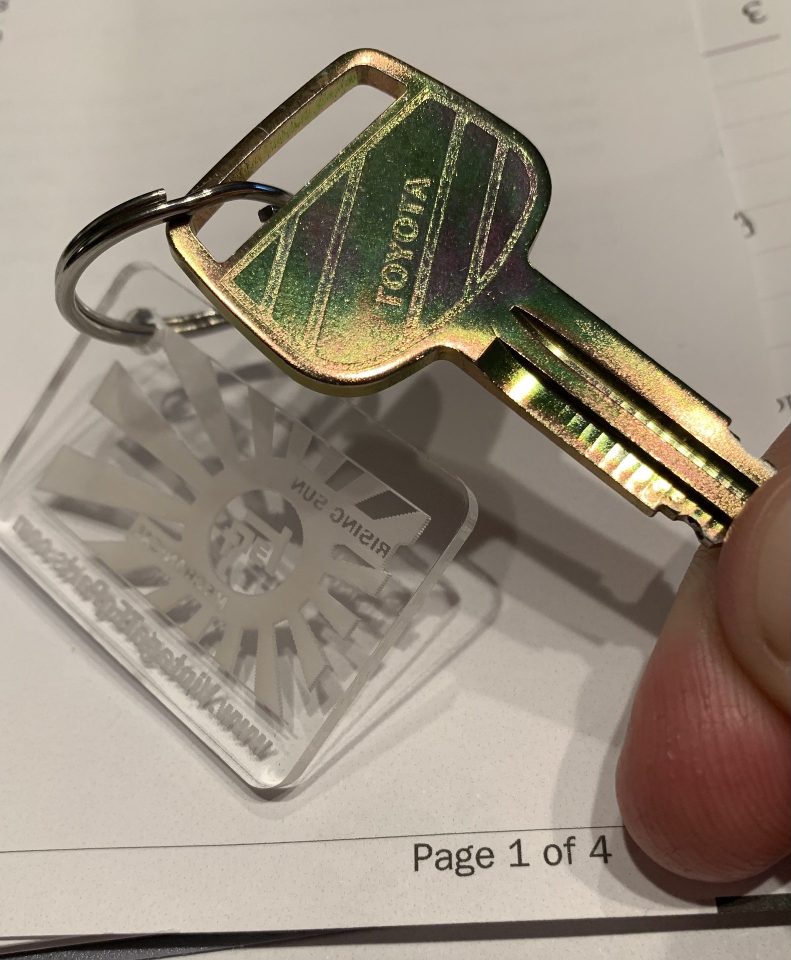

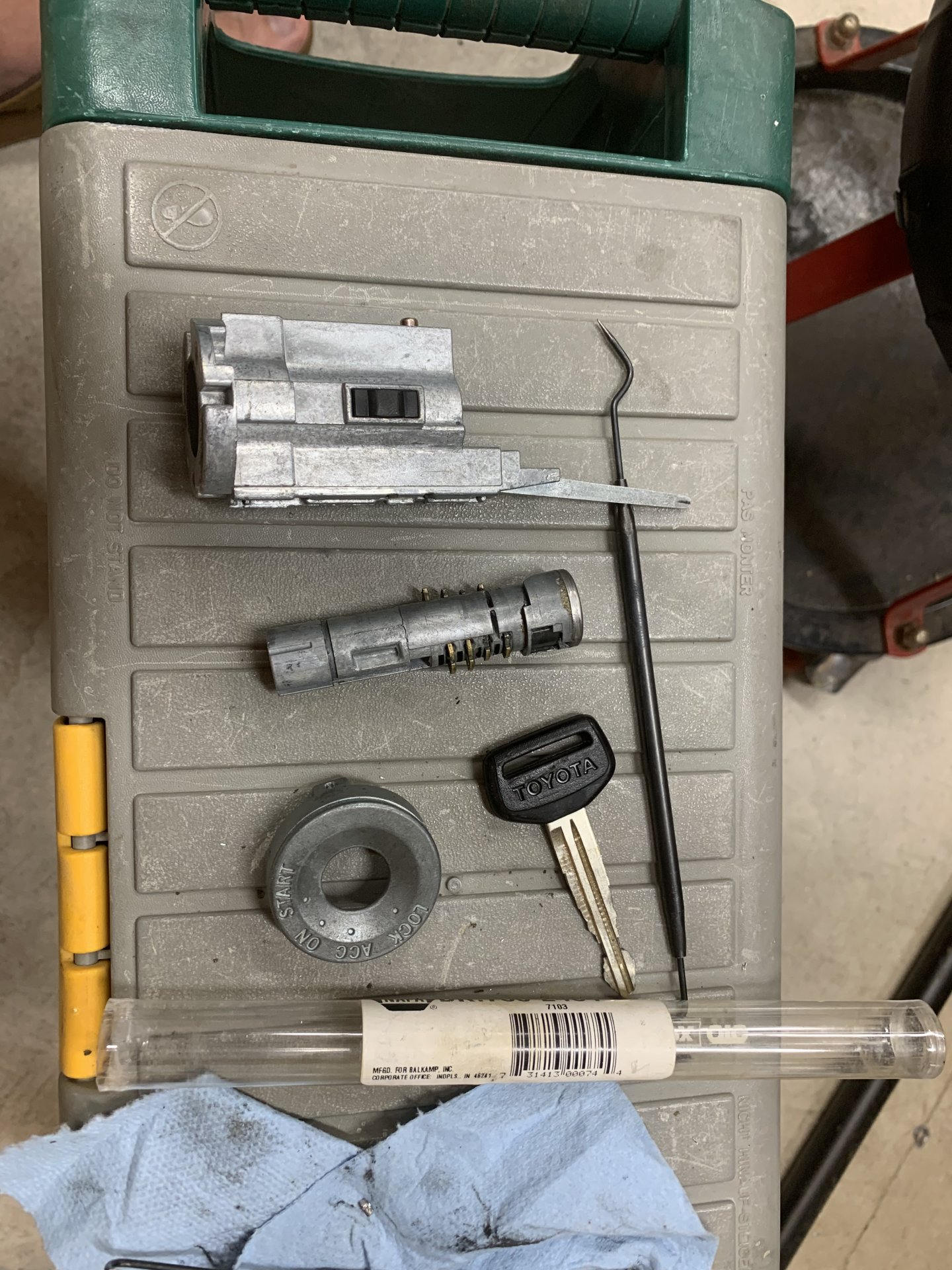

After cleaning this thing, I had a dilemma, how was I going to get it back together? These cylinders were never made to be taken apart. I decided that since the cap on the front was pretty tight, I would mix up some JB Weld and glue it back together. This seems to have worked well. I let it cure for 24hr before touching it. Here is what it looked like reassembled. I sprayed a lot of wd40 in the cylinder and my original trace copy key was working again. It wasn’t smooth but worked with some jiggles. Now I still needed better keys that truly matched the cylinder code. I was skeptical that someone could have rekeyed the entire car.
After calling multiple dealers around me to get a key made, one said they had a blank and maybe could cut it. I had to go in person to get the original key code from Toyota (which is a W series code). That dealer said they have new key code cutting machines that don’t handle the old codes anymore. Then I called @ToyotaMatt.
@ToyotaMatt was able to cut a key with his Nippon Denso OEM SST computerized code cutting machine. He provided me with this beautiful zinc plated Code cut key. Rumor has it that I may have the first “gold” key to an 80 series. Anyway the key works perfectly. No jiggling, no dragging as I turn it. It’s perfect.
A big shout out to @ToyotaMatt for talking with me on the phone and providing a service the dealer couldn’t.
You indeed were the first Carbon Based life form anything 80 SERIES owner operator to be anointed via a GENUINE SKUNK-WORKS GOLDEN Key in
anyway , and that is solid PHOTOS or is does not exist fact i concur with 100% ... :D 🍻 :popcorn:
sure others followed suit , but they were NOT owner operator ZERO , you were and that matters to me ,
THANKS !
below are all images of YOUR golden key of POWER !

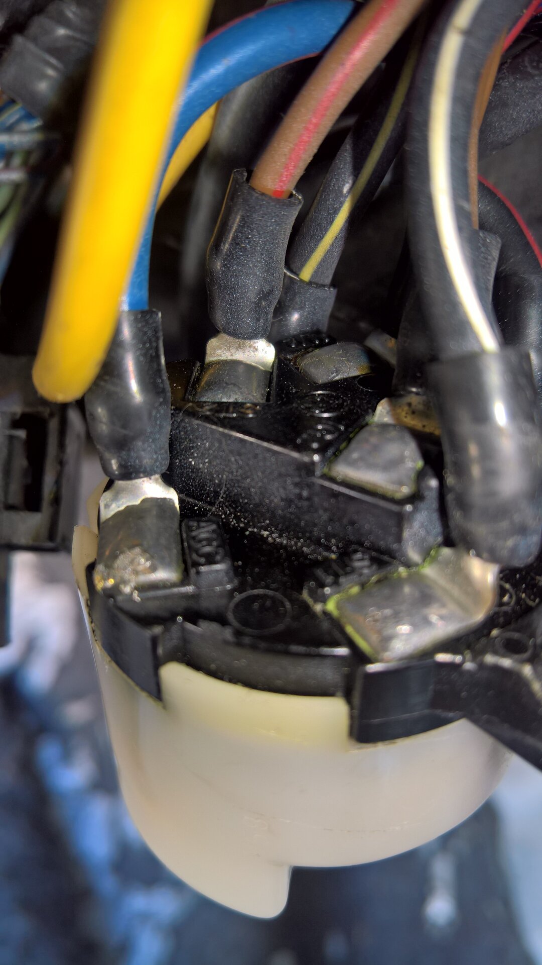

Bringing this back to post up a potential problem I discovered if you drive the vehicle using just the ignition switch while it's disconnected from the upper bracket. Wanted to keep it all here instead of starting a new thread as it's related to the original topic.
So for a week or so I've been driving my 96 FZJ80 with the ignition cylinder/bracket all apart due to the broken rod inside the bracket
and using a screwdriver to turn the switch as discussed earlier. Just been too busy to put it all back together yet.
No problem right? Not quite, found one.
Long story: the wires on the backside of the ignition switch (the electrical switch, not the lock cylinder) have bare soldered connections that are not covered or protected. This is difficult to see unless you pull the switch out (there's not a lot of slack in the harness), I took photos in order to see what was happening.
So then with the switch dangling close to the metal upper bracket (see photos) all it takes is a random event, pull the switch too close to the bracket and the bare soldered connections can make contact, then POP and the smoke comes out of the 50amp AM1 fuse.
Toyota probably figured no one would try to start the vehicle in this manner
so no reason to cover those connections. But as we've learned, if that rod snaps inside the bracket this is the only way to start the engine. So there's that.
The first time this happened (two days ago) I didn't see any sparks (or smoke), wasn't sure at first what had happened (discussed with another member),and figured maybe it was just due to the original 27 year old 50amp AM1 fuse having gone through thousands of thermal cycles and some corrosion (green) of the copper strip which might have caused it to blow??
So I replaced that blown original AM1 red fuse with a new OEM (Pacific) 50amp fuse and went to turn the dangling ignition switch (using a screwdriver as before) and POP the new 50amp fuse blew again but this time I saw sparks down by the ignition switch (the lower plastic panel and metal plate under the steering column are both removed).
It wasn't immediately clear (at dusk with an eyeball) that the old 50amp fuse had blown until I took photos and magnified them. The next day I pulled the bad fuse and checked it with a multimeter which confirmed that it had no continuity. Fairly obvious now when looking at the photos.
As usual the photos tell the (shorter) story:
First photo shows the first time the (old) AM1 50amp fuse blew.
Note the green corrosion on the 60 amp fuse (the 50 amp IIRC had that same corrosion before it blew IIRC). To be clear, the 60 amp (yellow) fuse is not blown. Point is, the corrosion makes it a bit more difficult to visually tell if the fuse is good or not. Of course significant corrosion could potentially weaken the copper strip so replacing these fuses every XX years might be another PM (but in this case it was not the cause of the fuse blowing).
Close up of the blown original AM1 50 amp fuse:
Next photo shows new Pacific (OEM) 50amp (red) and 60amp (yellow) fuses installed. (Click the photo twice to magnify so you can see what a new fuse of this type should look like):
This last photo shows the new 50amp fuse which blew the very first time I turned the ignition switch after installing it (magnify for better view). Much easier IMHO to tell (using your eyeballs) when a new fuse is blown compared to an old corroded fuse.
Search terms: AM1 Fuse 50A 50Amp Pacific PAL
And here's the culprit (hint: it's not the switch itself):
Basically the bare soldered wire connections on the backside of the electric ignition switch came in contact with the upper bracket. This happened randomly when I grabbed the loose/dangling ignition switch to turn it using a screwdriver.
Note how the switch is oriented, difficult to see the bare contacts on the backside unless you pull the switch out and down. Toyota likely never figured anyone would try this method of getting the vehicle home so-to-speak so didn't cover the contacts to prevent arcing (or didn't figure anyone would be so stupid creative) ;)
Magnify to see the burn marks when the backside of the switch came in contact with the upper bracket:
This shows the backside of the ignition switch, note the exposed soldered connections with what appears to be marks from the arcing:
Or course, the answer is fix the ignition correctly (replace the rod that broke initially) and put it all back together.
But the point of all this is if you're in the middle of nowhere 100 miles from civilization, power, water, food, tools, parts --- and the ignition rod inside the bracket breaks as discussed by the OP in the beginning of the thread, then the only way to start the vehicle AFAIK is to disconnect the ignition switch from the back of the upper bracket (discussed earlier) and turn the switch with a screwdriver.
So if you find yourself in this situation be aware that you can blow the AM1 50 amp fuse if the bracket comes in contact with the bare wire connections on the back of the switch. Another reason IMHO/IME to carry a spare 50amp AM1 fuse (maybe all the fuses) along with your spare Fusible link bundle.
What I did as a temporary measure was to spray a few thick coats of Plastidip on the backside of the ignition switch to cover the bare soldered connections (forgot that I had a can of red insulating varnish on the shelf).
But anything you could put between the two components should work in a pinch, paint the exposed/soldered connections with Insulating varnish or "Liquid tape", wrap some electrical tape around the wires on the back of the switch or put some tape on the barrel of the bracket, etc,etc. Anything to prevent contact until you can put the components back together.
This was also a reminder to carry spare fuses, particularly the not-so common 50amp Pacific brand fuse that fits in the AM1 position. None of my local auto-parts stores carried this fuse, I did order a couple from the local Toyota dealer however.
Here's a link to a good thread from long ago discussing Troubleshooting including Fusible Links and Fuses:
Here's a photo of the backside of the ignition switch after spraying multiple coats of Plastidip on the exposed contacts. If I replace the switch I may apply a few coats of Liquid Tape or Insulating Varnish on those soldered connections before I install it. For anyone who doesn't know, Insulating Varnish is that red coating you see on electric motor armature windings.
FWIW: Spray On makes a few different types of insulating varnishes, Clear, Red, and Green with slightly different specs related to high voltage (dielectric strength).
