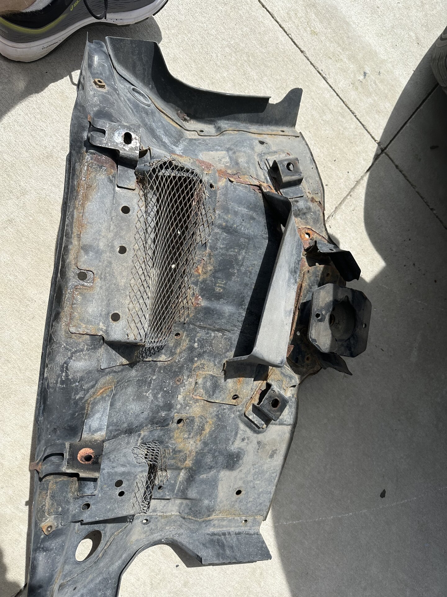

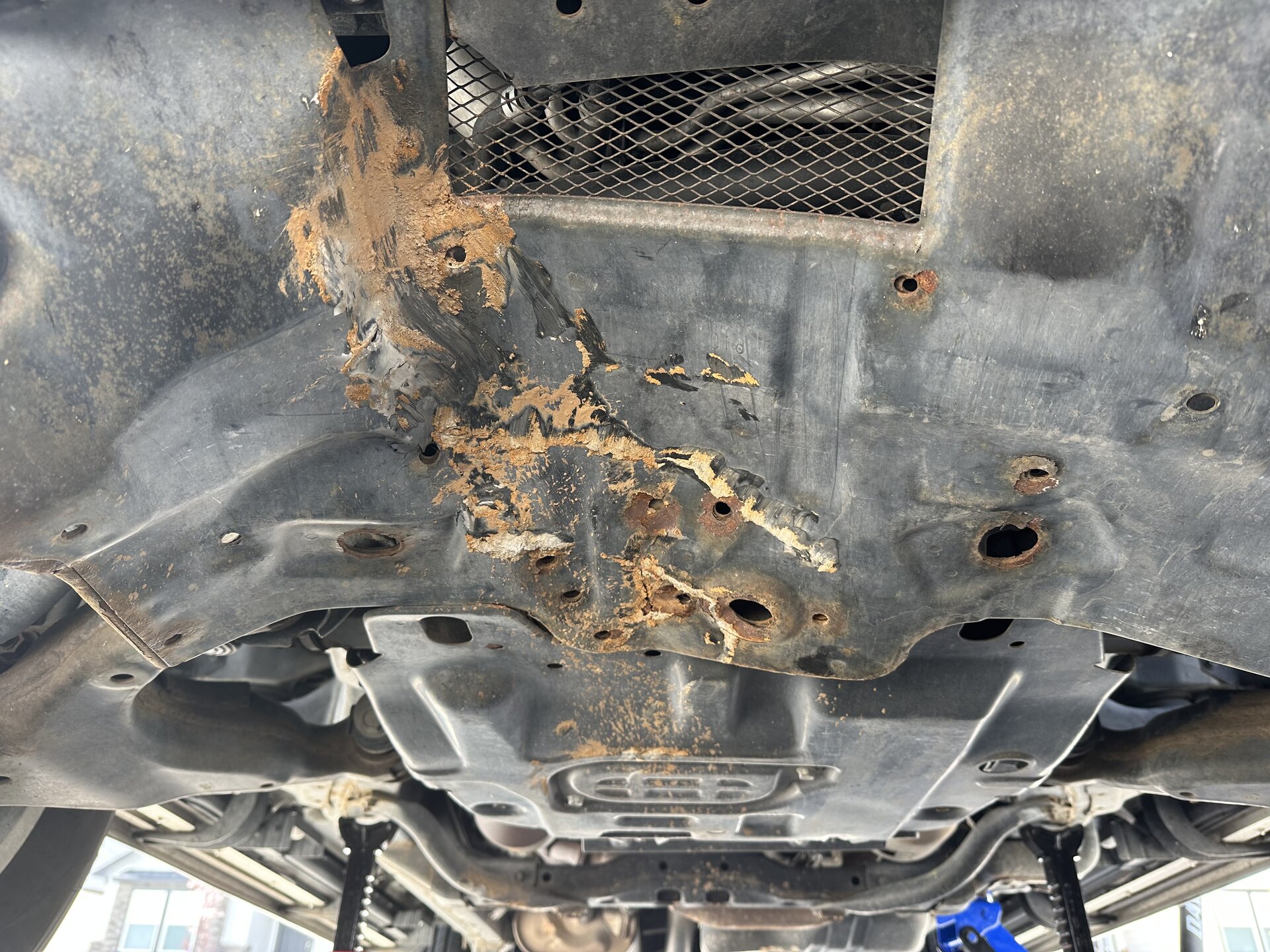

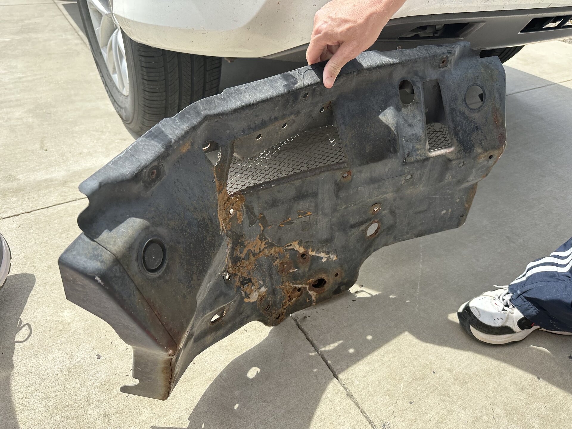

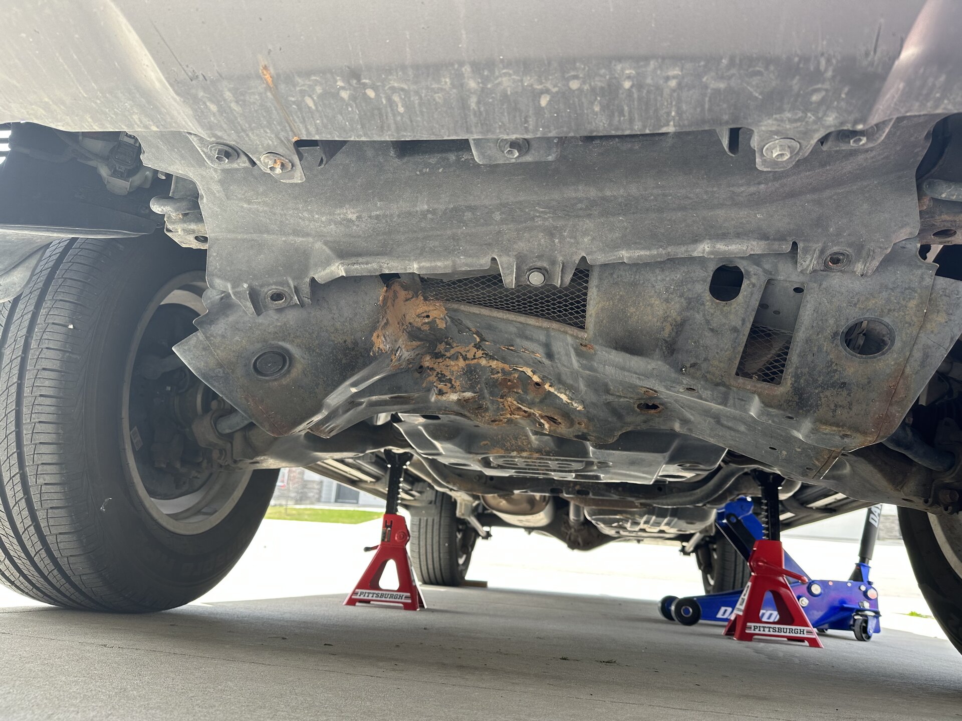

The factory skid plate took everything. And man did it it take it. After a long day and night of driving I make it home, zero issues (thankful as all heck). Next morning I come out to check the damage. I can’t help but laugh. Dang that skid plate did it’s job. Saved my night, saved my GX, saved me.
I’ve posted some photos of the skid plate as it hung on the vehicle. Took the skid off the next day, and again couldn’t help but laugh the whole time. This steel plate is TACOED.

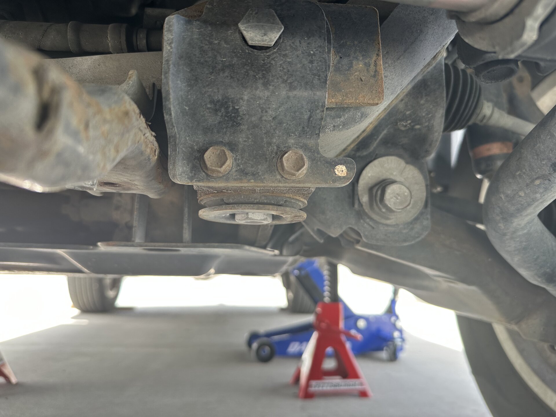

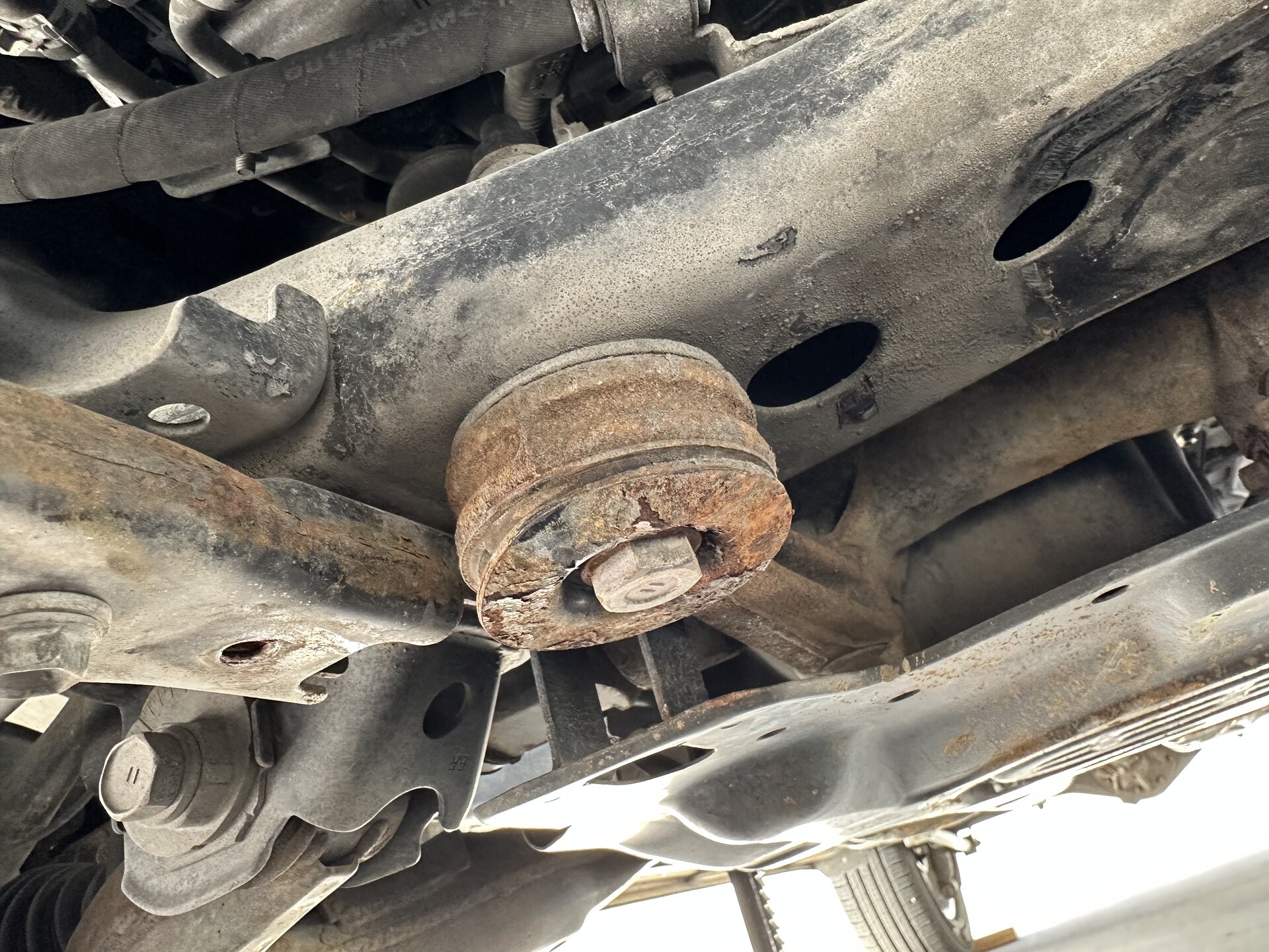

There was a very slight concave on one frame member which I’ve posted as well, and a tiny amount of damage to whatever the circle thing is. But everything is fine.

Did that rip the steel around the bolts? Break the bolt heads off? Or bugger up the threads on the captive welded nuts?
