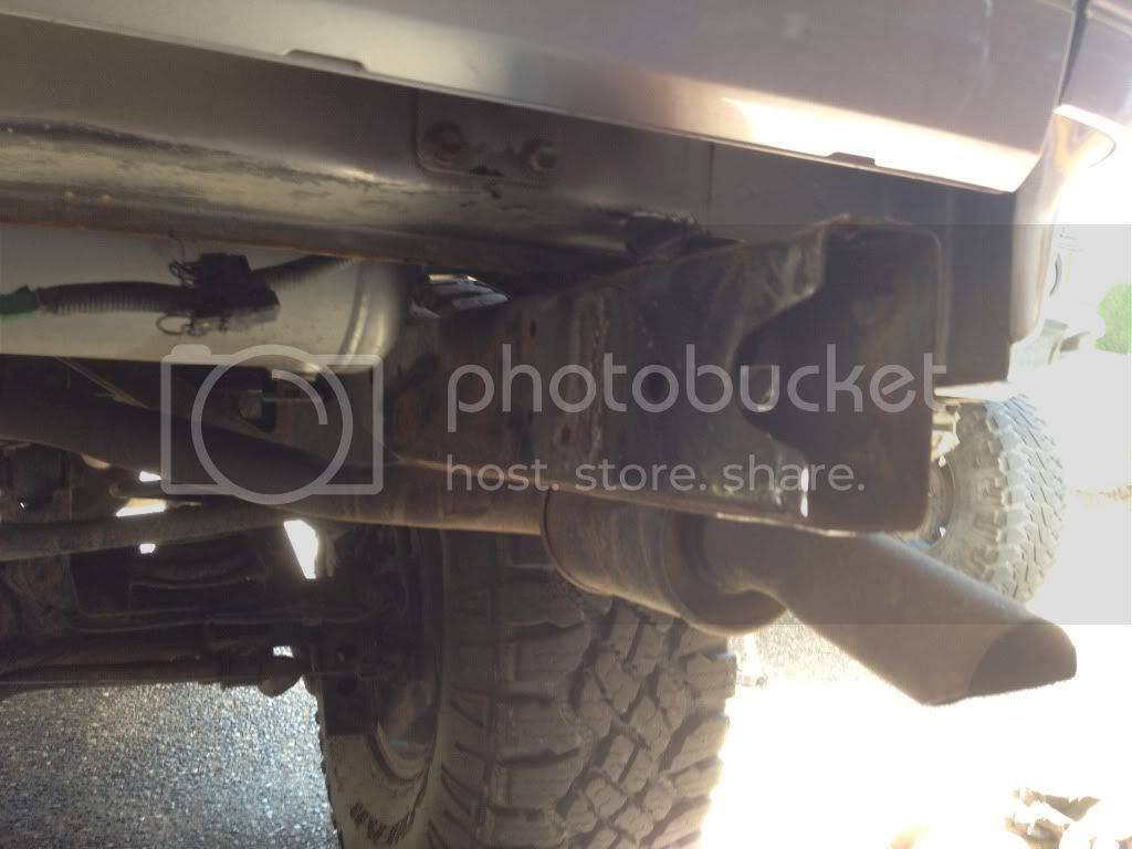

So I started by removing my rear cross member, it was badly twisted and dented from the PO and her tearable driving record.
Frame cleaned up.

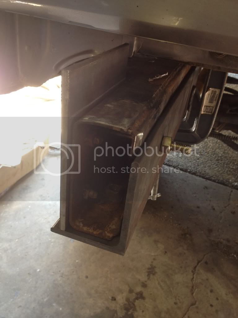

Testing Brackets.
Looking good.

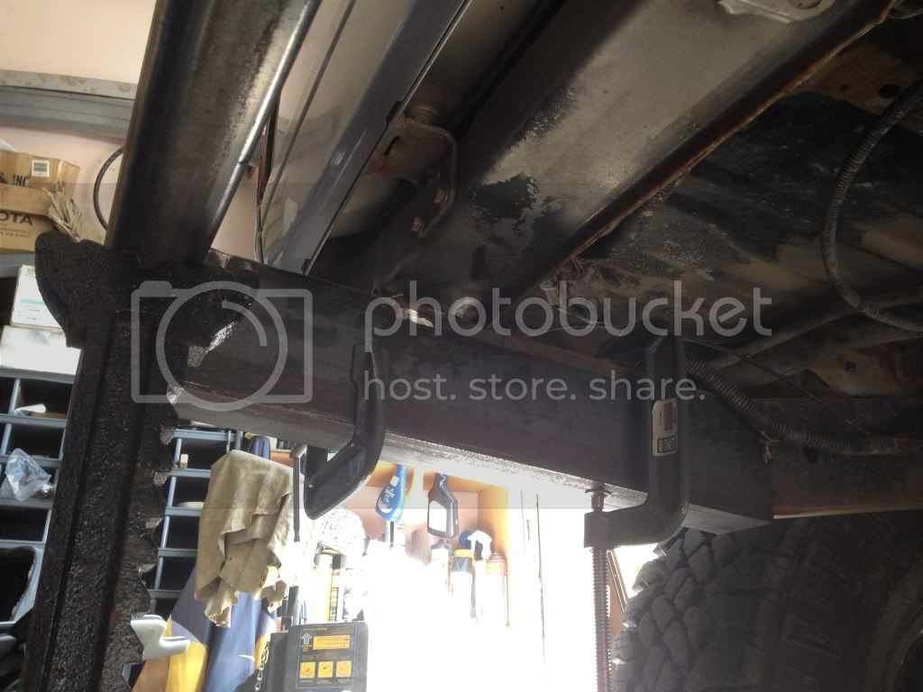

Test fitting again.
Good Strong attachment points.
That's the end of day 1, I did hold everything in place with a few spot welds and sorted out how and where the recovery points would end up but ran out of time.
A note on the materials, the main beam is 4x2 tube with 3/16th wall, the frame brackets are all 1/4" plate and the L piece is 4x3", the side wings are all 3/16th plate and its tied into the frame to make a boat side for lots of protection.

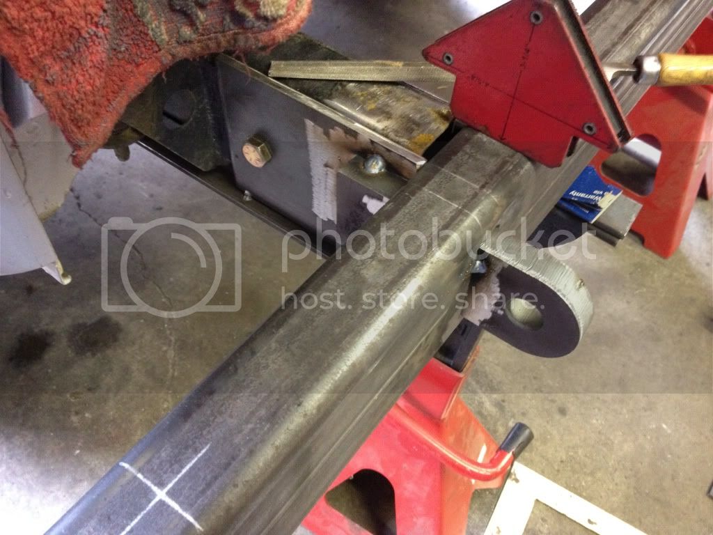

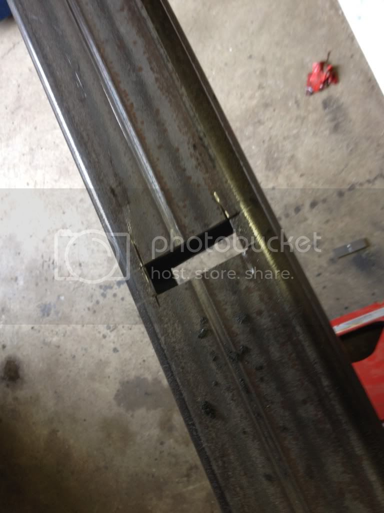

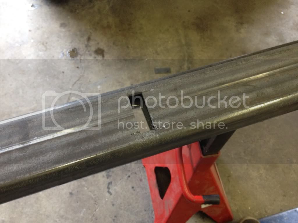

Started by cutting the holes I needed for the recovery points. Took me a wile to figure out how this was going be done but it worked great in the end.
One more because I was happy how it turned out (20min total to do it not so bad)

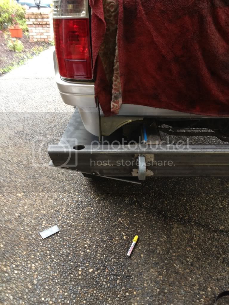

Back on the truck with the recovery points.
Tacked into place.
Yep once this is finish welded it will be beefy.

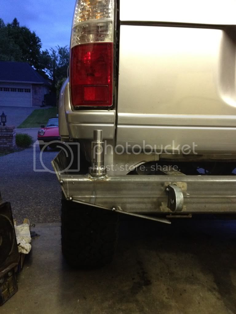

Jumping ahead about 5 hours here, in the mean time I measured and drilled the holes for my carrier pivots as well as started trimming the sides to work with the plate I wanted to use. This has been by far the hardest part of the build. Myself and my dad spent a good 4 hours testing and re testing parts to try and make it work and look right. We are still working on it. The issue is the lines do not match between the frame rail and the rear body so it puts everything off. We are still working on this parts and trying to get out heads around it.
Here are a few pictures to show what we are trying to accomplish.
We did have the upper side piece in for a bit but that is not in the pictures.

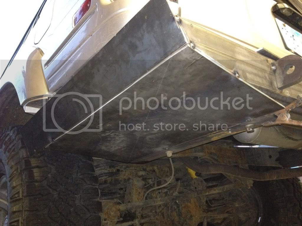

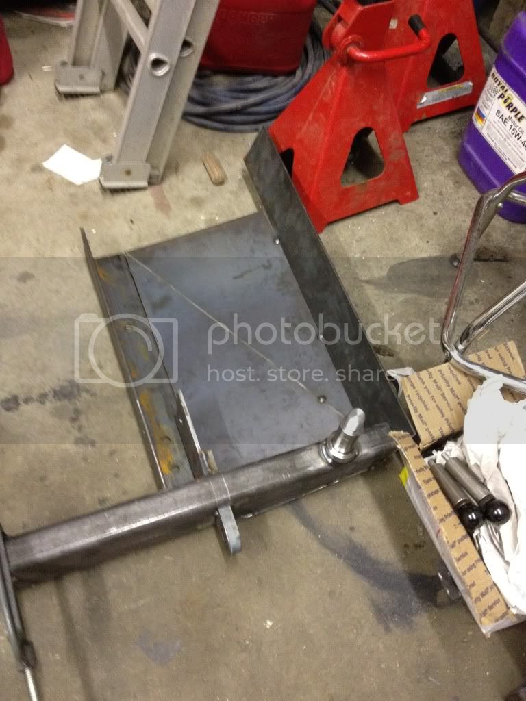

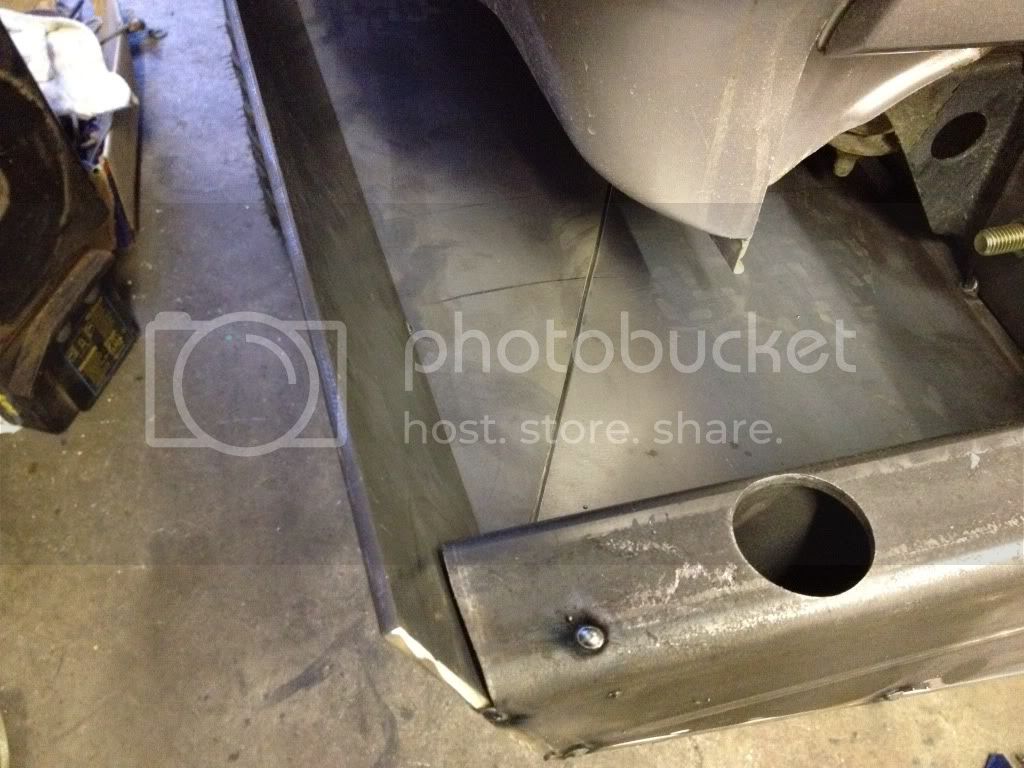

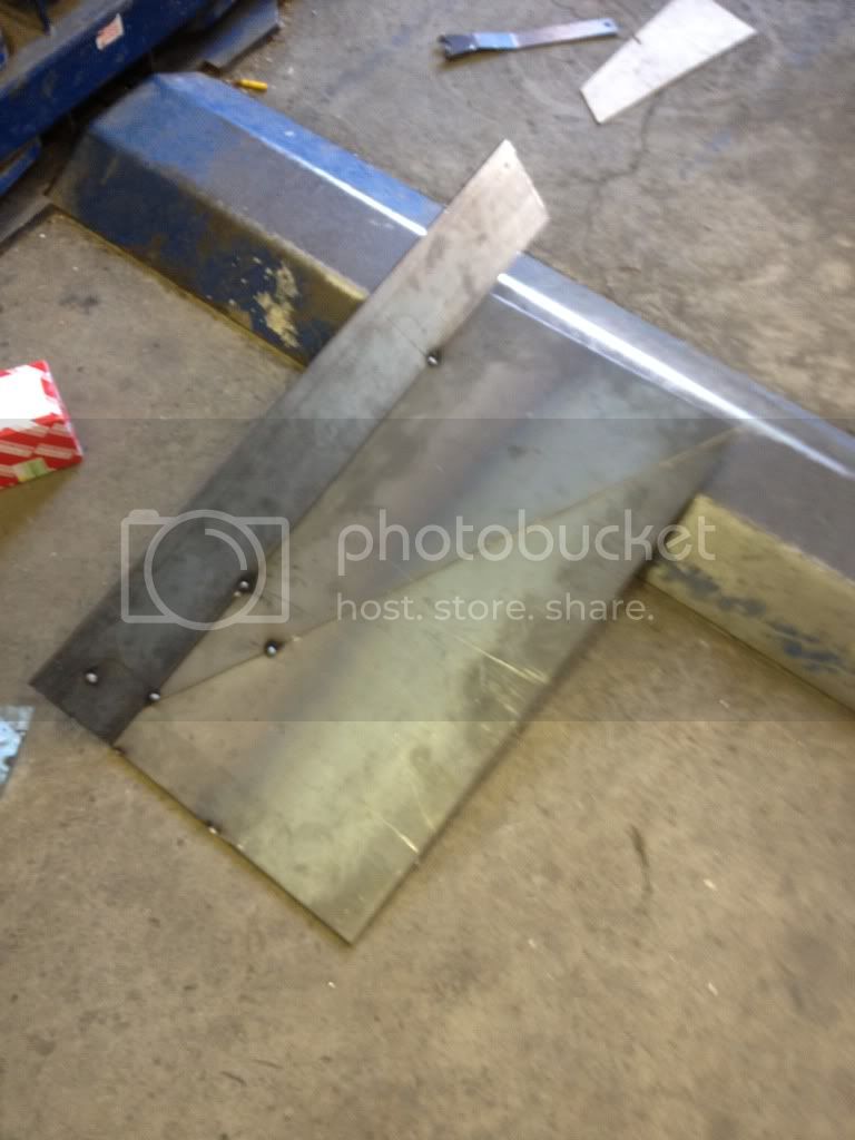

Day 3 (last night after work about 1.5 hours)

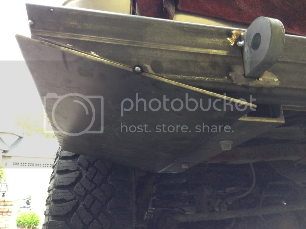

Really wanted to get the design of the side wings sorted out before doing anything else. I had an idea that a simple bend across the main plate would get me where I needed to be. So I measured and looked at it and decided to try bending the 3/16th plate (12x24") so I took a cutting wheel and made a cut about 2/3rds the way through the plate along the bend line. I was then able to bend the plate to the desired position and it worked a treat!
With the limited time I had last night I did not take pictures as I went just once I had it done.

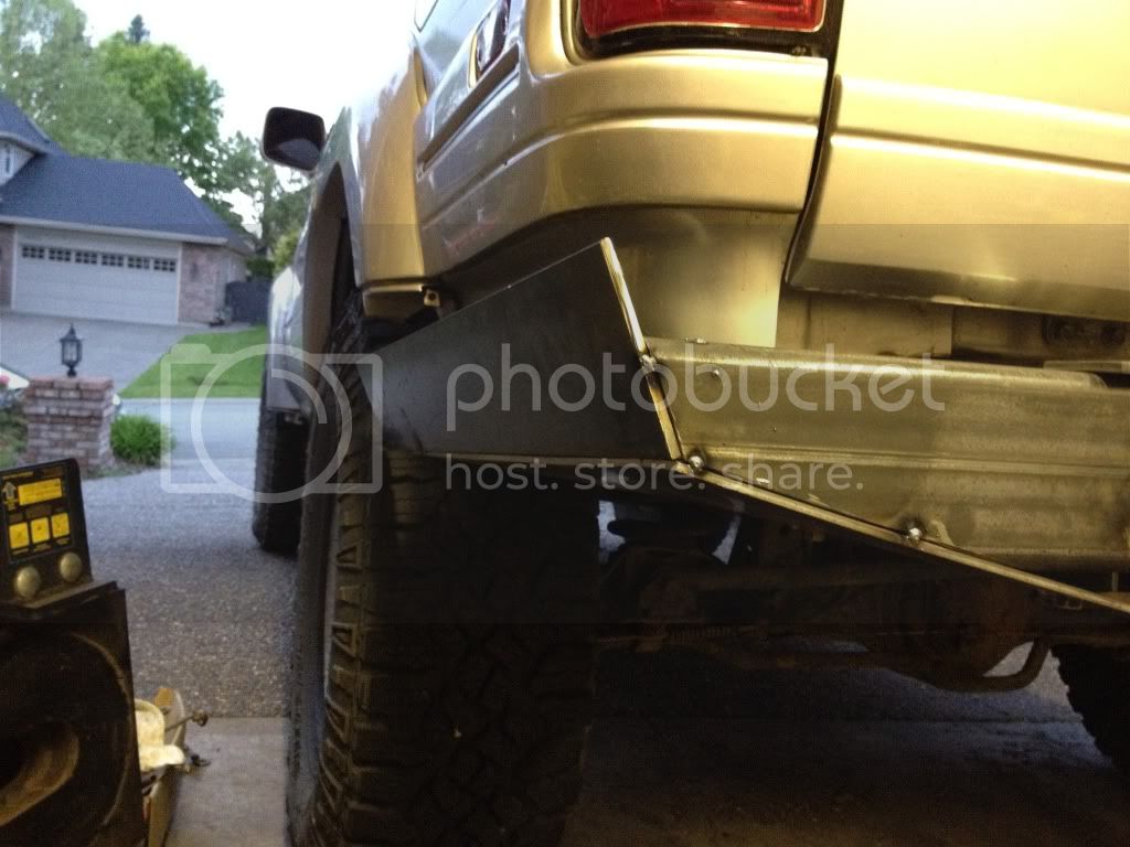

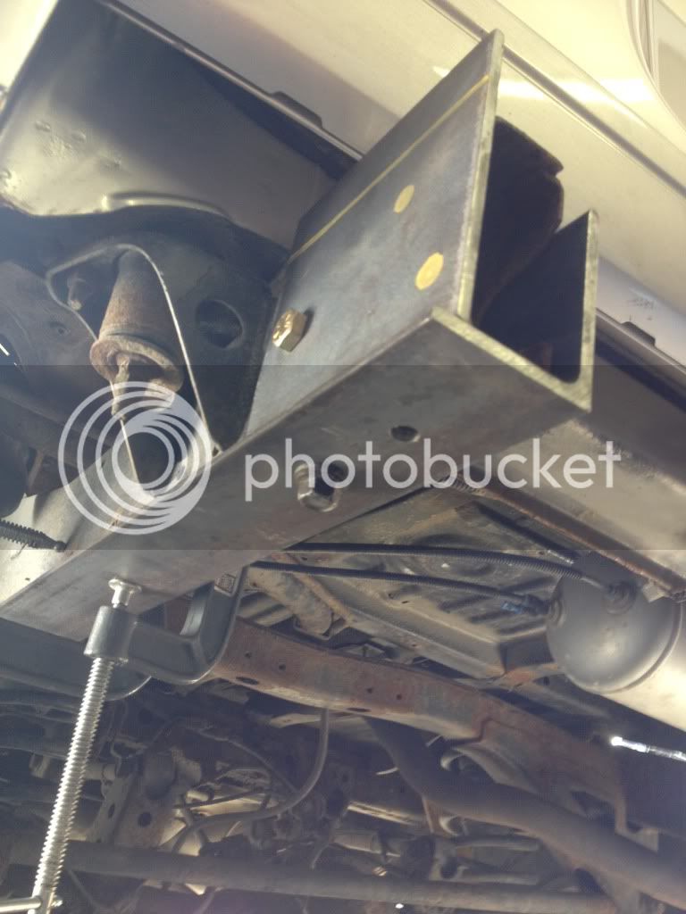

Underside showing a bit of the angles.
Side protection, should help protect the flair (not done yet obviously)
Another angle

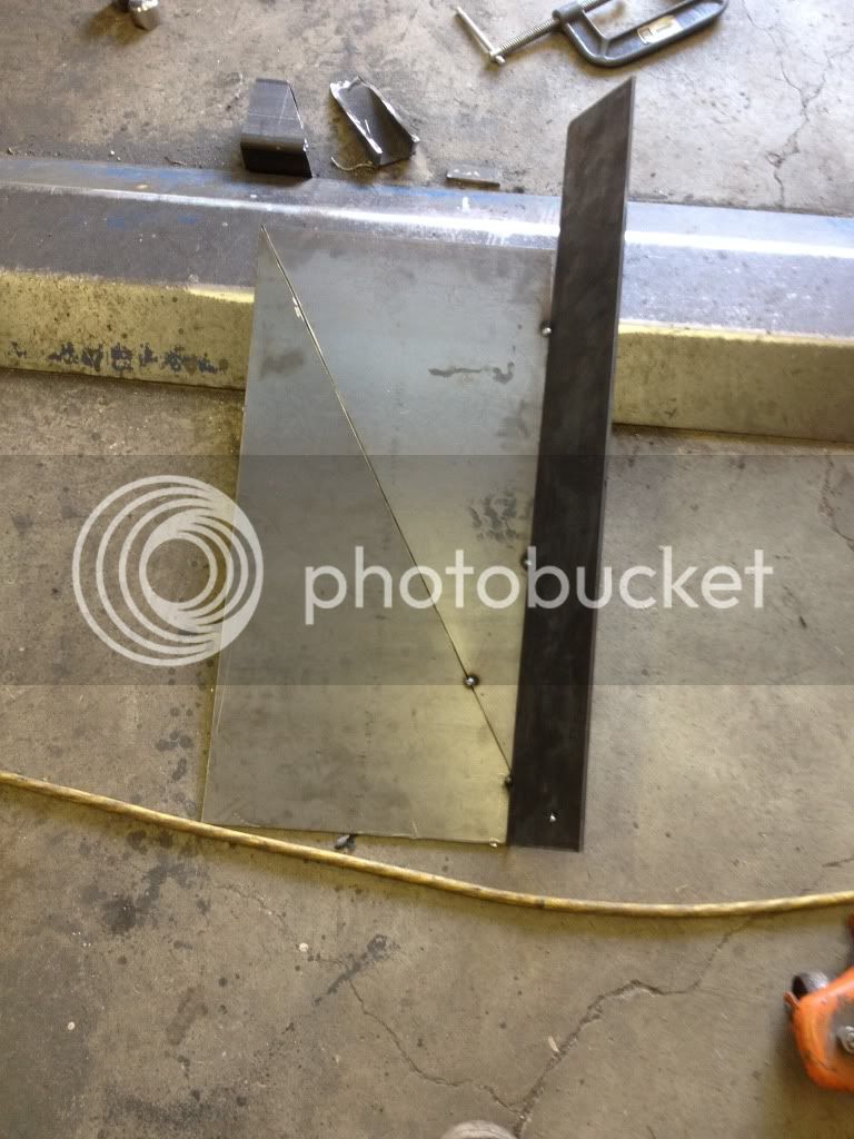

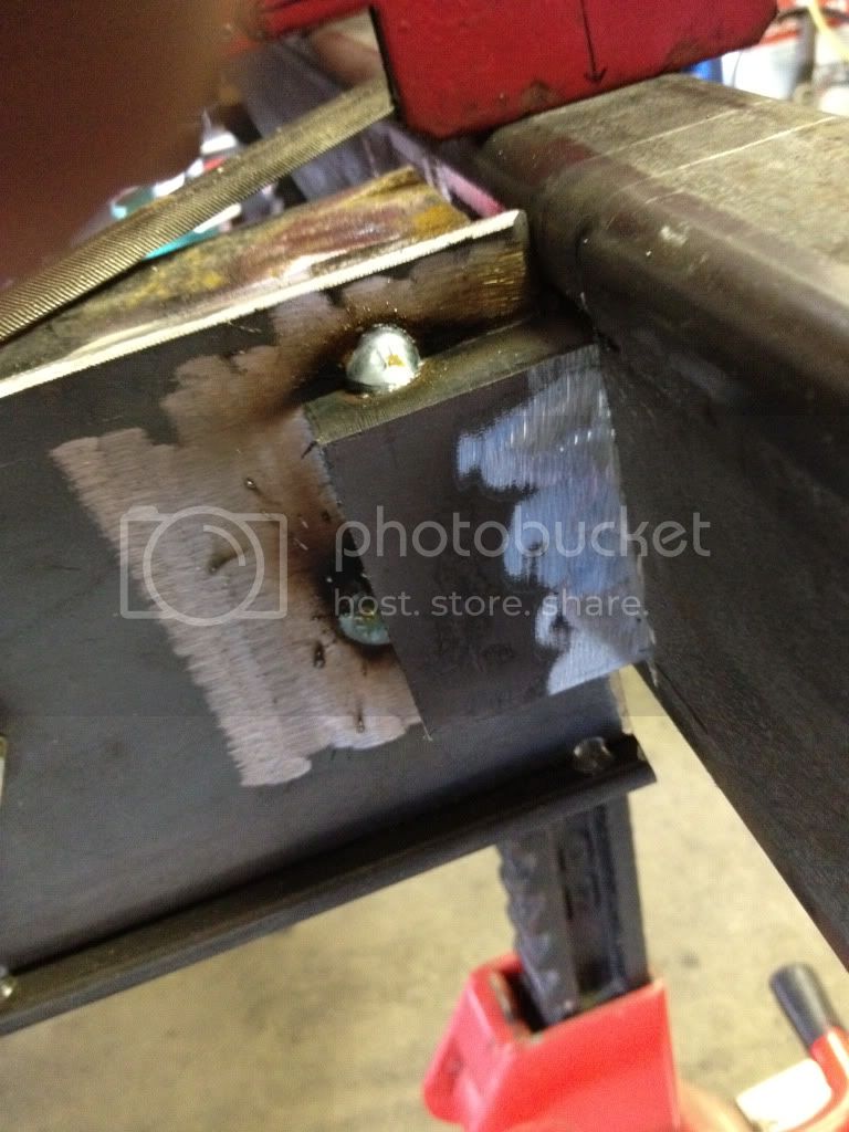

Cut line for my bend.......who needs a big ass press....
In this picture you can see the faint line where the bend was made.
That's it for the next couple days till I have time to work on it again. :cheers:

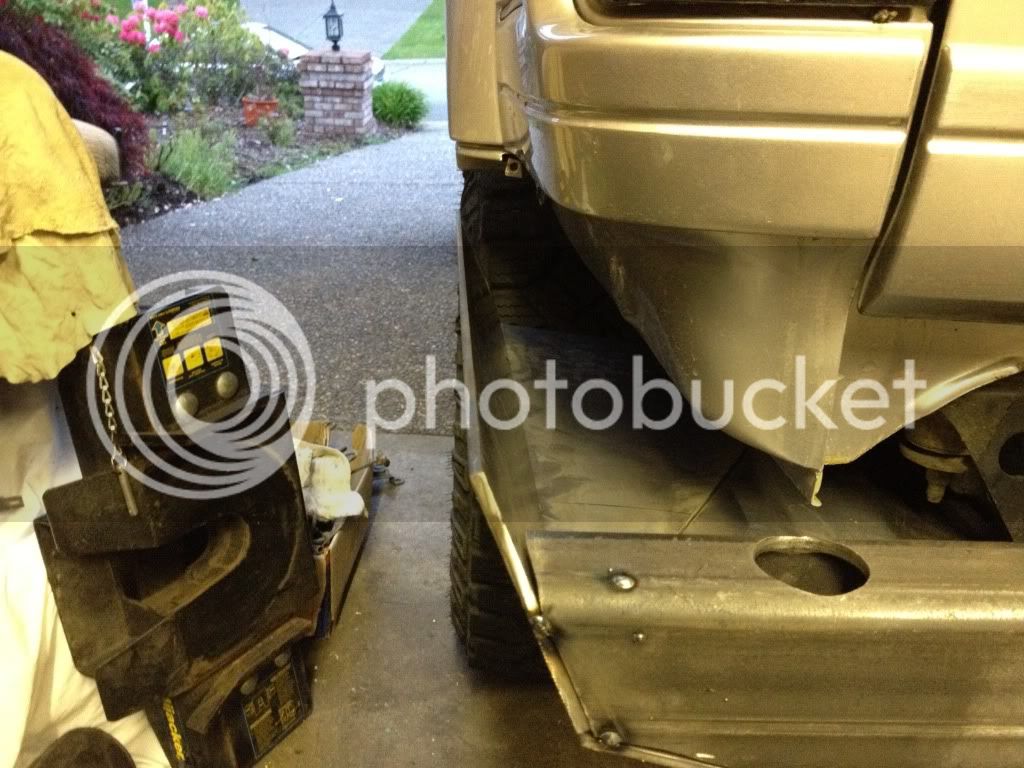

Day 4

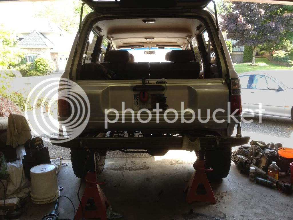

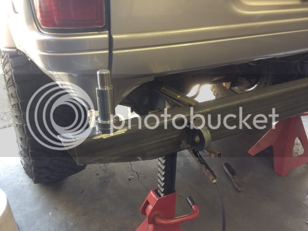

I was able to get the passide wing done today after 2hours spent trying to get the bumper on by myself. Once I got the wing on and matching the other side (harder than you would think). Once I got them done I tacked the two wing plates so they would not move. Then I cut them off the main bumper so i could start on the swingout pivots. I tacked them into place and started triming the bottom on an angle to match the side wing lower plate. They took a lot of time to cut but I finally got then done. A bit of work later with the 60 grit flap disk and it was good.
Pass side wing removed:
Drivers side wing removed:
Pivot tacked in place for trimming:
Trimming angle into pivot:
Passenger side done as well: (note the resonator is now cut off as well)
Both on and trimmed waiting for finish weld:
I had to call it a day early as I did not notic I was welding with .025 instead of .035 i should be using on this thickness. I could not fuigure out why it was not spot welding right. Once I saw that I reolised i was not doing anything but spot welds today.
I will post pictures as well as get .035 wire and tips to weld more tomorrow night.

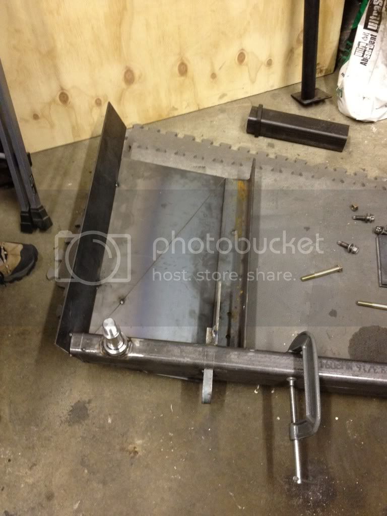

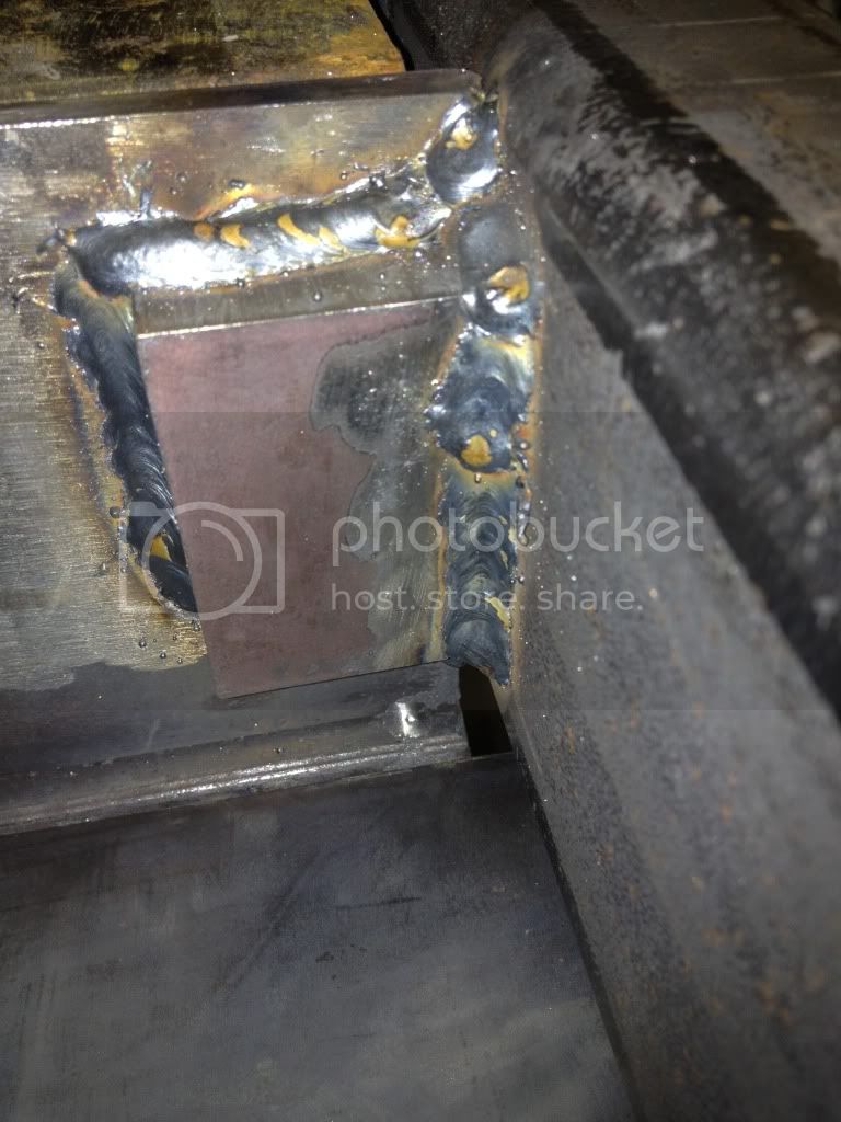

Day 5 (2 hours)

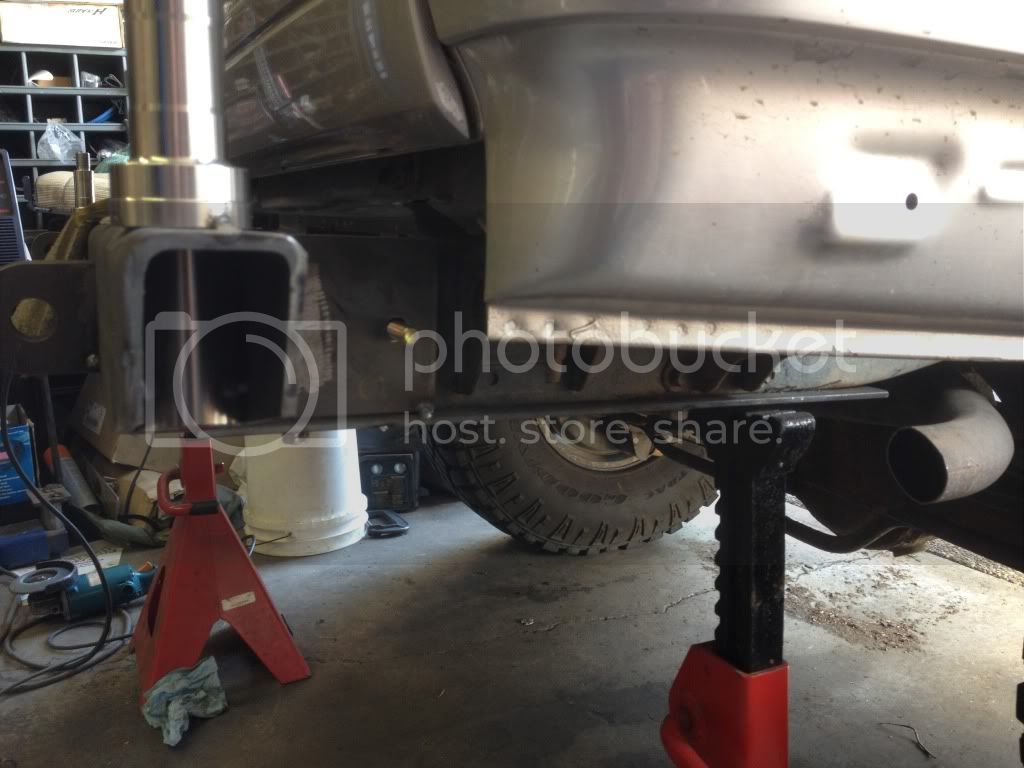

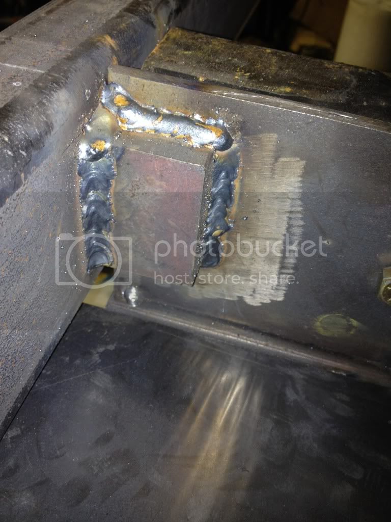

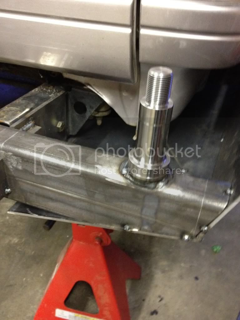

Last night the goal was to get the spindles welded in and the side wings back on. I was able to get both spindles welded top and bottom with good penetration and not overheating the metal to much. I also got the recovery points welded on, its hard to get good heat penetration on the 3/4" thick stuff but they are strong and are not going anywhere. Since I was having issues making nice clean welds I only welded the back side (out of sight stuff) so I can try and improve my welding before the viable stuff. I then tacked the side wings back on to start planing out the next step with them.
Pivot welded on:
Other one welded on:

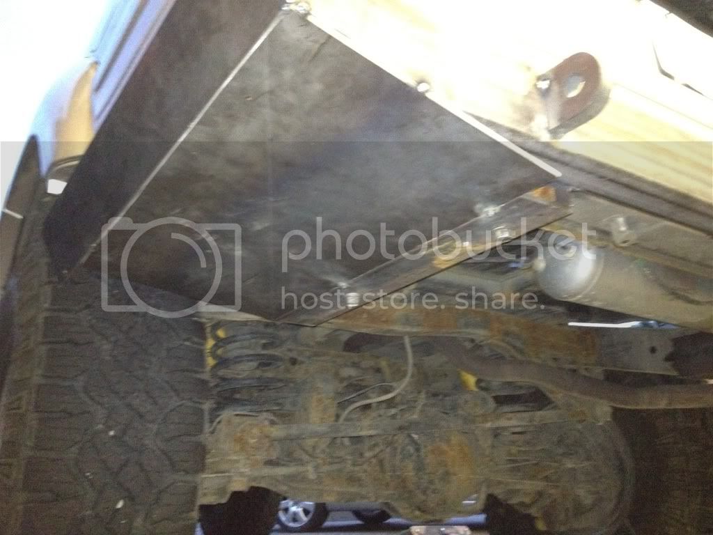

Side wing layout and testing to see where I want to go with them.
Better idea of the under protection on the wings.
A few of it off the truck:
