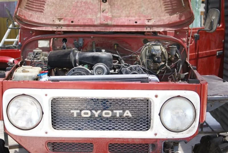

New Pics
First off sweet build man. One thing i would rethink is the rear revolver. They are great on the RTI ramp but for braking and steep downhills they unload and makes things a little interesting. I would invest in some nice springs and set a good shackle angle and skip the revolvers. Just my .02 though. Nice work
I really like the way you did the rear fenders, question for you, do you plan on bracing the rear fender into the frame so that if it takes a hit from a rock it won't distort the fj40 tub? I would think that it would help greatly to have it tied into the frame at 2 places on those rear fenders, thanks! Noah
interesting, I would have welded a plate on the rear spring hanger, lots of torque on the frame there.
Looks good, can't wait to see more pics, so i can get some ideas of what to do to mine.
Still :confused:
You say you have an '84 FJ40 (you sure about that year?) & the axle you removed was smaller (knuckles, steering arm, etc.) than a stock FJ60? '78 - '83 FJ40's have the same front axle as the FJ60's (less 3" on one side of the 60). And, how is the full floater "stronger" than the semi-floater you removed? Don't they have the same shaft dia.? I'd run ARP rear hub studs w/ the cone washers, Locktighted fo sure :)
why is this guy makin it suck a big deal and argument? the guy put the axles because he wanted to and obviously had a good reason for it so get over it please!
Great job dude .. great great job .. well now you have a nice video compromise with us .. just to let us know are not only a ramp truck ! :D
