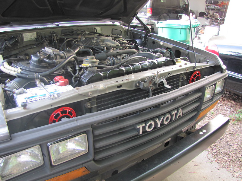

i was bored yesterday so i went out and got a set of Hella Supertones. i figured i should probably get some new horns since the old stock ones sounded liked they belonged more on a bicycle than a Cruiser.
The install was a breeze as soon as i figured out how i wanted to wire them in.
They don't sound very pretty, but they are LOUD!!! i tested em out last night at about 11:30, my parents were PISSED :p (their bedroom is right above the garage i was working in).

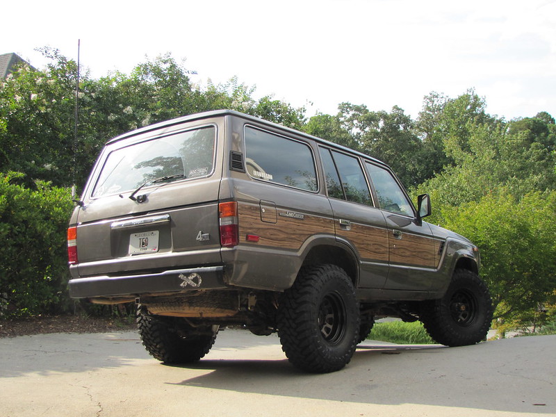

This weekend actually, I'm finally installing the ironman lift with a couple buds, but I guess that isn't just for looks haha. Also, just put in a CB radio. The last 2 things I want to get this summer are 33" cooper discoverer ST or BFG km2s and a safari snorkel, but that's only if I have enough $$$ from my summer job.
Little Update...
thought id splurge a little and instead of get the KM2s, id get a set of 33x12.50r15 Toyo Open Country MTs!! I really like them so far, but have only put about 40 miles on em.
May need a new 33" spare haha
...Ready to get dirty:D
