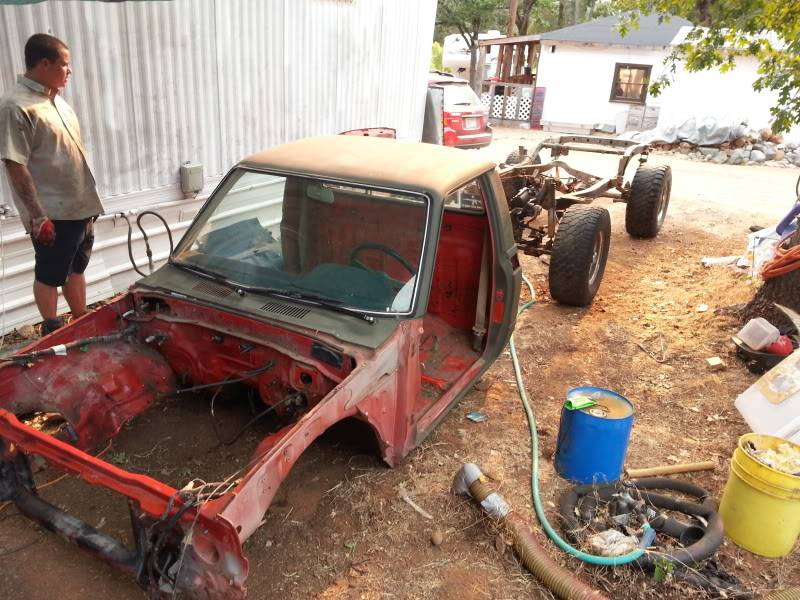

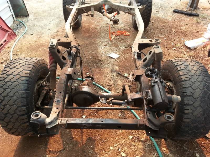

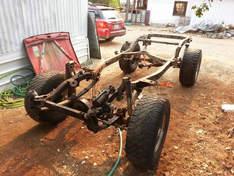

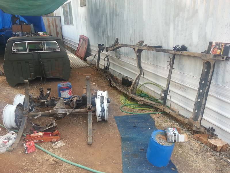

As soon as I get the head ill install that next. In the mean time me and a buddy have been busy, Figured since I have access to a sand blast booth and out door set up I'll just do as much as possible.
Hered some pics from today.
Was a fun day.

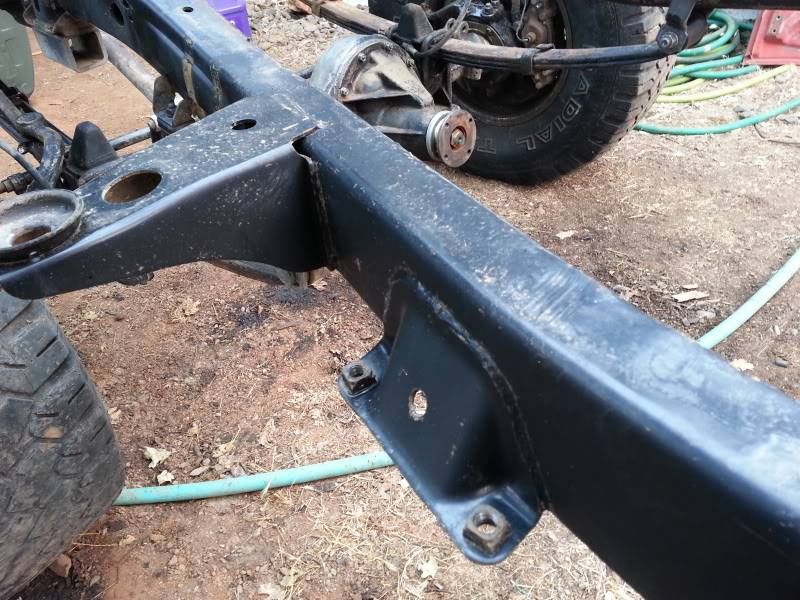

Powdercoating an entire frame will cost HUGE $$$, assuming you can find a place with an oven that big. Fine for a classic car that sits in a museum and only goes out on nice days to shows, but not practical for a truck that gets driven often.
I had mine sand blasted at a good shop not far from here, then brought it home and put 3-4 coats of Rustoleum on it. First coat was red metal primer, I think I went through a couple of quarts, then I brushed and sprayed several coats of satin black. I did everything I could to also get it inside the rails. I let it dry for a few weeks, then sprayed the heck out of it with a rustproofing material called RusFre. it goes on liquid, but cures like a sticky wax. After I get it all back together I'm gonna be keeping it all coated with Fluid Film.

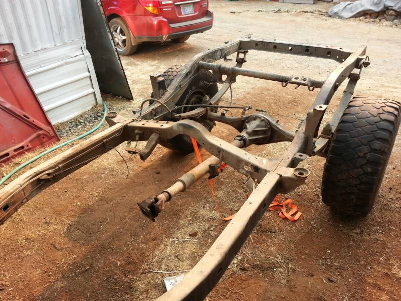

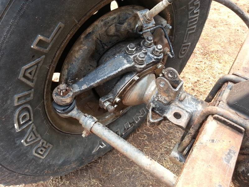

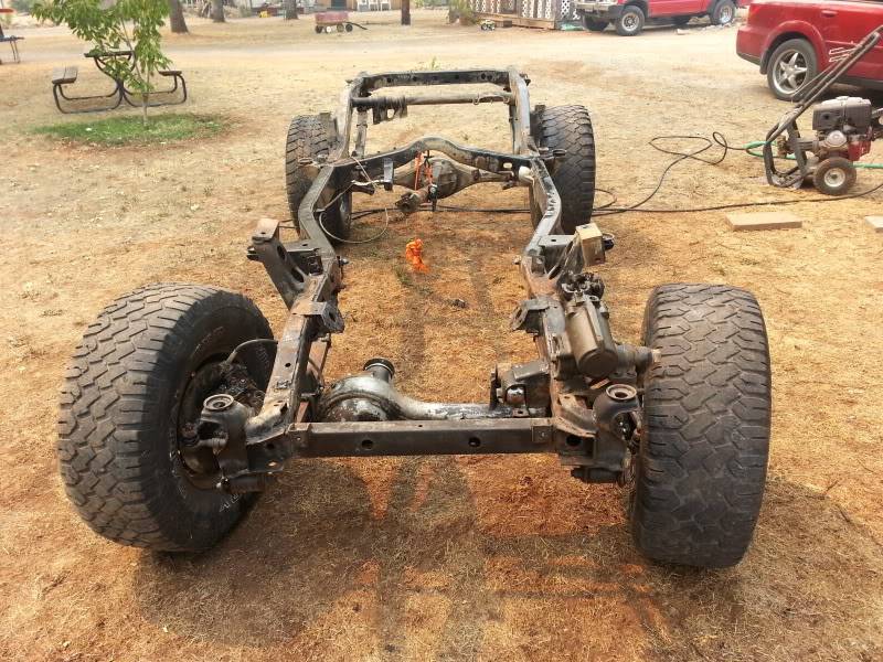

Got the chassis and axles pressure washed

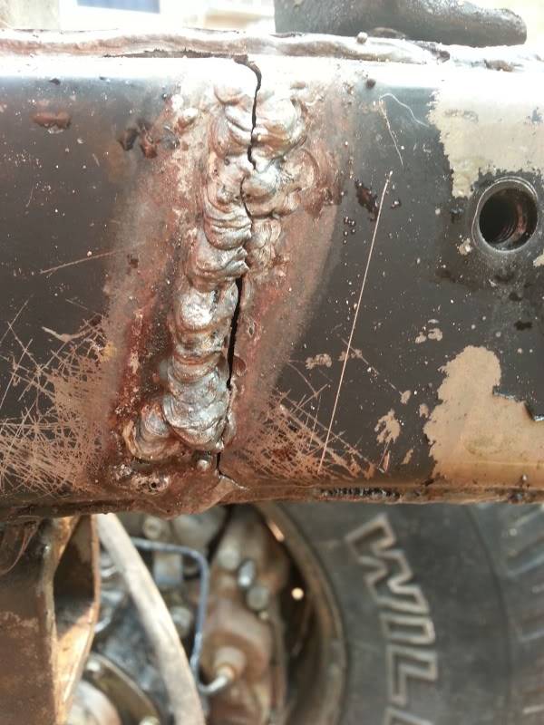

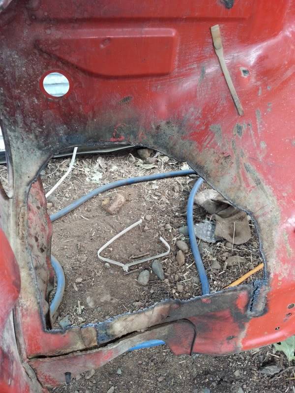

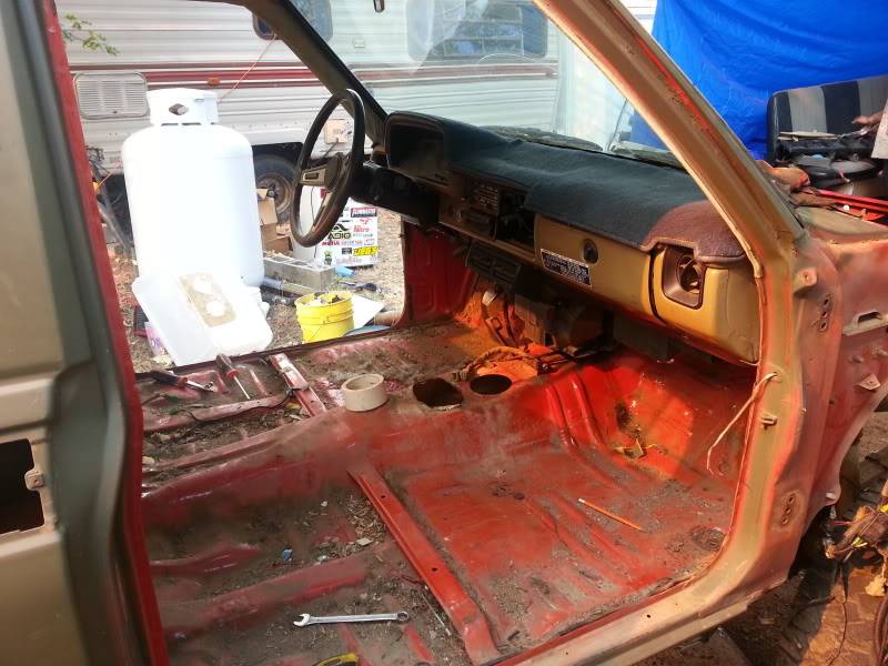

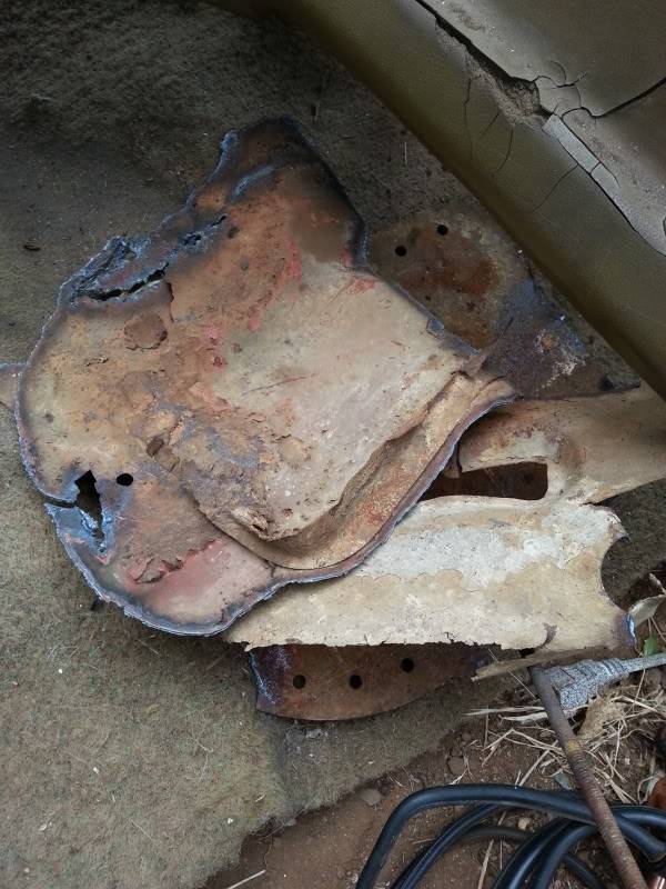

And stumbled upon this on the inside of the frame rail just behind the front shock tower. Between this and the 2 or 3 cancer spots on the cab and the rusted out battery tray
Battery tray

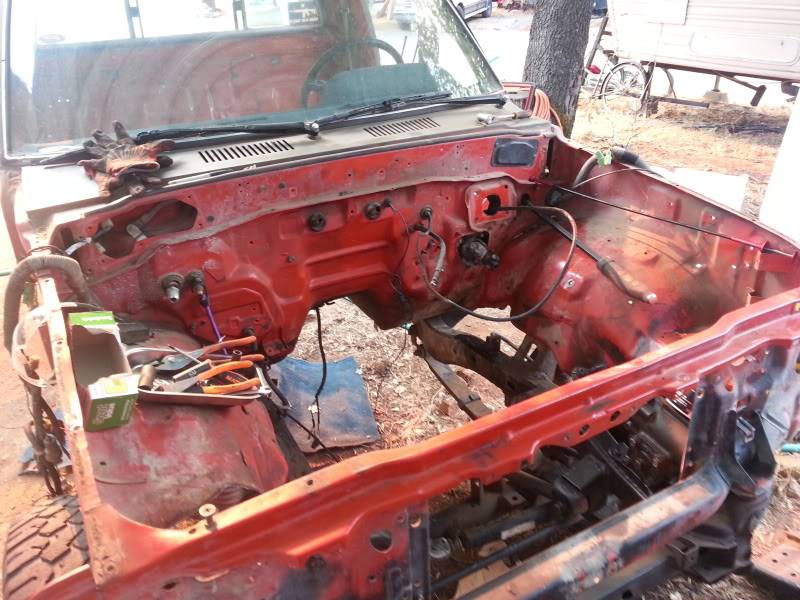

Love my plasma cutter
And these to parts almost look new but just these areas

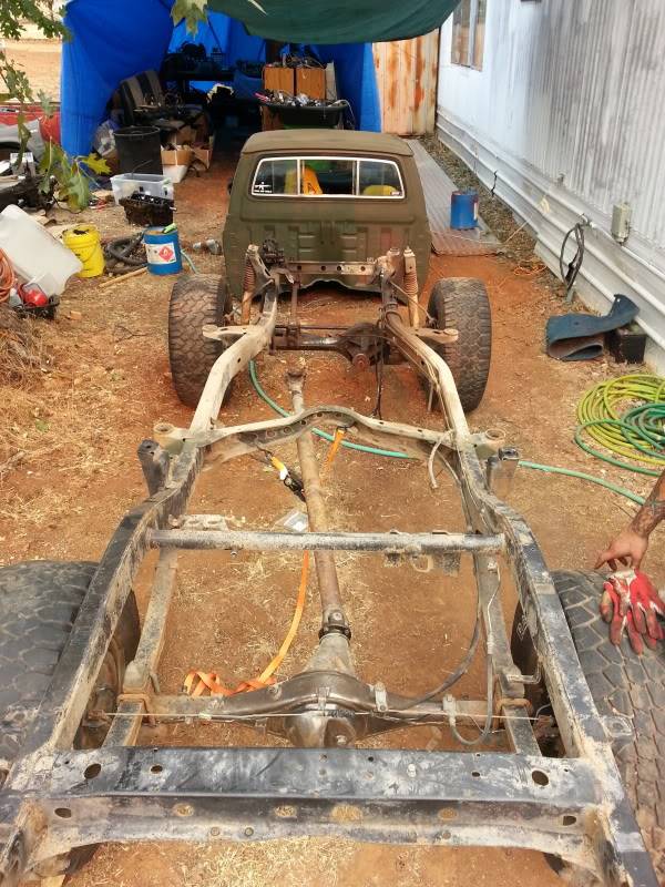

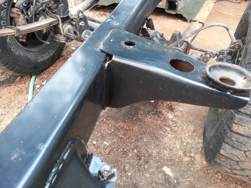

Well theres how she sits for the past couple days.
Im going to start sand blasting the chassis real soon then repairs will beade and 4 link the rear end.
