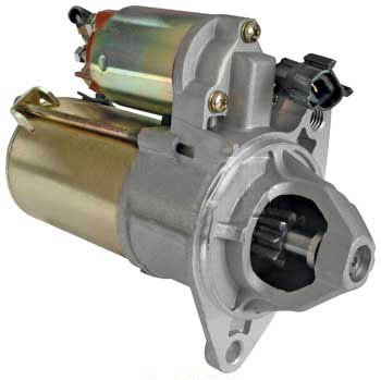

Wanted to bring this thread back. Got a few clicks last time I took my Troopy out and decided it was time for a rebuild. Looked for plunger and contacts at dealer and through a few other channels with no luck. Spoke with Chris at cruiseroutfitters with no luck either. Did some research and found the below, installed tonight and besides having to cut OEM ground connector and runs ring terminal, figment was great, easy install and she turns over promptly. I will order overseas OEM contact and plunger for rebuild on Toyota starter but at this price it was worth the swap. Hope this helps others.
Amazon product ASIN B01A9HVELM
It's not common for Toyota starters to fail that badly. Usually the parts inside fail, and can be affordably replaced with new. Good tip on the Cummins starter as an organ donor. Cummins might rely on Denso for that part, I don't know.
