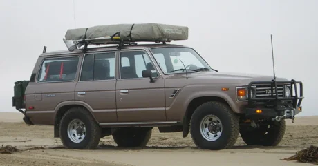

My Expedition Style '85 FJ60 with Custom Cargo Cabinets
Hi Folks:

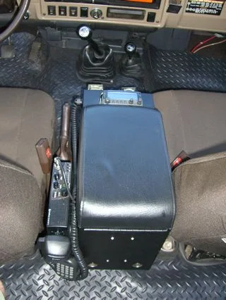

For those of you who did not get to see my rig at Surf-N-Turf, I thought I would post a few photos to share of my rig with a tuffy center console with a Dual Band Ham Radio and CB and the cabinets in the back I built out of birch plywood. The back has my camping supplies and stove plus my tool kit, spares and a fold-up toilet.

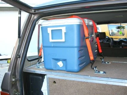

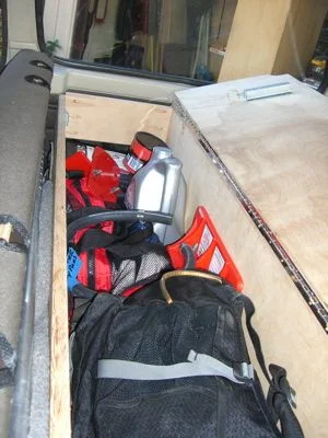

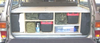

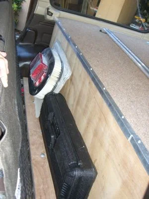

Here is the rear cargo area with my cooler strapped to the top so it won't visit me in front seat, and the behind the seat storage area for larger items with a latching hinged lid.
Enjoy, and if you have any questions about the build please let me know.
Cheers :beer:
Mark
I saw it at SnT. Nice FJ60. I did not see the cabinet work inside-That's very nice. How did you anchor it to the floor/sides? Is there enough room to put a fridge on top of the false floor? Nice job all around.
The cabinet floor is bolted to the FJ body/floor with 3/8" Carriage bolts and large fender washers. The rest of the build is secured to the cabinet floor. A fridge might fit but I do not see myself owning one so I made it to fit the average 5-10 day Coleman cooler. Otherwise you can make it any height you want.
Mark

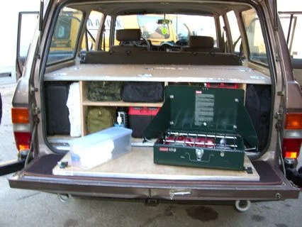

Close up of Cargo Area
Dan:
Here ya go. I hope this is better. Here is a shot with the back lid off and all the stuff stowed away. No fancy drawers to worry about just shelves about 22" deep so you can reach in and get what you need.
In my mind the Tuffy Console is worth it. My time would cost me more if I went though the trouble to make it. It was not easy getting a power dist box installed in there along with the remote mounted radio and two aux. power outlets. There just is not that much space to work in.

My point about sliding drawers, especially those on ball bearings sliders should be repeated here for those who were not at SNT. Let me preface this by saying that my locksmith truck (Ford E350 Diesel) is built with 5 large rear sliding drawers on super heavy (300 lb capacity) duty ball bearing drawer slides. When parked with the nose of the truck going uphill the drawers really want to slide out quickly when you open them and they are hard to push back in. On level ground they are great. Granted I am not gong to load up my FJ with 200+ LBS of lock hardware, I still I did not want to deal with expense and hassle of drawer slides.
I have seen some builds with wood on wood or wood on nylon slides which would not be so bad, but then again, It is an added expense too.
Mark

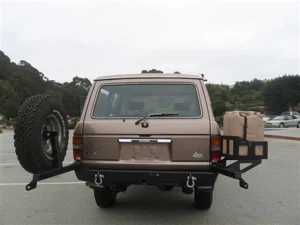

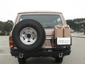

4+ Bumper
Here is the bumper. The photos are taken before the cabinet build and beforeI mounted the Hy-Lift jack to it.
Mark

You said ask any questions, so...
What are the measurements front to back? Or, what is the length of the forward cubby under the flip top?
Cheers
whoaa... youre in redwood city? im in atherton, mind if i stop by and take a look? im jsut getting into this whole expedition thing and trying to look at well built rigs for ideas...
"Leaky" is in the shop getting 4.11's, You can PM me and we'll be able to meet.
The front to back base is about 44" if I recall. The flip up cabiniet is 12.5" wide.
Later
Mark
