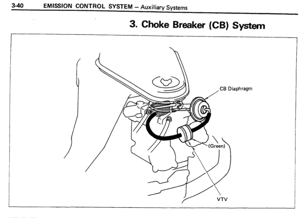

Maybe this has been hashed out but I searched the thread and didn't find a definitive answer. Which direction should the green end of the choke breaker VTV face? The FSM shows it facing the CB diaphragm. But I have seen multiple pictures of JimC rebuilt carbs (including in the how to desmog PDF) that show the green end pointing towards port (b).
The emissions manual shows how it’s hooked up.
Yep, that's the exact picture I was looking at last night in the FSM. I guess the pictures of JimC carbs I've seen with it flipped are wrong.
Maybe, but probably not. That thing just restricts in one direction to delay the choke breaker. If you put it in the other way it just overcomes the choke sooner. Only a problem if it's cold out and even then not a big deal. One can eliminate it and have a good tune anyway.
If it is installed "normal" per the FSM, it delays the CB action.
If installed 'reversed', the CB works immediately on startup. Also it maintains the CB action even during drops in manifold vacuum.
Well I cracked one nipple off mine trying to flip it back then so I just removed it from the line. So I guess I am super reversed now.
