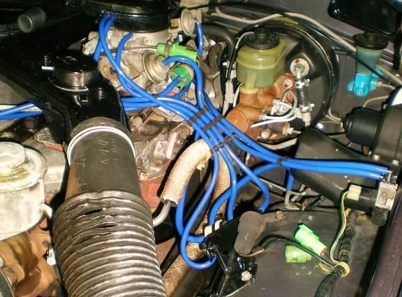

Using this thread as a guide, I dove in and did'er. Runs much smoother and seems to need less pedal pressure while driving. Fuel economy still blows but I haven't sent my carb and dizzy to JimC yet for a good rebuild. I also think I messed up the bearings in the smog pump during the de-vane so it squeels like a pig. I'll be doing the idler pully. The blingin' blue vacuum hose is from Spectra and is of the silicon variety. I would have prefered black but they didn't have it in silicon.
If anyone sees a mistake I have made please dive in and tell me what a bone head I am. :D
effjay,
things that are good:
silicon tubing
A/C idle up
canister purge
Decel fuel cut
questionable things:
PCV valve in place, has a filter stuck on it
PCV pipe missing from intake
Crankcase vent hose on VC is stuck on AC w/ filter
manifold vac fitting missing from intake (source for dissy breather)
dissy vented direct to AC (leads to exploding dissy)
HIC disabled
CO connected to?

thanks Jim, I'll do some mods tonight. I cut the PCV valvein half gutted it and welded it back together to serve as a pipe nipple. Is a lack of PCV a no no? The valve cover vent has a filter on it and the fitting on the air cleaner is capped (Trying to make my airfilter last). Is HIC the white one under the aircleaner? It's hard to tell on the diagram? What is CO? Thanks again for the help.

The PCV should be routed to a splitter where it goes into the HIC (under the air cleaner), and then around the back of the engine to the intake manifold. If it were smogged, this is where the EGR pipe connects to the intake(there is a pic o f this in post #68 of this thread...in that pic the EGR side is capped). The other side is a hard line that comes off the intake and turns into a 5mm??? vacuum hose that routes around to the PCV valve. The OEM PCV valve and grommet are pretty tough billet steel (the valve itself), so they would seem to last a while. The PCV serves a purpose to vent crankcase gases, so I'd return it to original configuration. I believe that the CO referred to is choke opener.

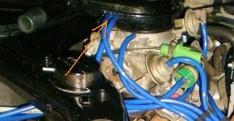

thanks Jash....my CO is hooked up yonder....see pic. post #70 says I don't need it, what do you guys think?
