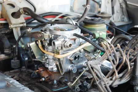

1. The new Carb back in its home.

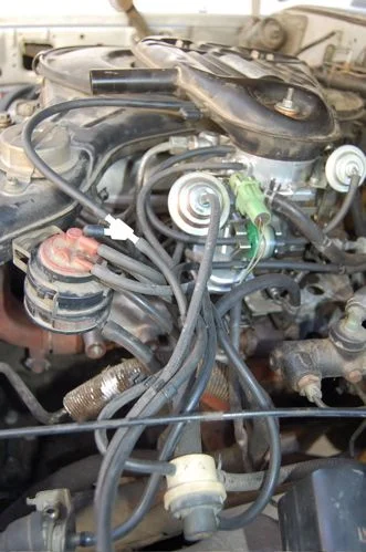

1. The New home for the High Altitude Compensator and deceleration valve (I think that is what the second one is called. Ya know, that one that stops her from back firing.)

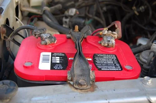

2. What I HAD to get after draining the old battery too many times. ;)

Then I got the Carb and Dizzy back from Jim C :D
I put the intake/exhaust back on with a new gasket (felpro), reinstalled the whole exhaust system with the new straight pipe :grinpimp:, put on the air pump deleat pulley, put the carb back on, and reinstalled the dizzy.
Then Dynosoar came over and helped me plum the vacuum system with the HAC & decel things in place.

Looks good DT! What a difference the desmog makes, Huh? Was that carb new or rebuilt by Jim? I don't remeber mine being that shiney after being rebuilt, it looks new! Any plans for a header?
