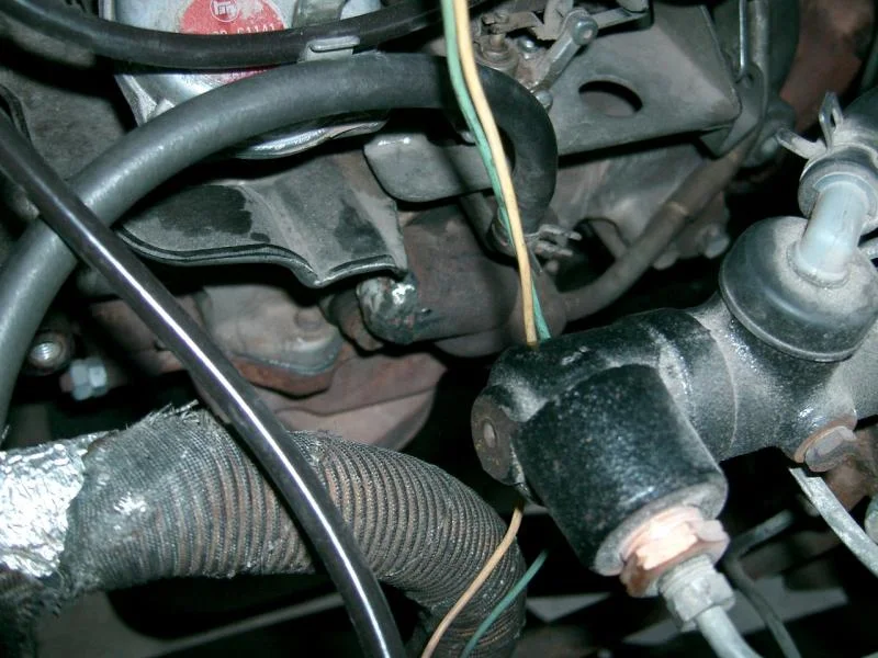

I was wondering if you guys could take a gander at my desmog to make sure I havn't missed anything. I'm pretty sure all I have left is the dizzy re-curve. No HAC or AC idle up. Green wire mod so fuel cut port on carb plugged. EGR system completely removed with PCV pipe mod. and block off plate for where the old EGR pipe came off the exhaust manifold. Also removed and capped the tube that went to the down pipe off the manifold. I just used metric bolts to plug the air rail ports for now. The old gas filter was removed from the manifold and I tapped the hole for an 1/8" barbbed NPT fitting for the line to the VCV. I also bought some of that silicon tubing off McMaster Carr and really liked it so I will be buying some more to replace the rest of what I have left.
From what I can tell, it looks good but I could use some shots from further back to track the lines. I like the rubberstopper plugs on the aircleaner, good solution.
