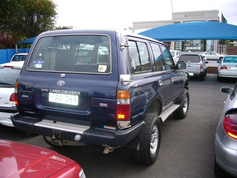

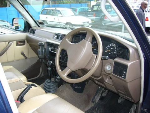

This is how I bought it. The guy before me fitted the bulbar,mags and had the leather done inside. I looked long and hard for the U.N spec because of the simplicity of it. (this will change later on in life.)

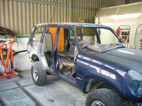

My first thing on my list to do was to paint it. (I only ever go with factory colours) so the green was about the best I could find to cover the blue. so the strip down began.

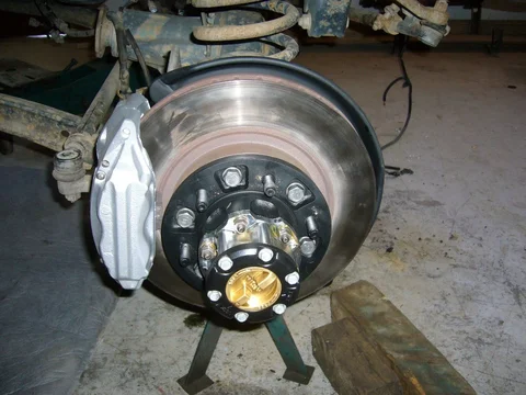

Before the respray I redid all the brakes (new discs and drums) wheel bearings. New carb kit, ARB lockers fitted front and back the whole bang shot.
I had all dent removed and a full respray done. (still think the colour looks great but way to hot for the African sun)

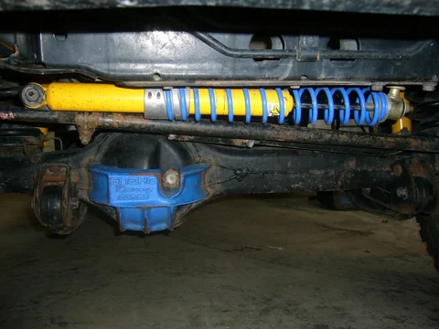

Then came the lift. Spending hours on Mud trying to chose the best I settled on the 4'' with 35'' wheels. Now in South Africa there are little to no options on lift kits. OME 2'' is all that one could get. So with lots of phone calls to the importers and a upfront payment they finally agreed to bring it in for me with a NO return policy. And only the J spring and Long travle shocks would be brought in. the rest I would have to make. Thanks to Mud again on how all ideas on how the modes would be done. (panhard rods , sway bar extentions, brake lines and caster correction.)

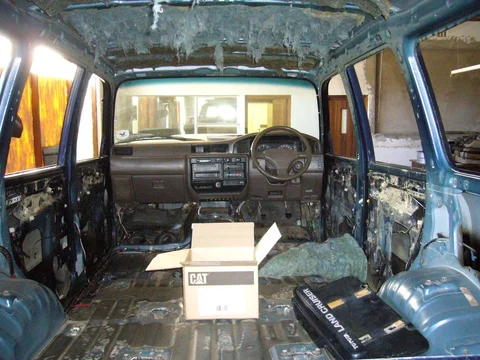

Then the assembly began all the interior and exterior had to be put back.

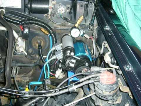

The ARB air pump for the diff locks. Note the dentist quick coupler I got to connect my air pipe to pump tyres.

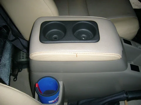

My cup holders that I removed from the rear seats if a Ford Ranger. (its the only thing that would ever brake.)

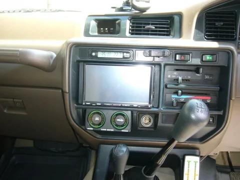

My rollover gauge fitted where the ashtray was.
