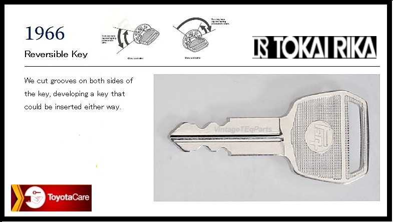

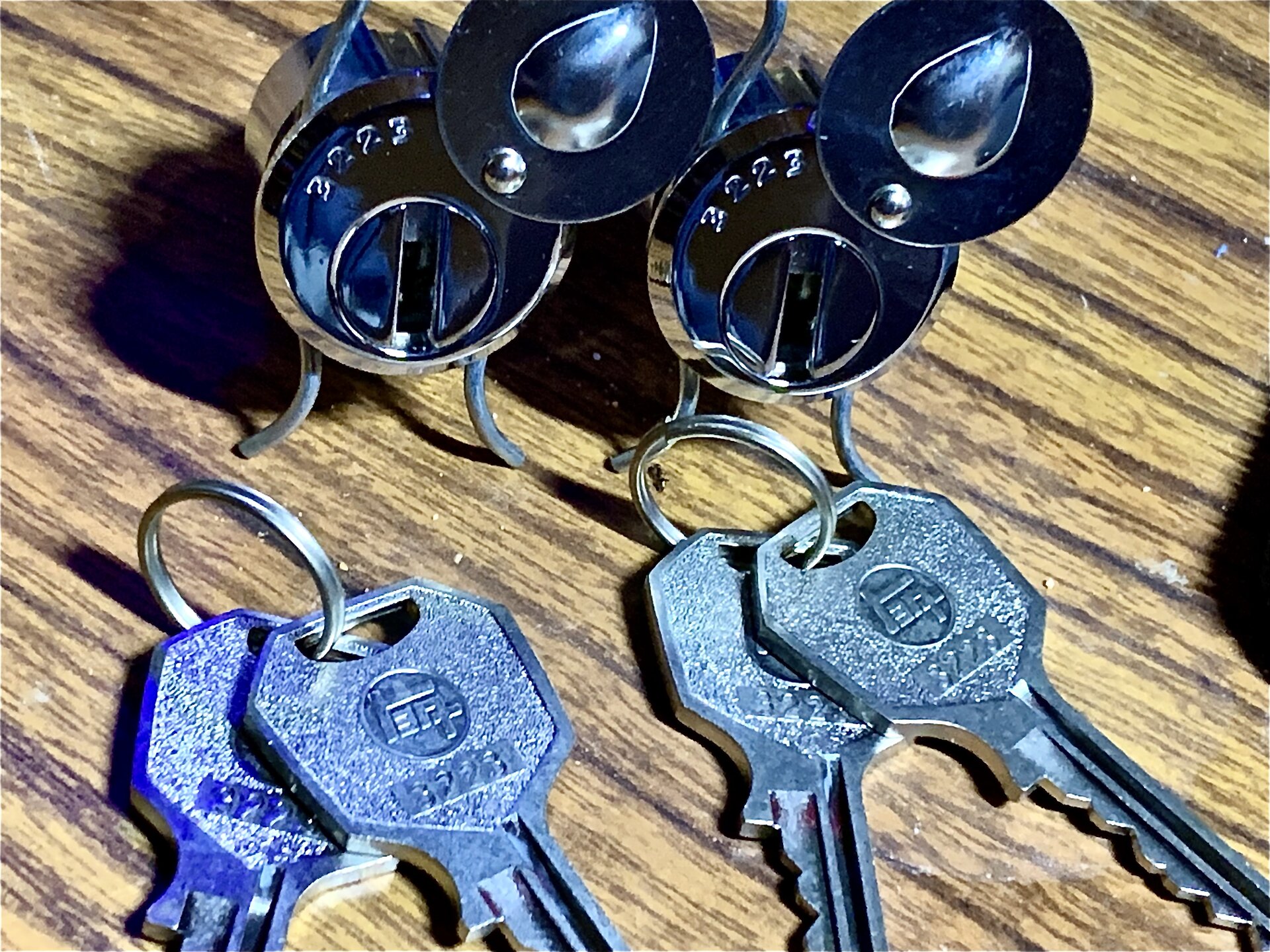

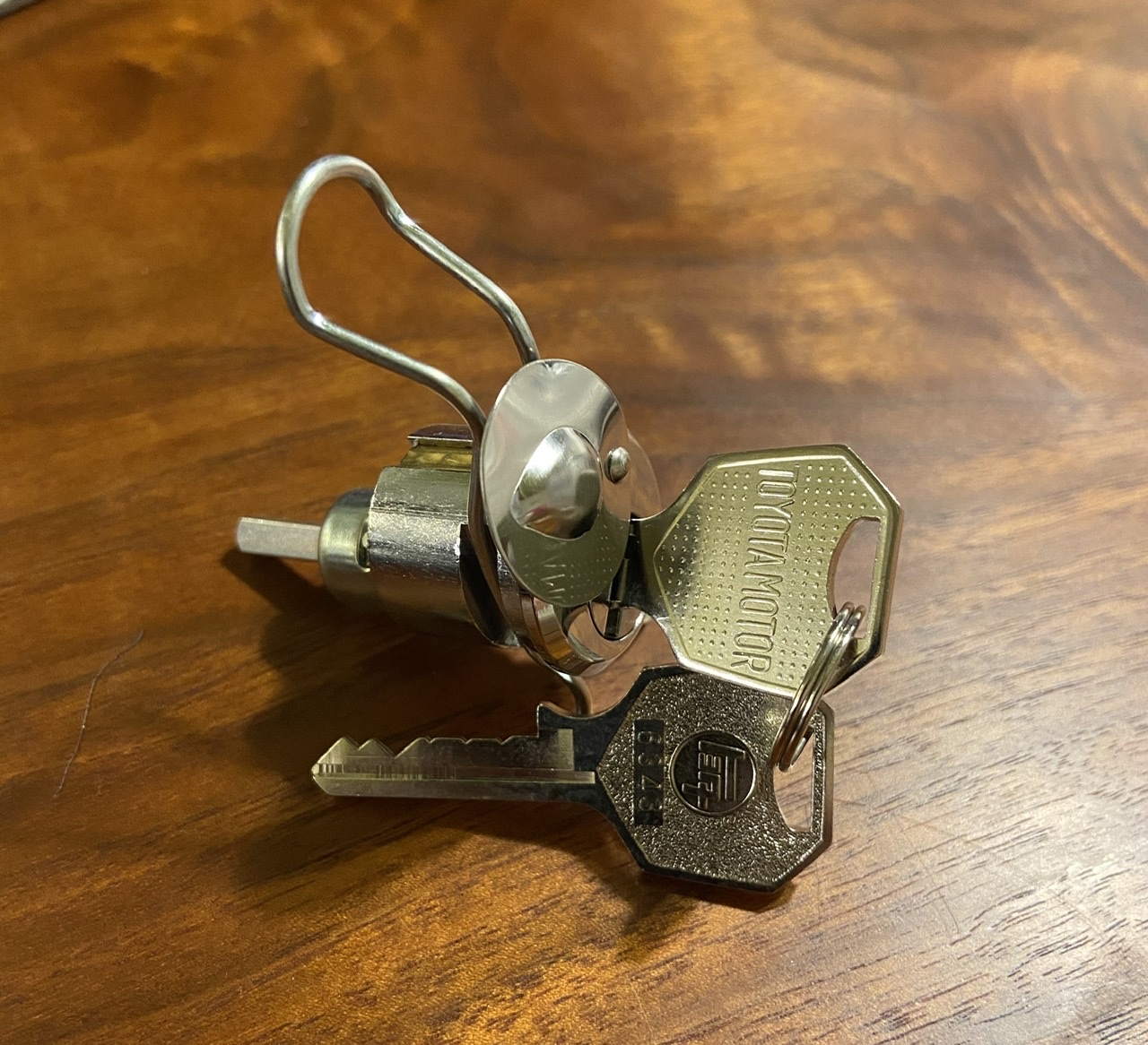

Hi ,
your 1973 FJ40 should have a Steering Column mounted lock using a 2 sided key , this 2 sided key would have matched your 1973 FJ40 Flip Down Fuel Door lock as well ...
the typical 1973 FJ40 has a Single-Sided Saw Tooth Saber style Key that would have also matched your Real Lift hatch , that uses the same single Sided saw tooth saber Key
if your passenger side door has a lock also , and each door metal shell is a 1973 also ? Only a few production years FJ45 SWB and LWB pickups had his and hers locks like you describe from the factory
