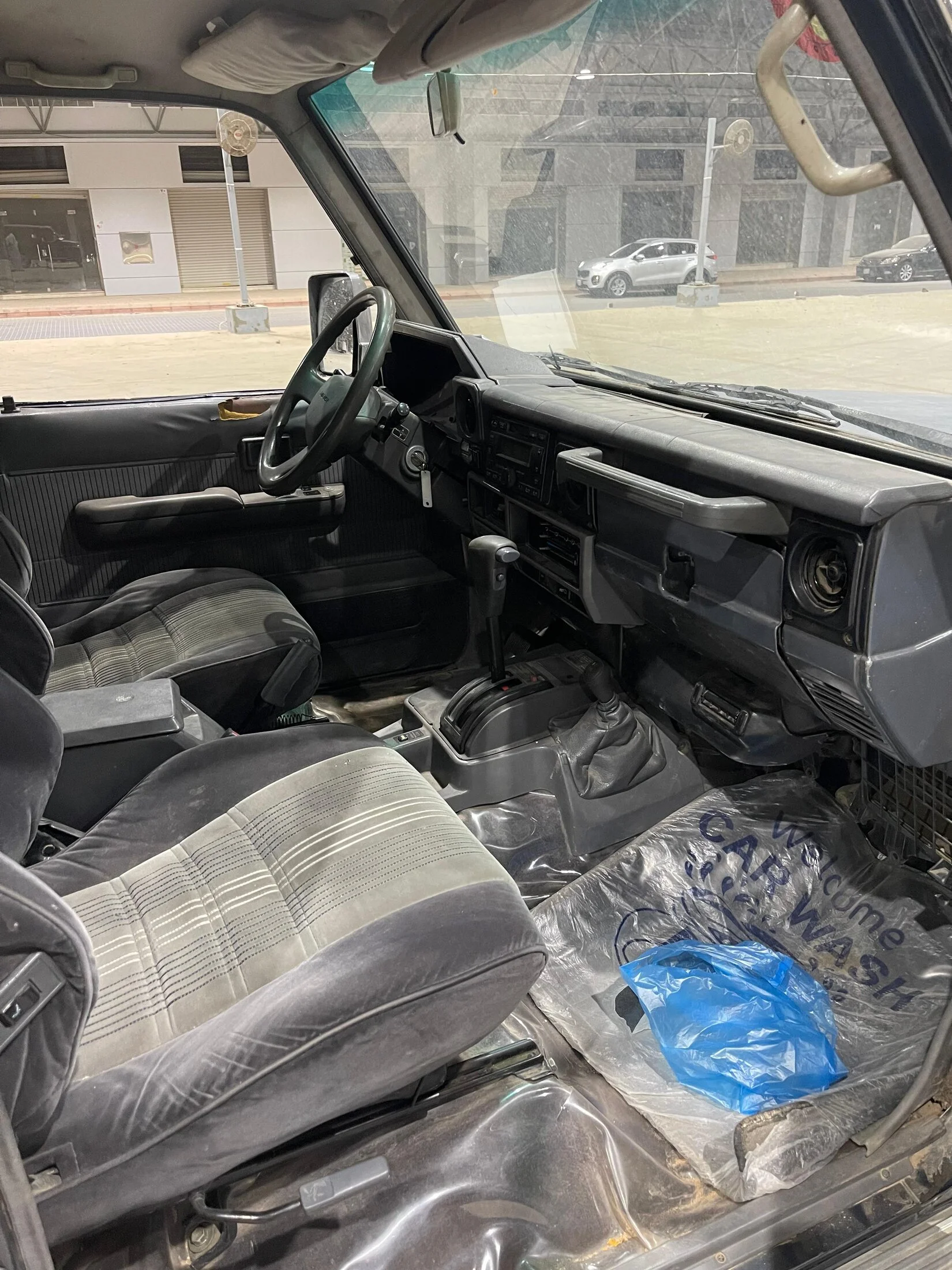

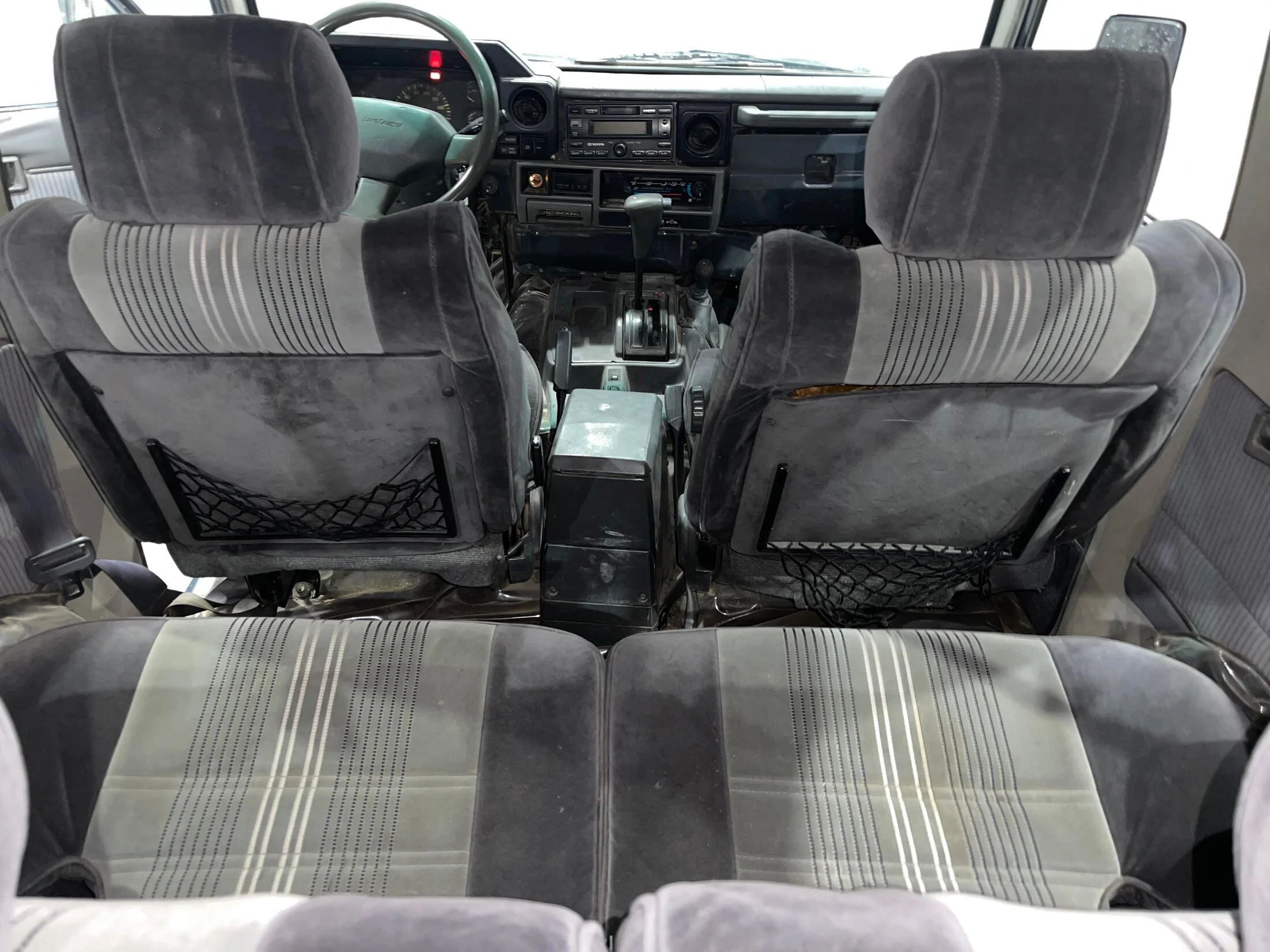

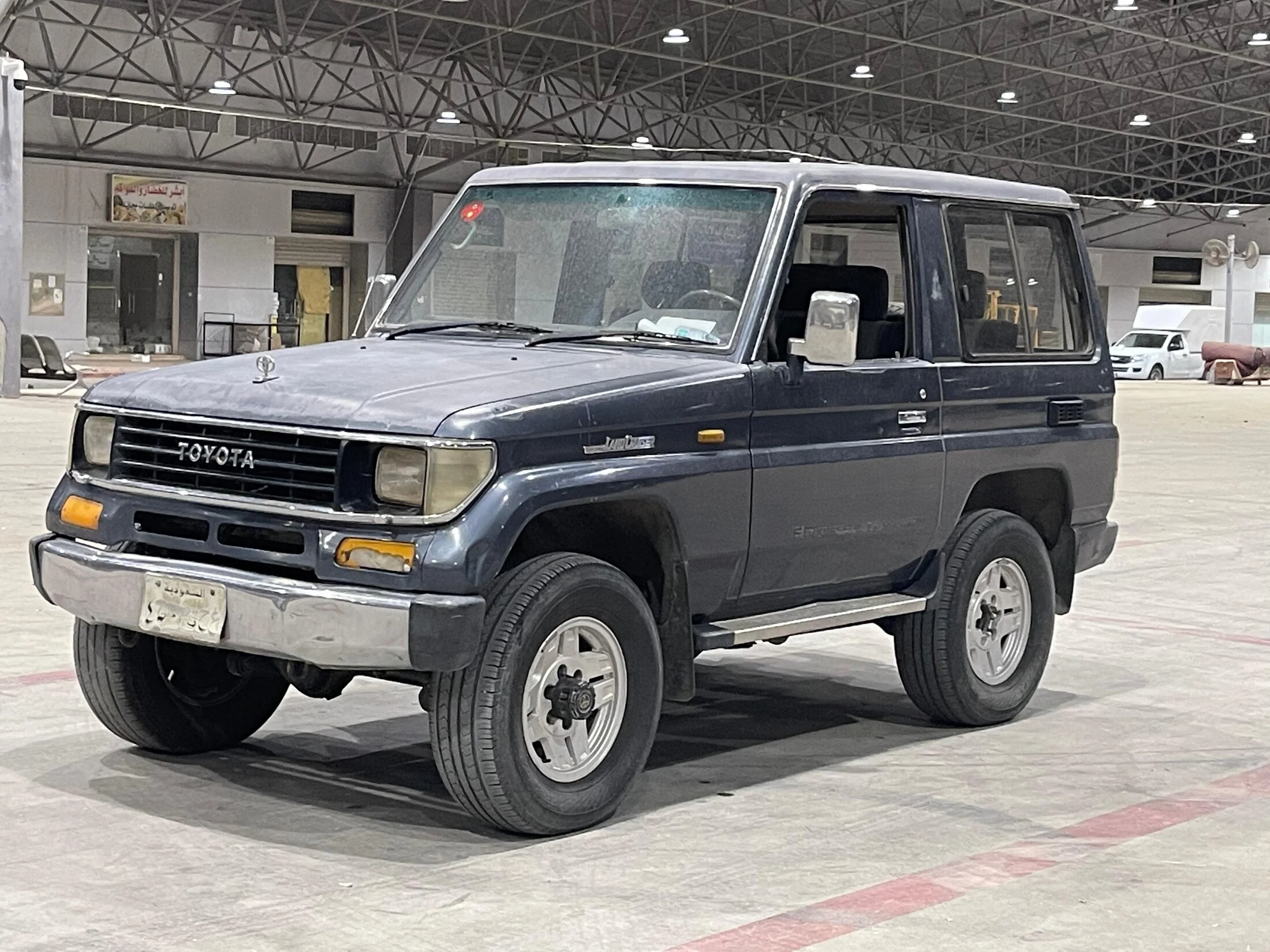

Hey everyone,
I wanted to share my full experience with my Toyota Prado LJ71G (1993 model) after swapping in a 3RZ-FE engine, and I’m hoping to get some advice on the challenges I’m still facing.
Background:
My Prado originally came with a 1KZ-TE engine (turbo diesel) and an automatic transmission. The vehicle is a Japanese import, and I had already converted it from right-hand drive to left-hand drive before the engine swap. Wanting more power and reliability, I decided to swap in a 3RZ-FE engine while keeping the stock automatic transmission.
The Swap:
The 3RZ fit in fairly well with some custom mounts and wiring work. I was hoping for a noticeable increase in torque and overall performance, and while the engine runs fine, I immediately started noticing a few issues post-swap.
Current Issues:
1. Lack of Torque:
• The 3RZ feels a bit underpowered in a heavy SUV like the KZJ71, especially during takeoff and uphill driving. I expected better low-end torque but it seems like the powerband isn’t matching the weight and gearing of the Prado.
2. Transmission Concerns:
• I kept the original automatic transmission (4-speed), and while shifting is smooth, I feel like it’s maxed out around 80 km/h. The RPMs are high, and it feels like the engine is pushing hard without actually gaining speed efficiently.
• There’s also a subtle whining noise that starts around highway speeds, making me worry about the long-term health of the transmission under the added stress.
3. Differential Ratio Mismatch:
• I suspect that my current differential gear ratio (likely 4.1 or 4.3) isn’t ideal for the 3RZ. I’m considering swapping to a 4.56 or 4.88 gear ratio to improve low-end performance and reduce strain on the engine at higher speeds.
4. Future Plans:
• I’ve been seriously thinking about installing a supercharger to boost low-end torque, but I’m concerned it may overstrain the stock automatic transmission unless I upgrade or reinforce it first.
• Also looking into installing a proper transmission cooler and possibly reprogramming the ECU or going with a piggyback tuner for better performance tuning.
What I Need Help With:
• Has anyone here successfully run a 3RZ with a stock Prado auto transmission long-term?
• What diff ratios are you using that balance highway comfort with off-road torque?
• Has anyone supercharged their 3RZ and kept the auto trans? What were your experiences?
• Would you recommend changing the full differential assembly or just the ring and pinion gears (crown and pinion)?
Any advice, experiences, or recommendations would be greatly appreciated. I really want to get the best performance I can without destroying the drivetrain.
Thanks in advance
