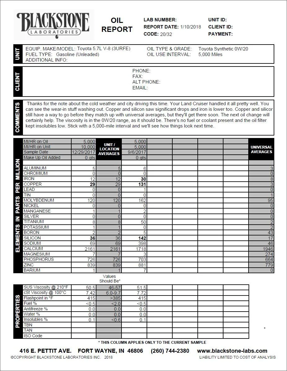

Here's mine for my 2017 LC @ it's second oil change (5k mi interval, 10k mi on unit). At the first oil change, I switched over to the TRD Pro oil filters. Copper and silicon levels approaching normal, and iron is lower. Used Toyota 0w20 for second interval, but now switched to Mobil One 0w20 (that's all the dealer had at the time). Next change will be at 15k mi.
Your looking real good check my oil analysis above that’s what yours will look like in another 15,000 miles. My dealer uses Kendall 0W 20 liquid titanium that’s why my titanium numbers are so high but it looks like it’s good anti wear additive and something most of the bigger companies are starting to look at.
