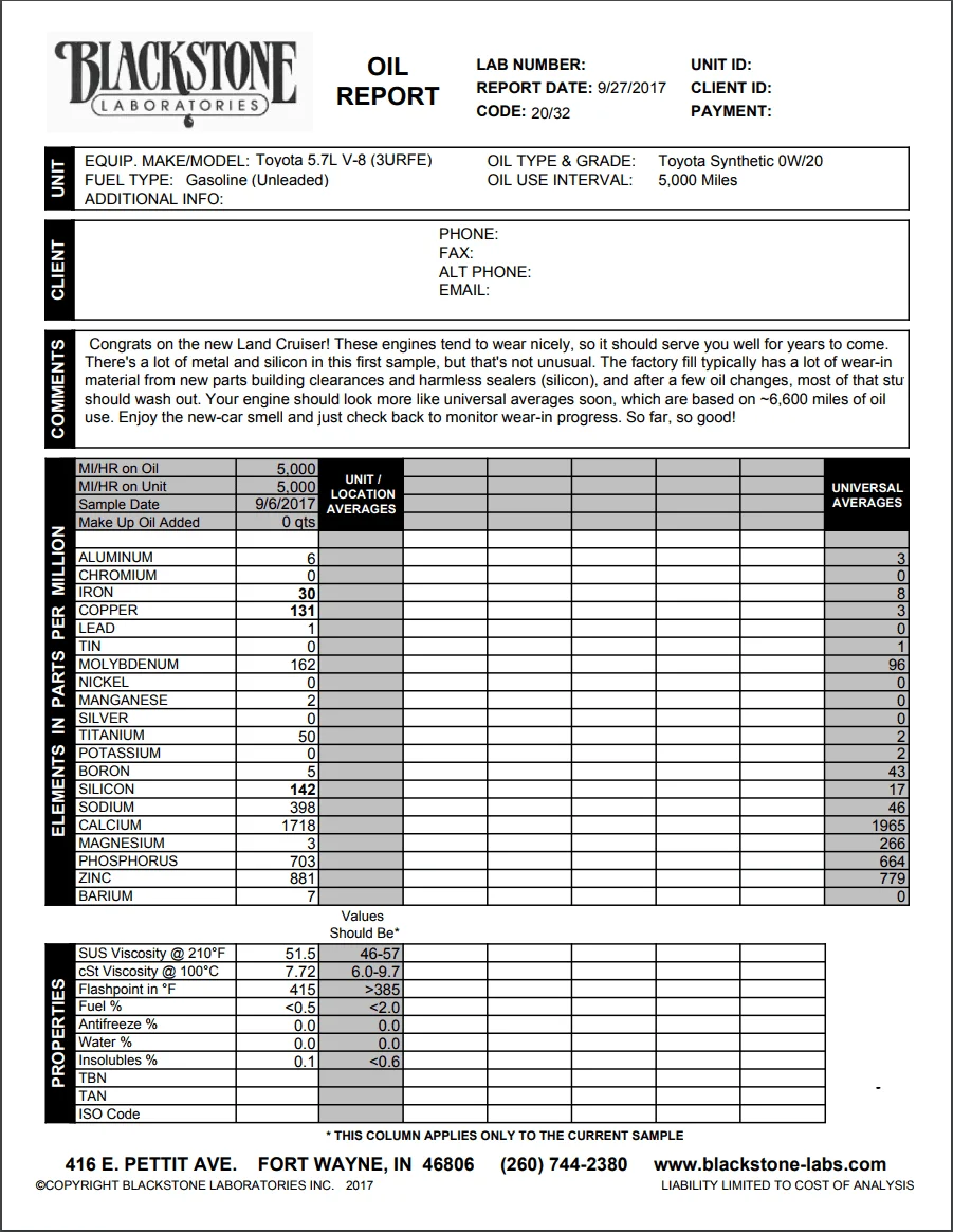

Here's mine for my 2017 LC @ it's first oil change (5,000 mi). I'm looking forward to seeing the Iron, Copper and Silicon levels drop to normal.
