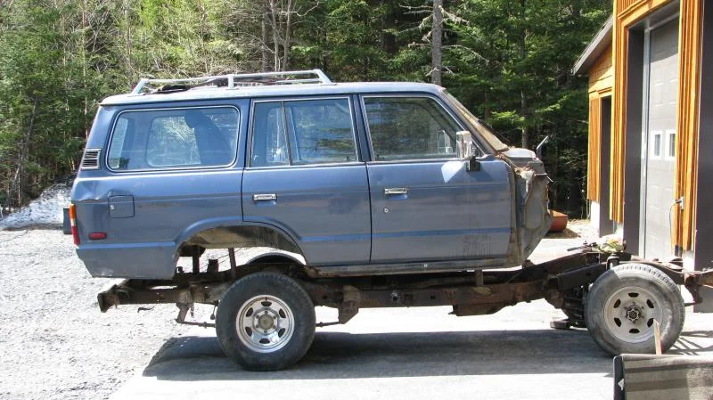

Build My BJ R 60 !! resurrected, almost
Member Builds and Stories

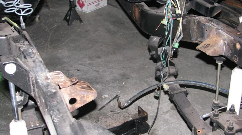

Got a bit more done today in prep for the new motor..
Nice to have both frames side by side.

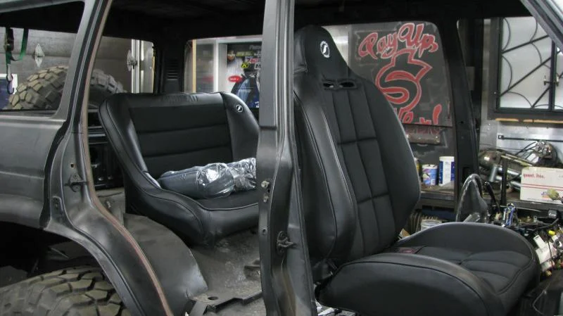

While waiting on more parts and the flywheel back from machine shop, gonna try and fab some quarter sliders and some kinda cage for the news seats. Light rack, mtr mounts and so on....

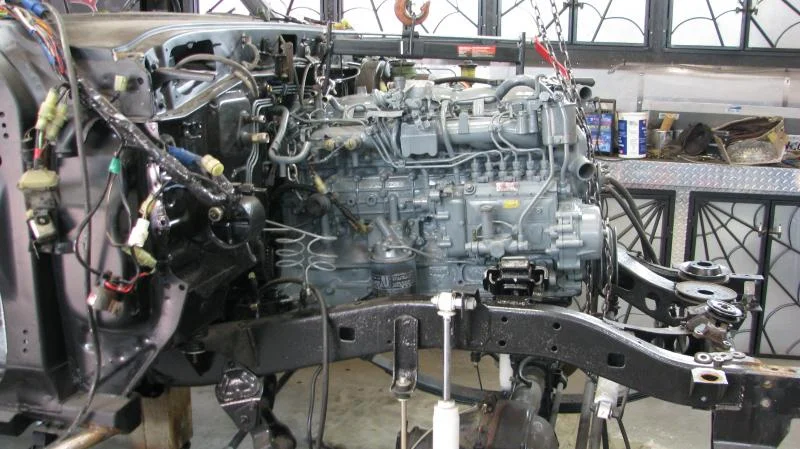

Another great weekend is upon us.More progress to come.

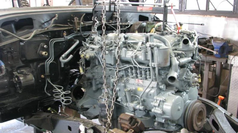

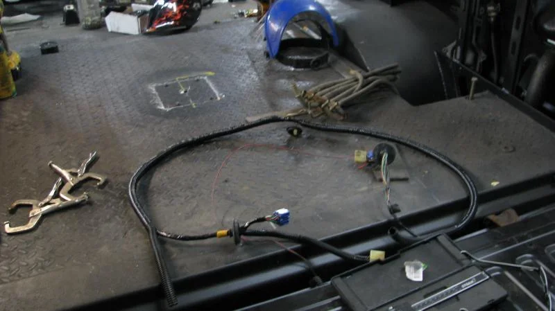

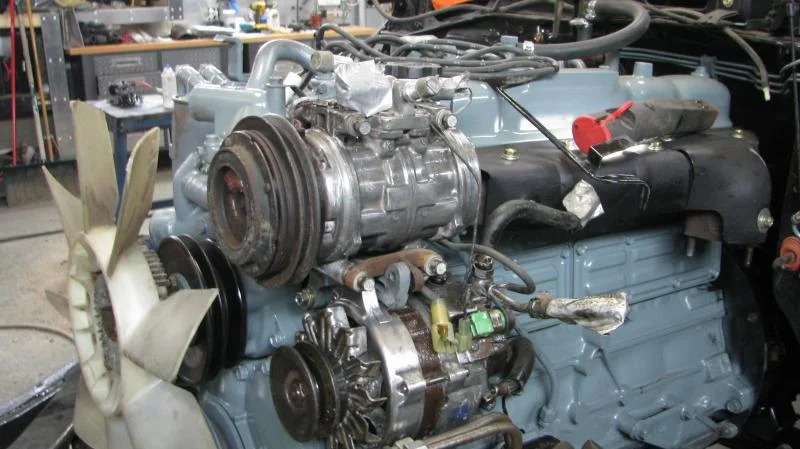

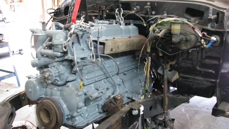

Engine fits in its place,wireing is in, man i can see the finish line.

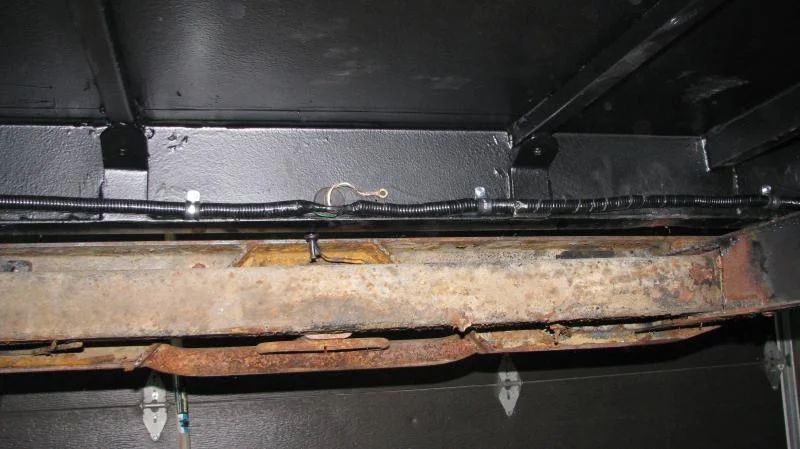

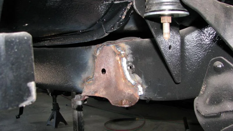

Man, the small jobs add up, fuel door in floor, wire harness installed, got the engine in so now i can weld the supports in for the motor.

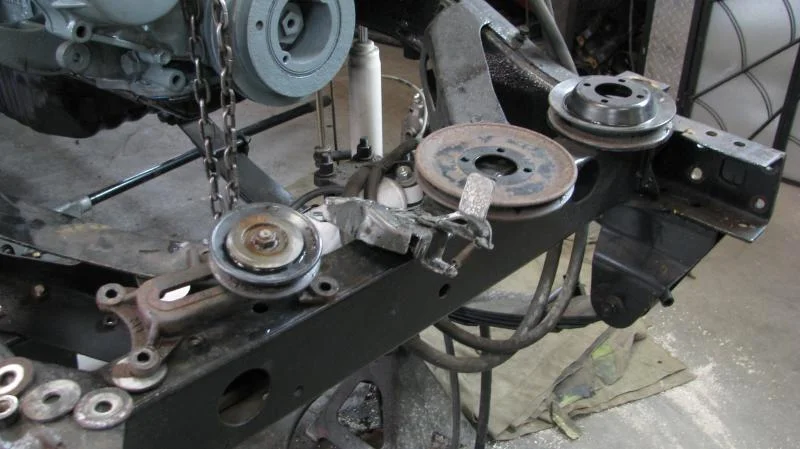

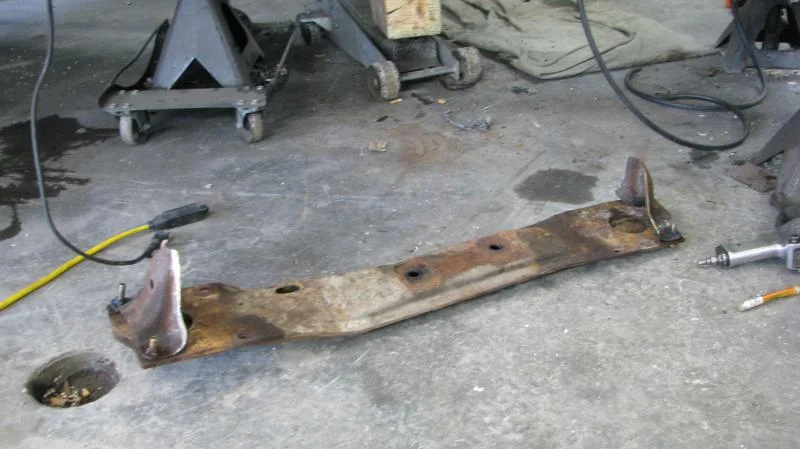

Crossmember removed and installed on its new frame,

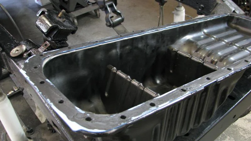

New clutch in !! Needed a speedi- sleeve for the crank, had i nice groove in it. All brake lines done also...

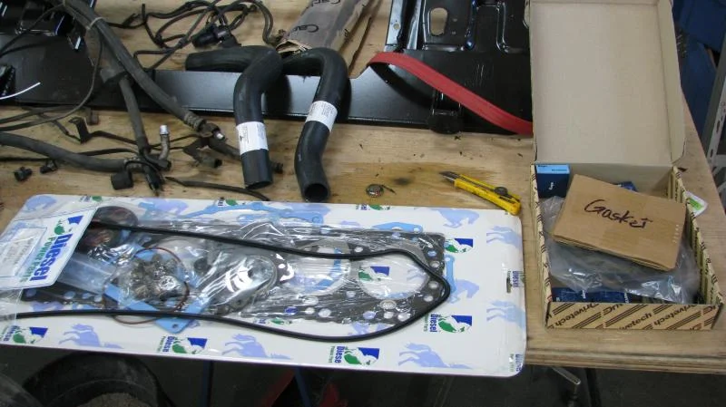

Pan gasket should be in tomorrow so engine will be back in frame !!!!
:bounce2::bounce2::bounce2::bounce2:
Good day today !! :bounce::bounce:
Parts r' comin' in. Pan and crank all sealed up, got the engine in for the last time ( i hope ) getting the small parts ready, new idler bearings,etc...

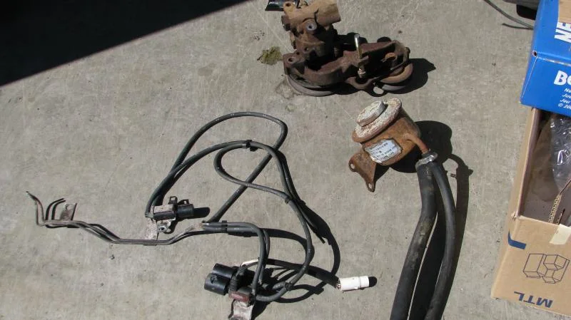

Looks good Pete. I here ya on greasy parts. Just got a box of the 60 disc brake set-up for Hamp. Will need to soak them for a bit and then I'm on the hunt for a blast cabinet....
